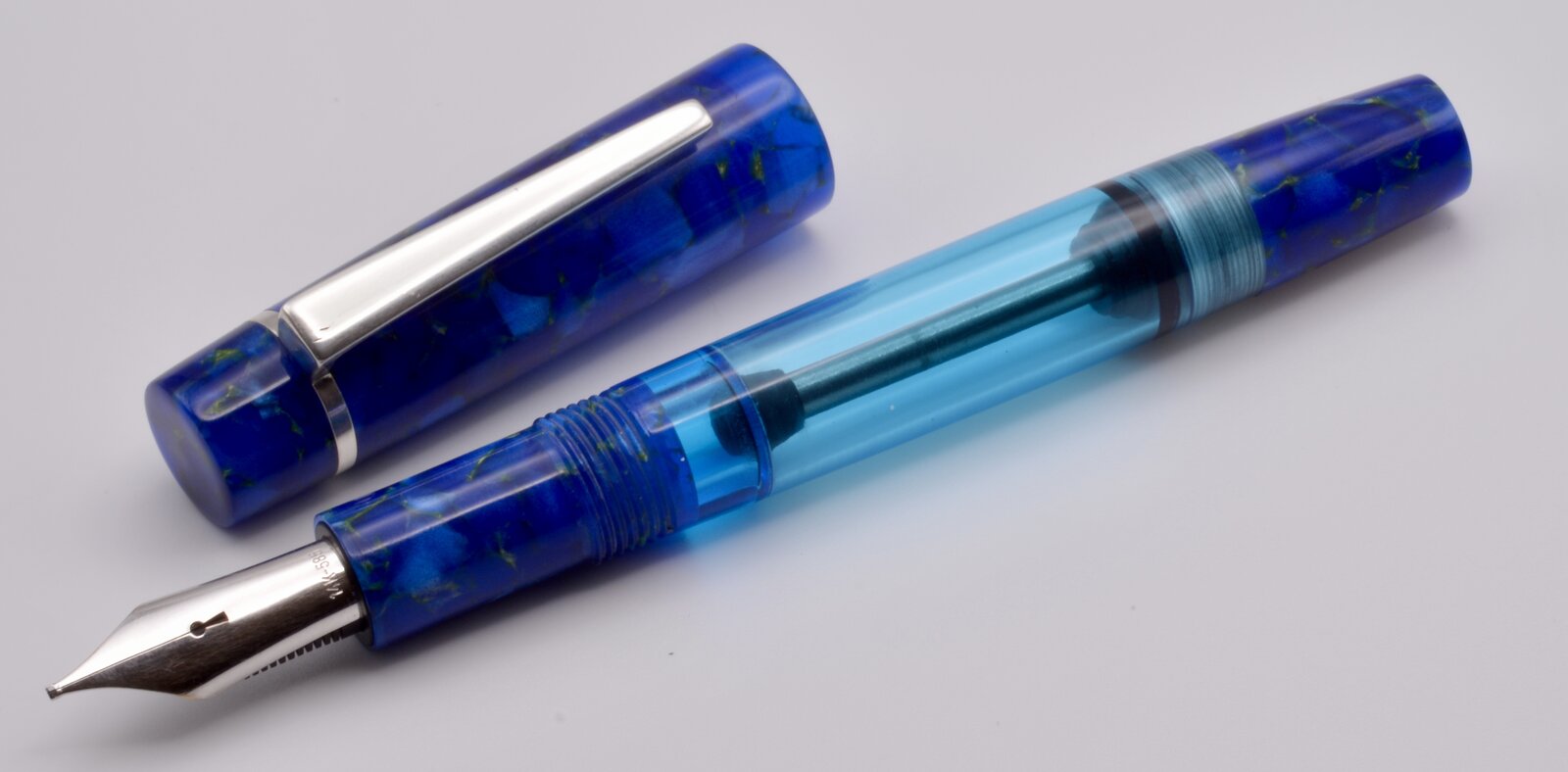

Depends mostly on the nib size, and consequently the section tenon size, for me. Also the construction of the pen plays a factor for me. If I'm doing a pen that has a piece of material threaded on to the body, as shown below, I'll try to go a little larger in diameter to give myself a bit more wiggle room.
