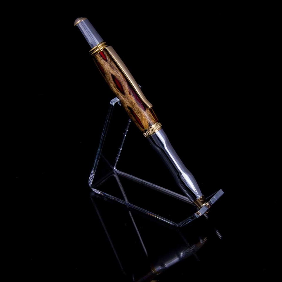

Sierra Grip w/red - the red fill continues to be my favorite. This was for a female doctor. Pretty sweet. I continue to really like how classy the Sierra Grip is whenever I do one.

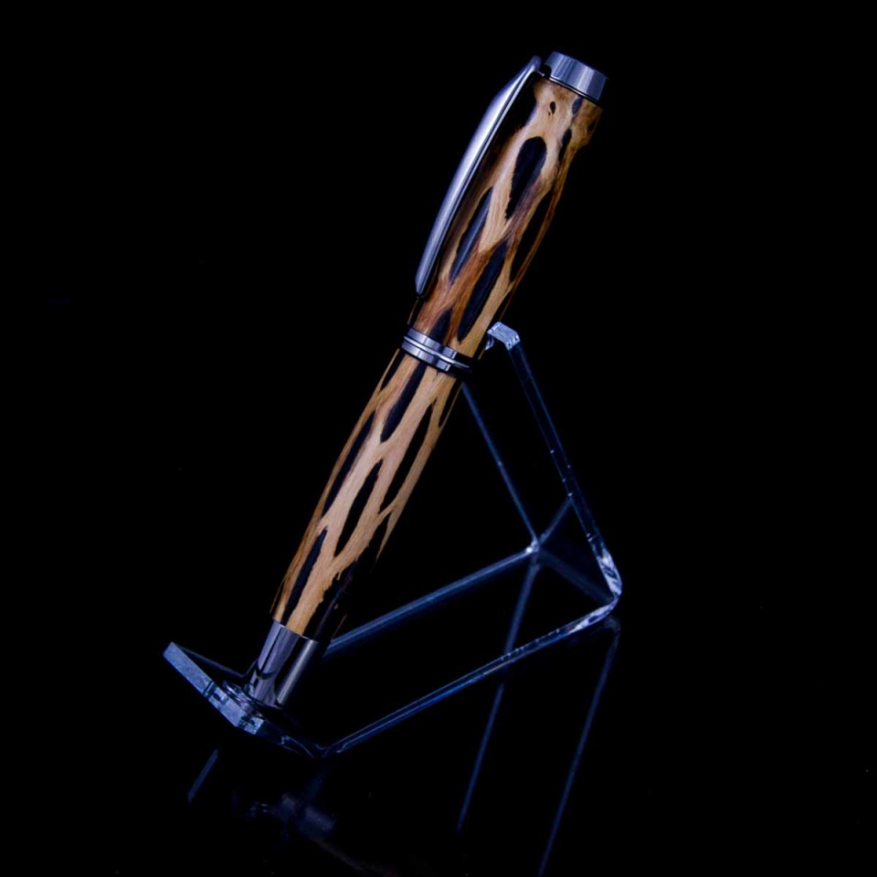

Jr. Gent w/black - this was for a female bank exec. It looks a bit nicer in person than the photo. The black invokes an animal pattern feel I think, and she wears alot of black, so I'm happy with how this turned out.

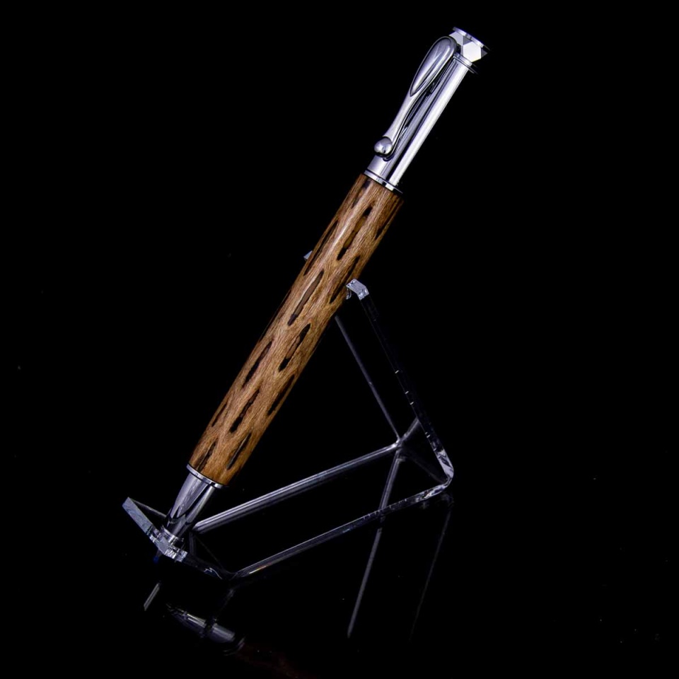

Zen w/orange - while I really like how the zen works with the cholla, the fill here turned out disappointing. It looked bright orange when I poured it, but really paled out when it turned. Still makes for an interesting pen, but a repeat I will not try. Gotta do another zen cholla with a better color.

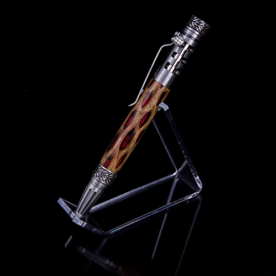

Gearshift w/red - close enough to a checkered flag to make this work, I think.

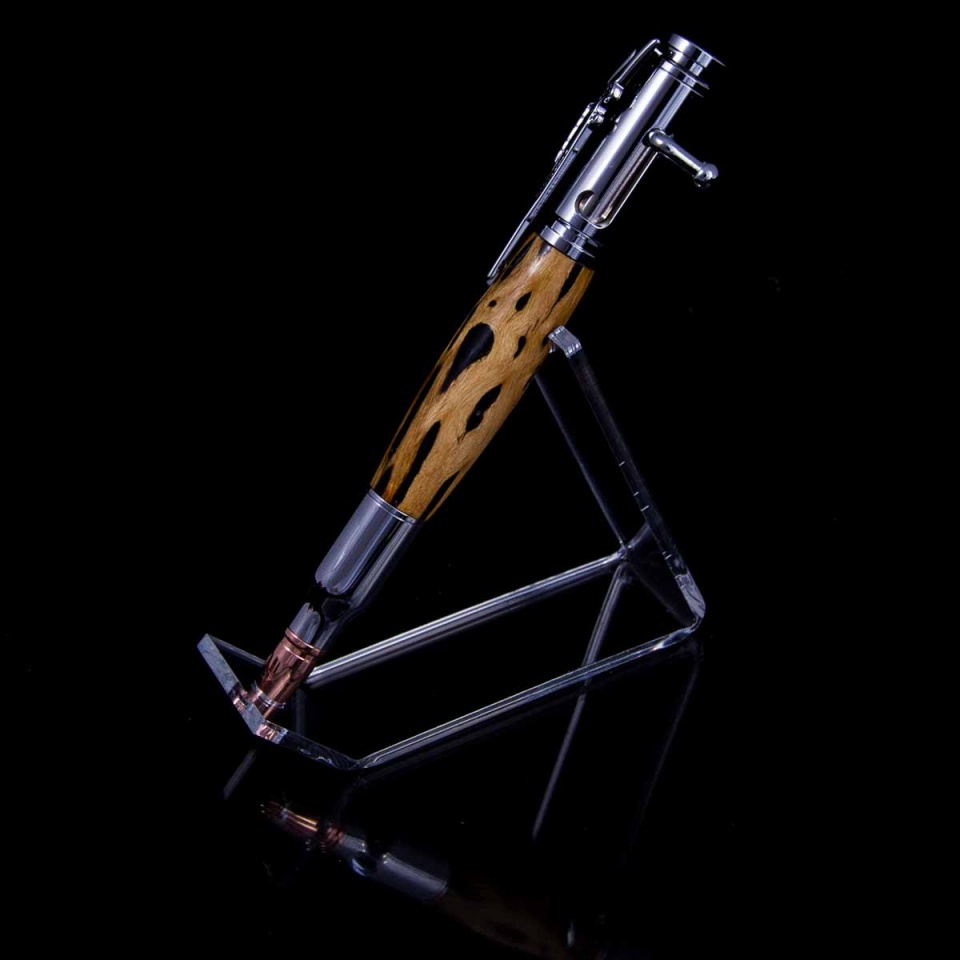

Bolt action w/black - went with black on this after seeing the "animal" feel of the Jr. Gent above, and I think it works.
