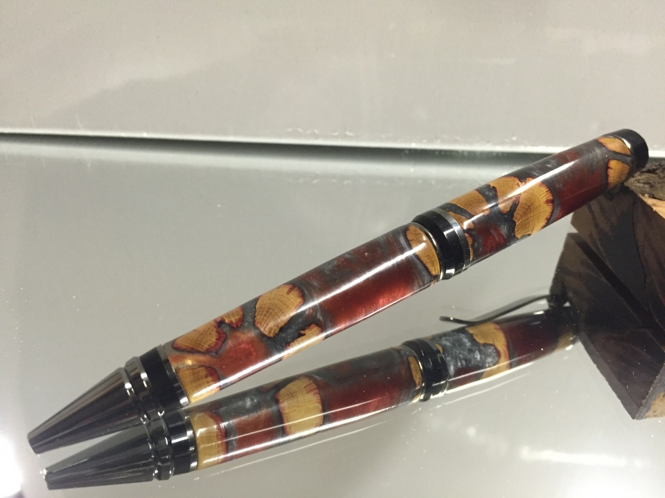

Had our son baptized this weekend and made these two pens for the Godparents. One is a garnet/silver Alumilite resin with cholla cactus pieces embedded. I sanded through 12,000 grit with Micro Mesh and then put on a 5 coat thin CA finish on top. Then resanded back through to 12,000 grit and hit it with Meguiar's PlastX polishing compound. Used a black titanium cigar pen kit.

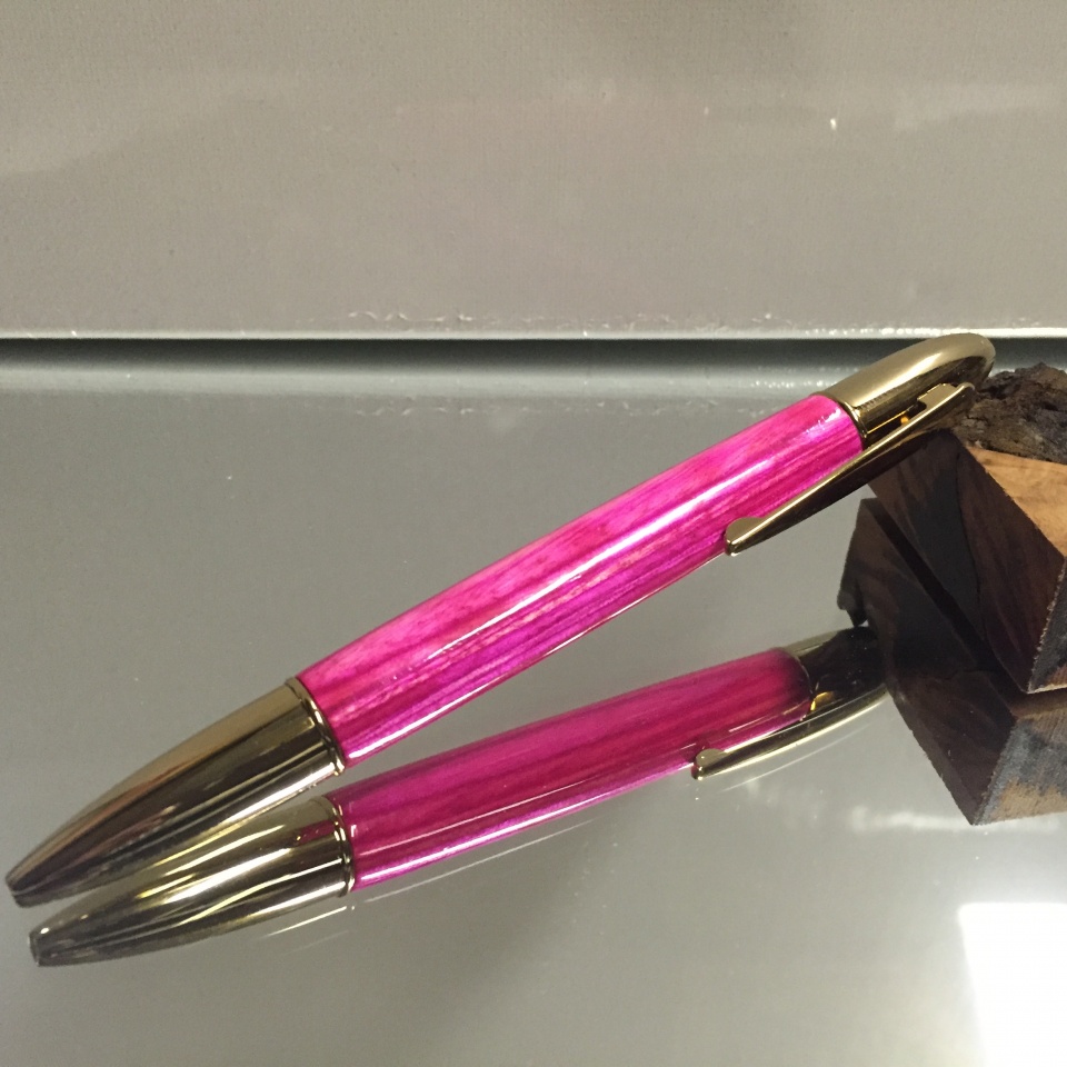

The other is a pink Spectraply blank that I picked up in Cousineau's 20 blanks for $10 blowout sale. First time using Spectraply and I was very impressed with how it turned out. 8 coat thin CA finished using the above sanding/polishing method. Used a PSI Falcon pen kit
Glorious Pens, Lee.
A Beautiful Gift for your Son's God Parents.
Love the Cholla Blank, and Impressed with the Spectraply Blank.
Excellent Fit and Fantastic Finish.
Congratulations All Round.
