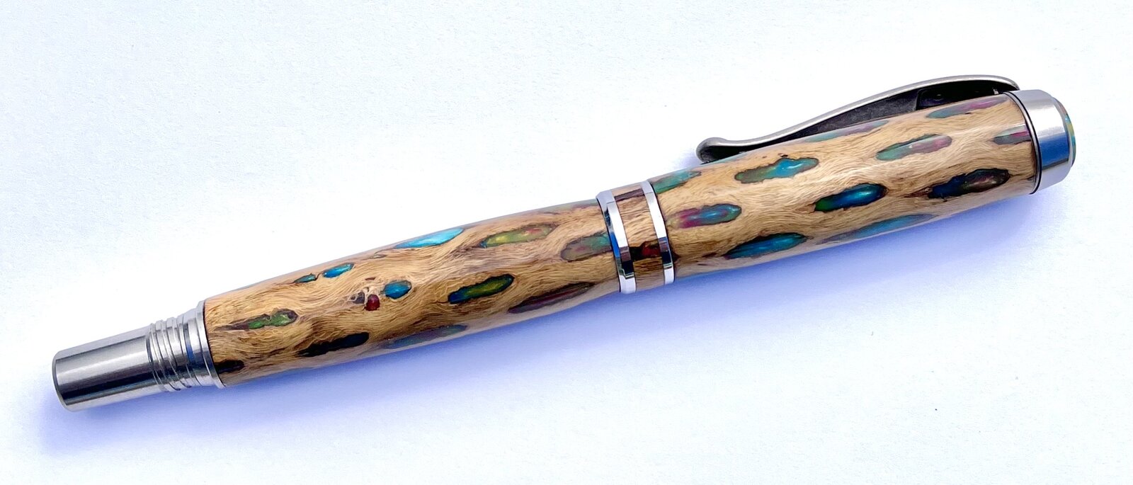

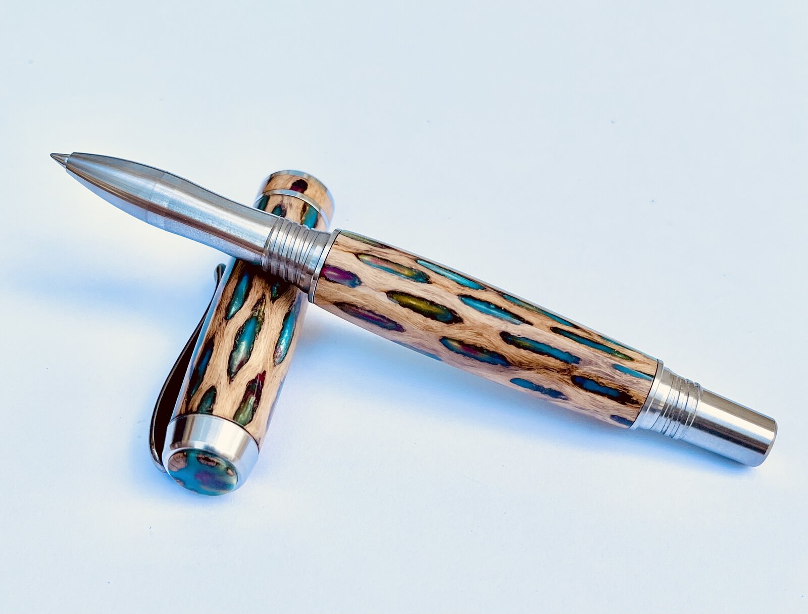

I've had this blank on my shop counter for over 2 years, tubes up and ready to turn. I finally took a little time to finish it for an upcoming demo I'm doing on custom center bands. The parts are the new stainless steel Band-It from Exoticblanks and the blank was a custom cast I kept out of a group I made with the intent to make me a rollerball. I like the end results… the pictures, not as much.
Thanks for looking!

Once again John you never cease to amaze me. That is a sharp looking pen. The only problem I have is your starting to use up some of my ideas. The kits are ordered so once they get here I can start playing around. Thanks Ed for spending the time and money for a kit that really caters to pen turners that are looking to customize their pens. Thank you John for spending time and sharing your techniques to help us get started.
Thanks Ed, I agree, the cholla on the cap really gave it more depth.
Thanks Kenny, I've really enjoyed making all of them. I just cast some dried flowers I picked last year so I'll probably try one of them out on there next. Lol
Wow. That's just gorgeous. Knowing the depth that just doesn't come through in the pictures, I can only imagine how fantastic it is. Looking forward to the video. - Dave
That is really sweet. The bandit pen, with the open center band, such a simple concept but opens up so many possibilities. I love it.
Thanks for all the comments and likes. I wasn't sure if the multi colored cast would look as nice as the solid red, blue or black cholla I cast, but I like it.
I didn't shoot a video on this one but I used the same process on it as I did in the color cast Band-It video. It's very easy to do.

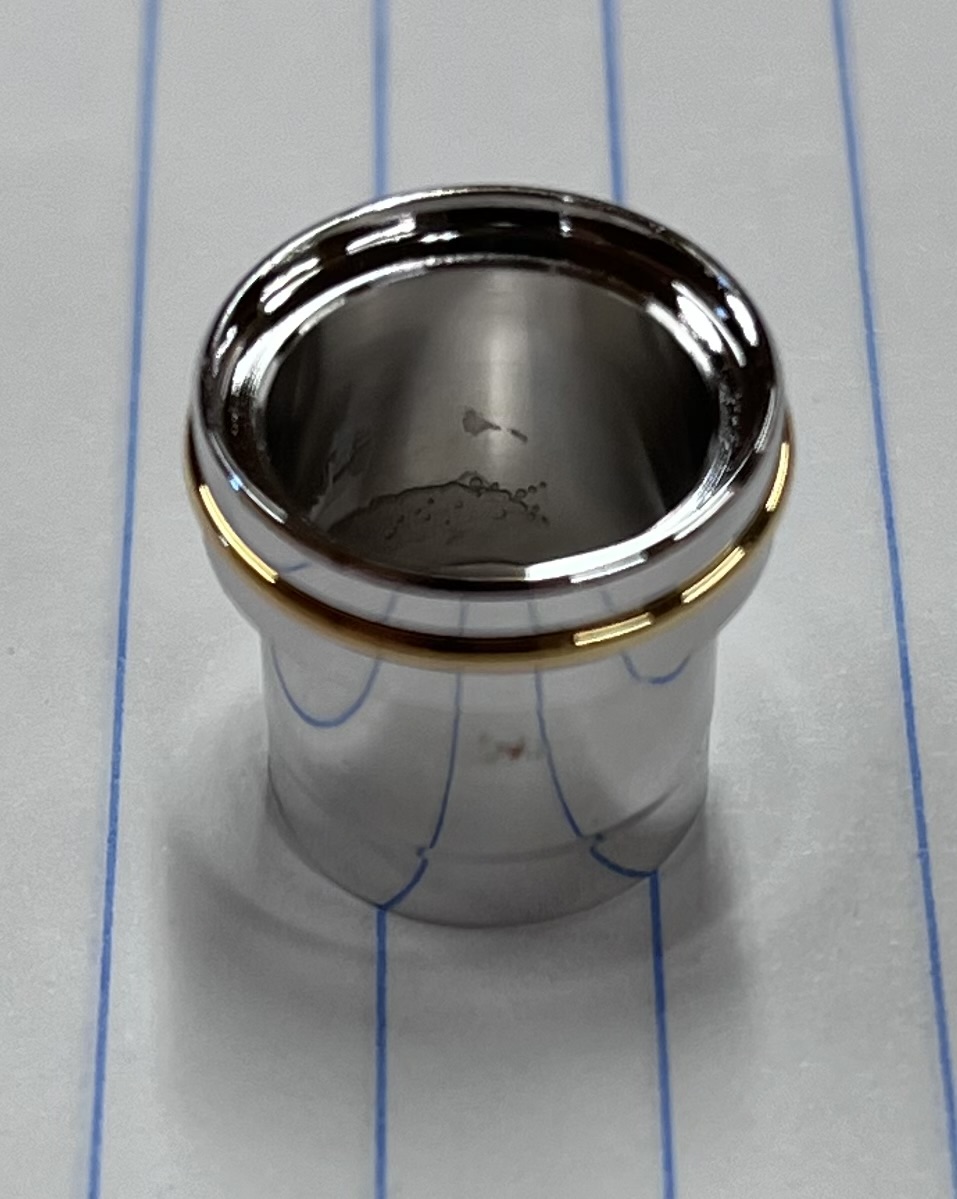

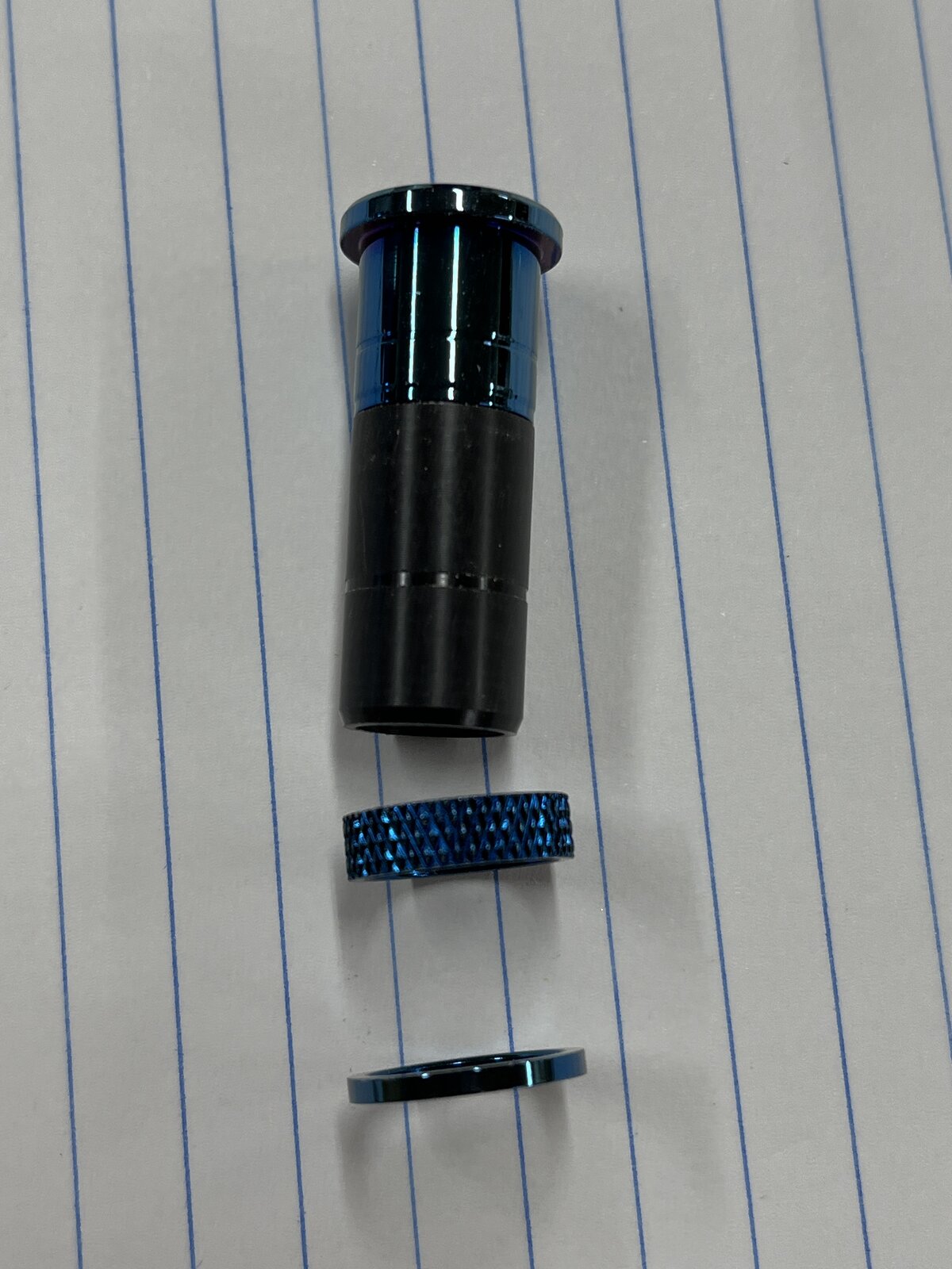

Can you share any tips or tricks on how to press the Diamond Knurl center band apart without damaging the plating? I've watched an old YouTube by Lynn Lacey (2016) on making custom center bands, but the center band assembly he had just slipped right apart. The Diamond Knurls I have feel like the center band is pressed together really tightly and are not likely to come apart without some kind of fixture or something. - Dave

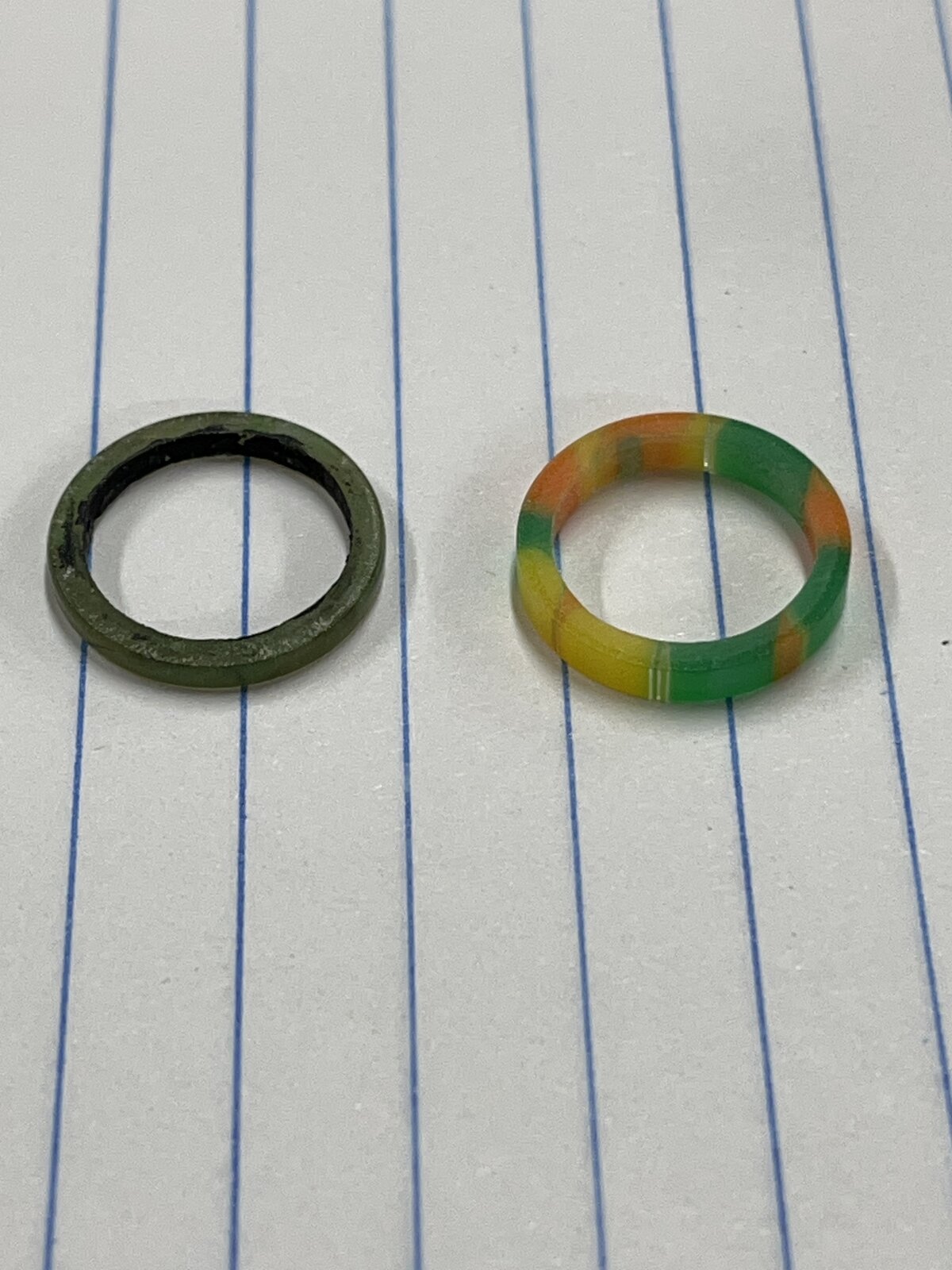

The Diamond Knurl Rollerballs I have just slide apart, but the Jr's are pressed tightly together. To disassemble them I place them upside down. Then I drill a hole in a piece of corion that just slips over the chrom edge and rests on the thin gold center band. Then I tap the corion down the band, moving the gold center band and lower chrome ring done the center of the assembly. It will slide off easily after you tap it down the assembly. After I make the new ring, I slip it all back on and press it gently together as I assemble the pen. Just make sure your custom center piece is a little loose or it could crack.
Thanks John. - Dave
