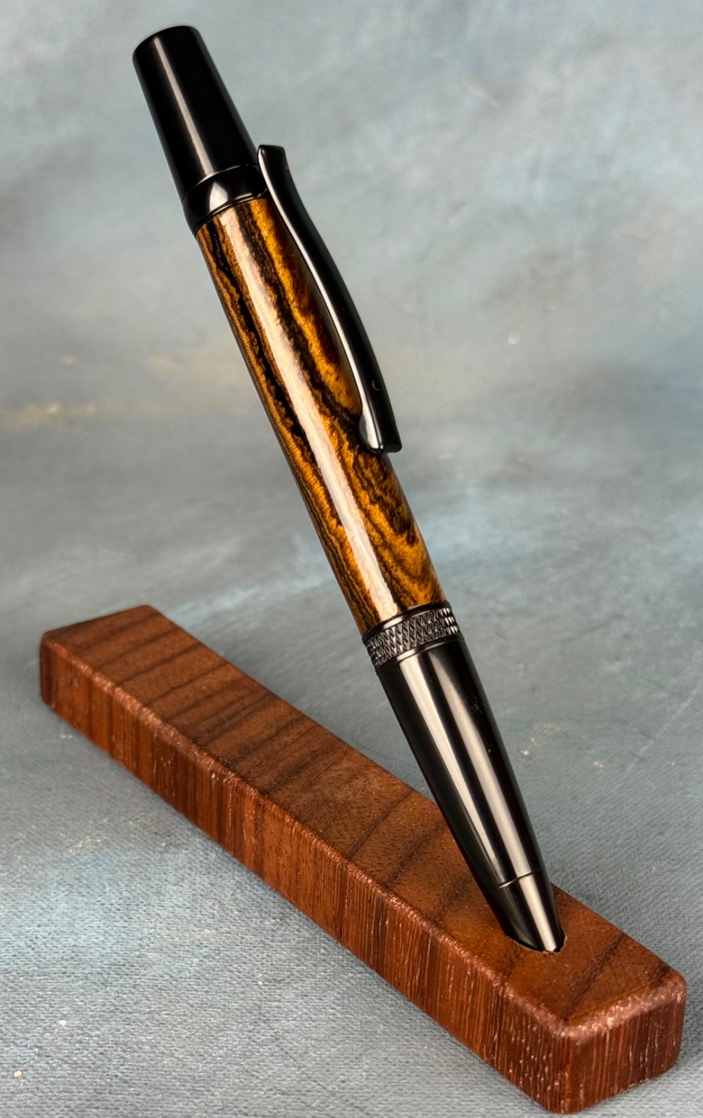

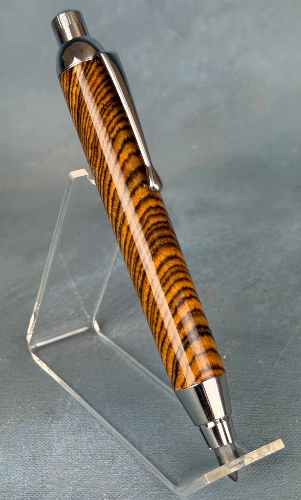

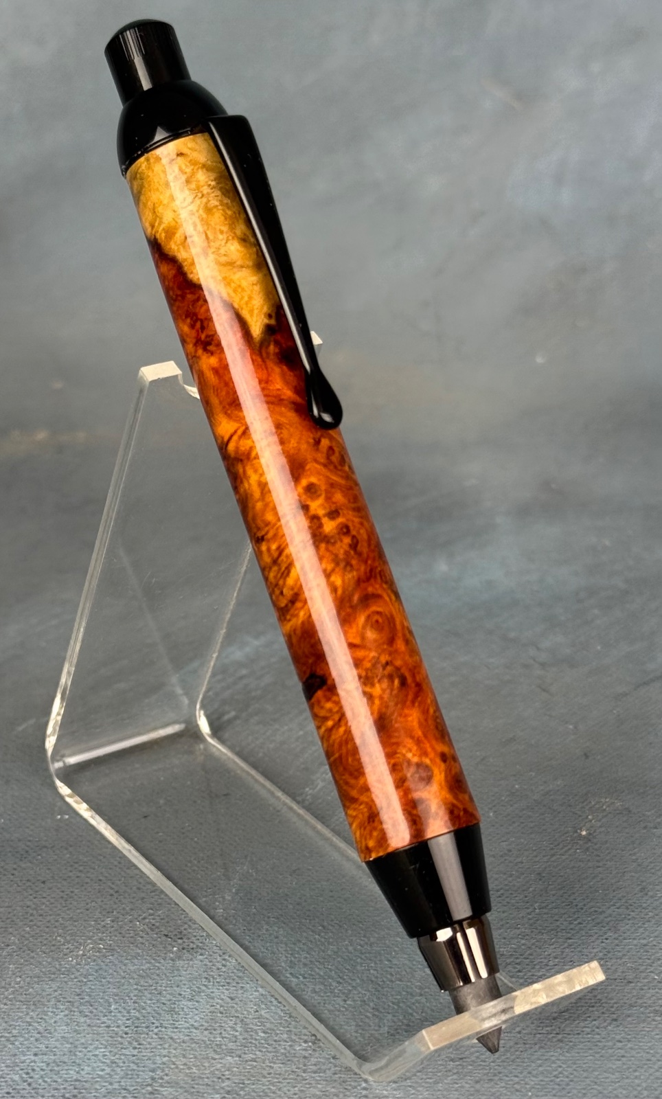

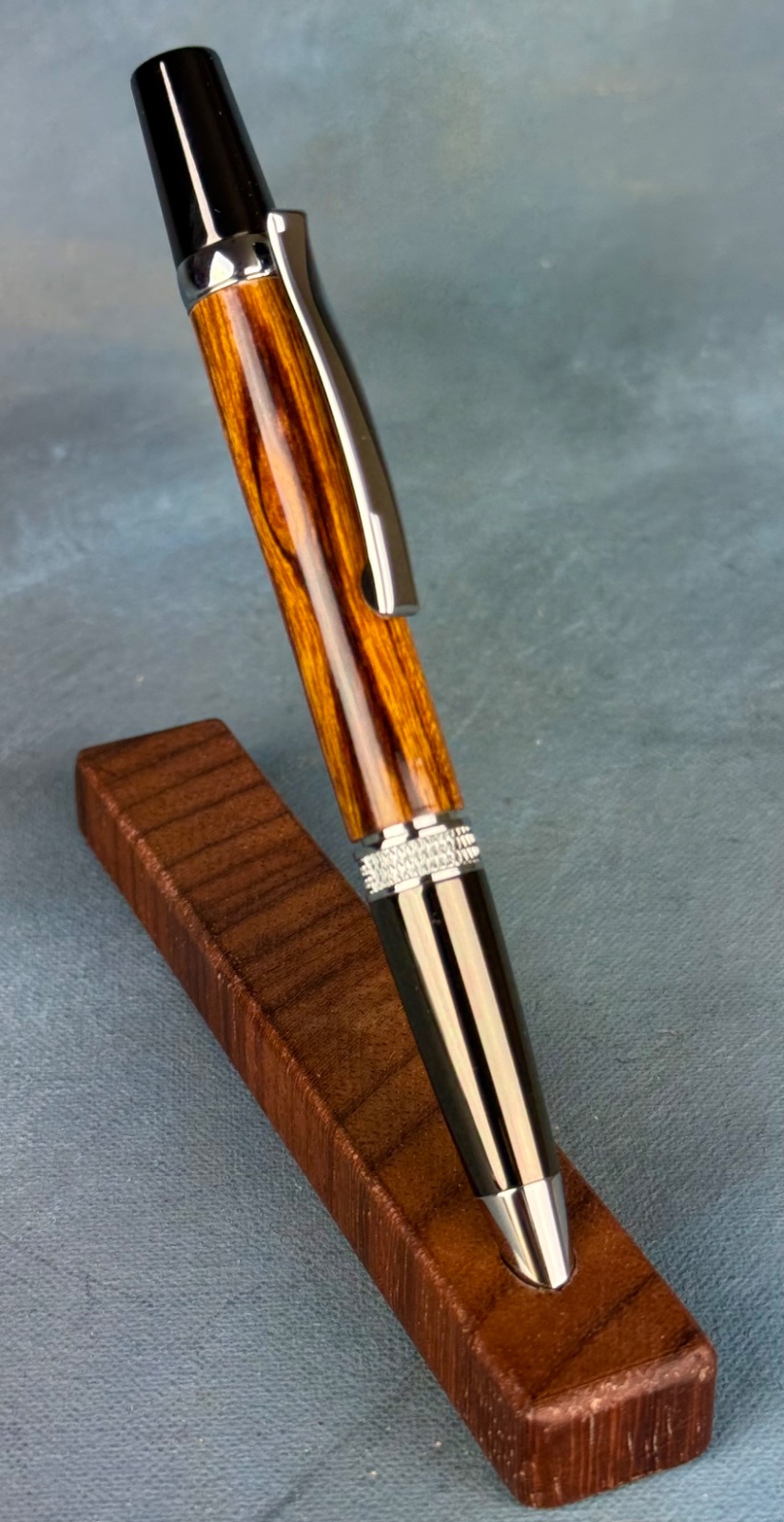

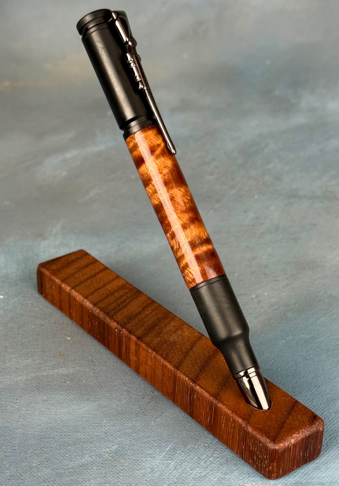

I am very satisfied with this method and THESE PRODUCTS. If you play with other glues or acceleration good luck.
Use Scott blue towels cut in 16th size pieces
EZ Bond thin 5 cps - 4 coats with a lathe spinning slowly (500 rpm)
Light spray with STICKFAST spray accelerator
EZ Bond thin 50 cps then a light spray of accelerator
Repeat 11 more times
I reverse every four applications
This should take less than 5 minutes
Sand with 400 grit
Buff on the Beale buff
I've tried I believe five glues and four accelerator combos. This works!
