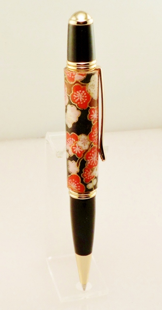

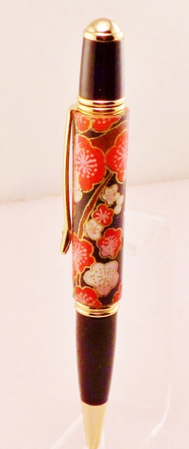

Bill; I have made quite a few Chiyogami-Yuzen style pens. This is the way I do it. Go to "the paper store " website and look under Japenese papers for a wide selection of designs. You can order sample sizes for $1.25 each and, depending on the pattern, you can make 2-4 pen blanks with each. If you cast your own blanks just cut out the pattern and glue directly to the tube, than cast over the design. If you don't want a straight seam on your pen, buy a scrapbooking sizzers that cuts wavy or odd shaped edges. If you don't cast yet, cut out your design so it is just a little smaller than your fittings are round. Now turn any piece of scrap wood about 10/1000s under this size. Apply your paper to the blank with Modge Podge so it seals both the wood and the paper. Finish with CA to the size of your fittings. I have also done this with Polymar Clay. Make your blank, bake, turn, and cover with paper, or cut out designs to apply to the clay. Finish with CA. Here is a photo of one I have done. Jim S
