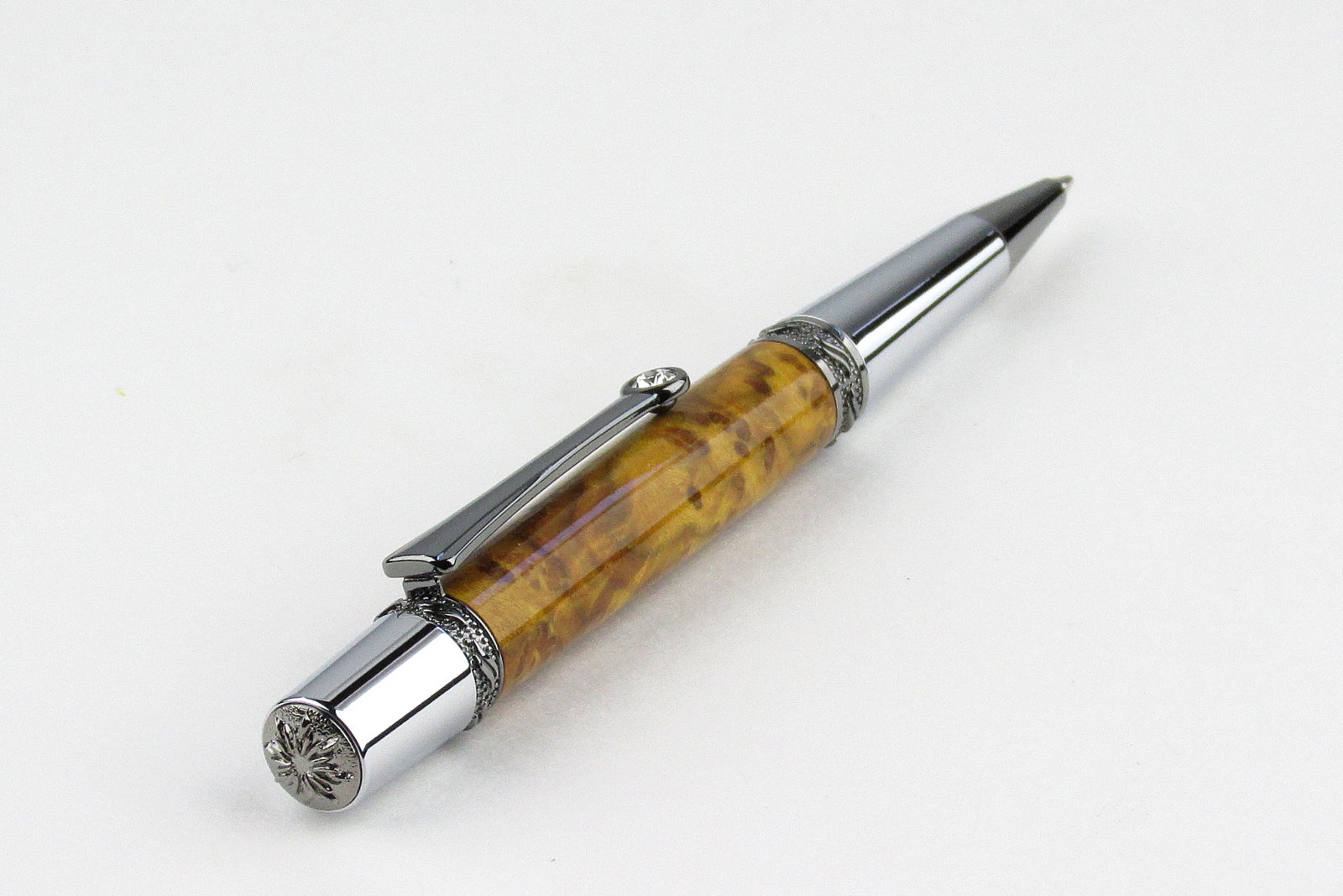

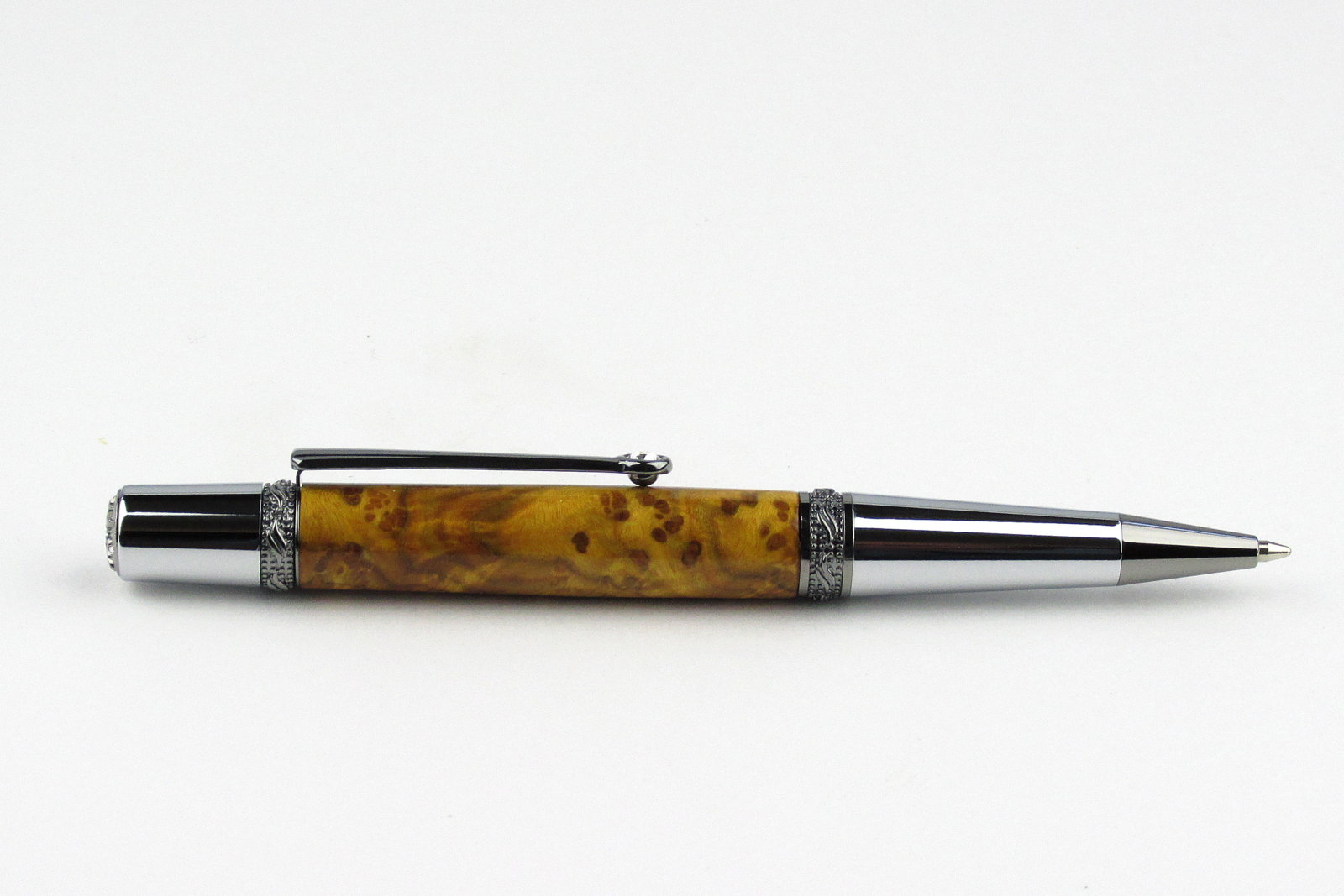

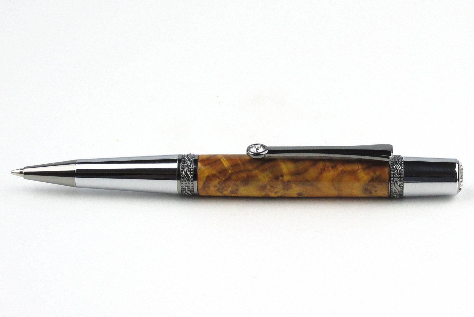

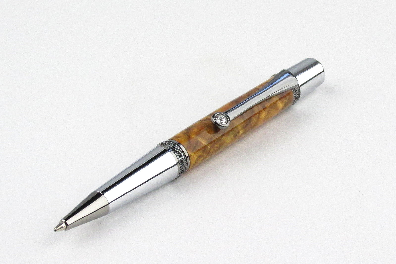

This is the "Major" kit available from Exotic Blanks, in the Black Titanium/Chrome plating. Uses the same tube and bushings as the Sierra kit. The center band and finial detailing is superb, as well as the design on the top of the finial. The relief is deep and clean on these accents. The clip is easily lifted to slide over a shirt pocket (unlike the Majestic Squire, which is impossibly stiff). The Swarovski crystal on the end of the clip is a classy addition.
The Chittum burl was finished with CA using a modified Fangar Method.
This kit is very reasonably priced, when considering the options in the Sierra variations. The kit is from Dayacom, and has top quality components.
