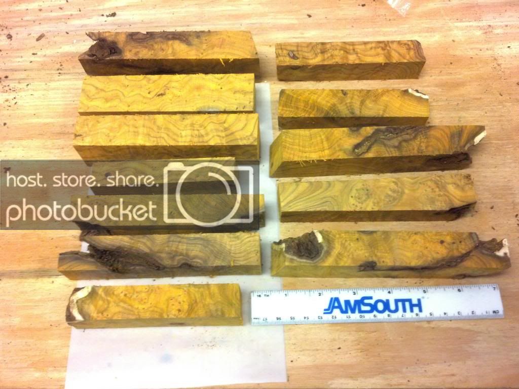

I am from North Alabama, and have dumbed into the Chittum Burl mecca. I have been roughing out some pen blanks, but was wondering how long will it take for a 3/4" square x 5-7" blank to dry enough to turn. This stuff is beautiful. I also have some duck call and turkey call blanks cut and drying. Thanks.

If you have a postal scale (about $20 at Harbor Freight), you could weigh them periodically. When the weight stabilizes they have reached the point you can turn them.

Simple solution! Send me a couple of them. I will let you know when they are turnable! :) Those are some nice looking blanks!

Thanks for all of the insight guys! Great ideas that I have never thought of. I turn primarily duck/turkey calls but thought the pens would be fun also. As for the Chittum Burl....got it locally, you wouldn't believe how much of it is actually in the woods when you start looking for it. They say it only grows here and the burling has something to do with the limestone rocks all over the place. I currently have three large stumps with burls on them in my yard as we speak. Once I figure out how much I have and how much more I can get, I would be more than happy to trade/sell a few blanks.

Just tried the micrwave drying, worked like a charm. I finished cutting up my first stump burl yesterday, and started cutting blanks on the bandsaw. I expect to have about 30-40 blanks, some I'll be trading, some I'm definitely keeping, and some will go up for sale. Those who have IM'd me, I got ya in order of the IM's for preference. The biggest burl stump I have is about half the size of a 30 gallon garbage can. I expect 100 blanks easily out of it, now that I know how much I got out of this last small stump. Stay tuned!
