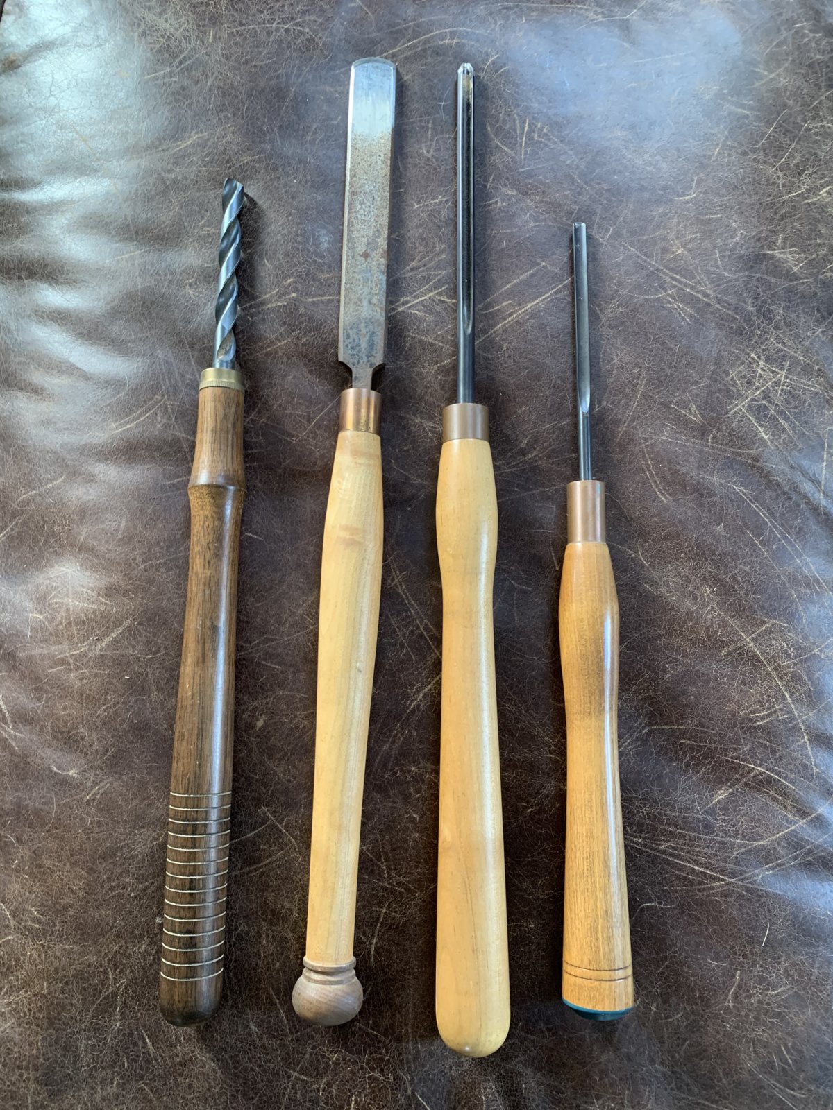

I'm super pleased with a recent Ebay purchase of some turning tools, attached. I really just wanted the larger gauge, but the whole lot was just $25, and I'm glad to have it all. It's from a turner who passed away. He made his own handles, which I think are gorgeous, and kept the tools really nice shape. His presence will be felt as I use these guys. He was clearly a better turner than I am, and I'm hoping I'll have his spirit on my shoulder as I find my way.
These long-handled tools are a new size for my shop, and I am interested in seeing how you all store your chisels. I asked a related question once before, generally about shop organization, and it yielded some good exchanges of ideas. Here's that thread:
Specifically, now: what good ideas do you have for storing your chisels? As usual, photos are appreciated.

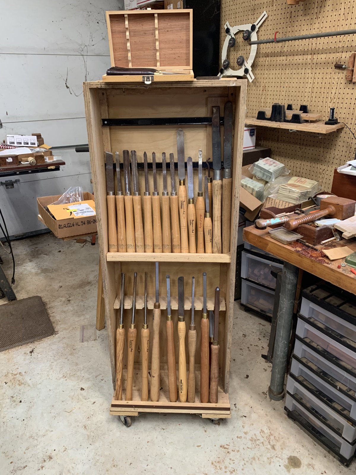

Here's what I use - I found the basic box (back, top, & sides) by the dumpster of a cabinet shop a few years ago and thought it might work for tool storage. I added a base with casters, the shelves, cleats, & magnetic strips.
I have two lathes, so I can position it next to whichever one I'm using or roll it out of the way when I don't need it.
It's about 56" tall (with casters), 6" deep, and 21" wide. If I were building it from scratch, I would have made it a little wider, but this works fine for me for now.

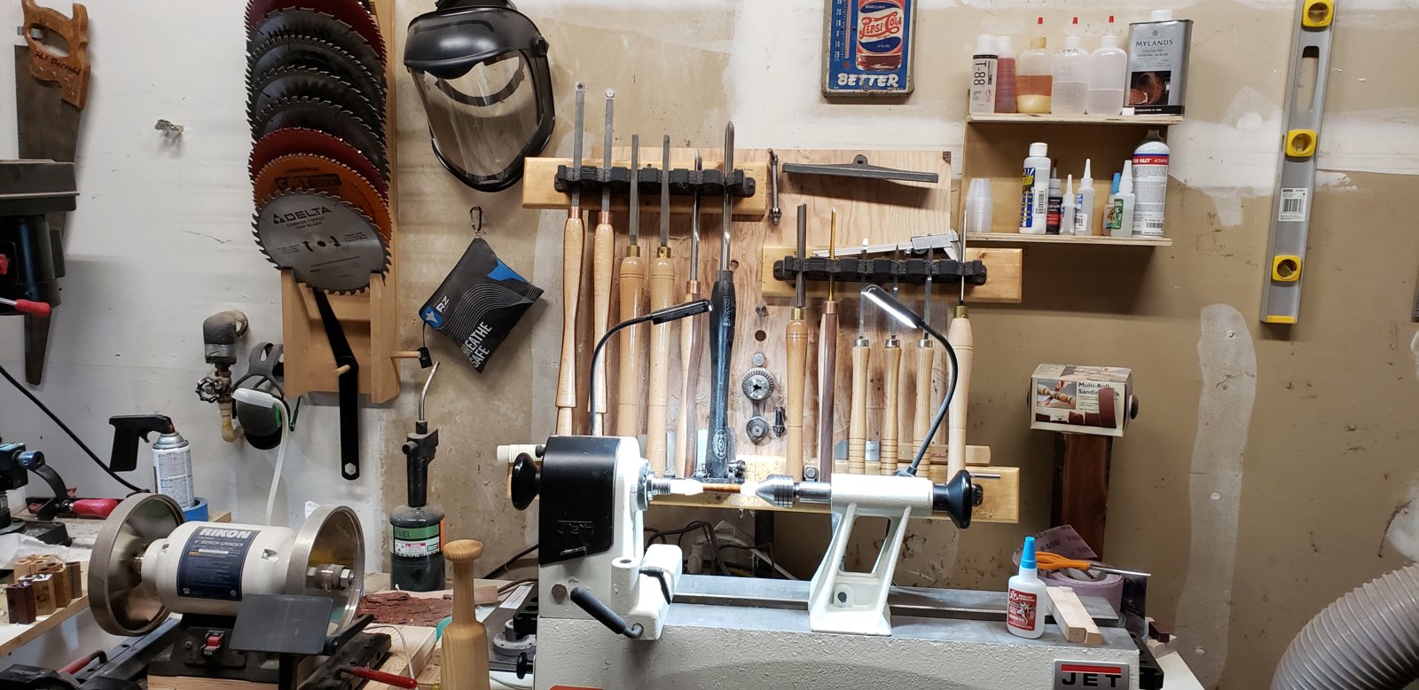

Here is what I built. The brackets for the chisels are Berkeley rod holders that I had extra. The board is mounted on a dual monitor display stand that I got for free. I like it because I can move it around as needed. Although I will be moving it to the left end of the bench. I don't like reaching over my work to grab a chisel. Granted, I don't have the lathe running when I do reach over but I still don't like it.

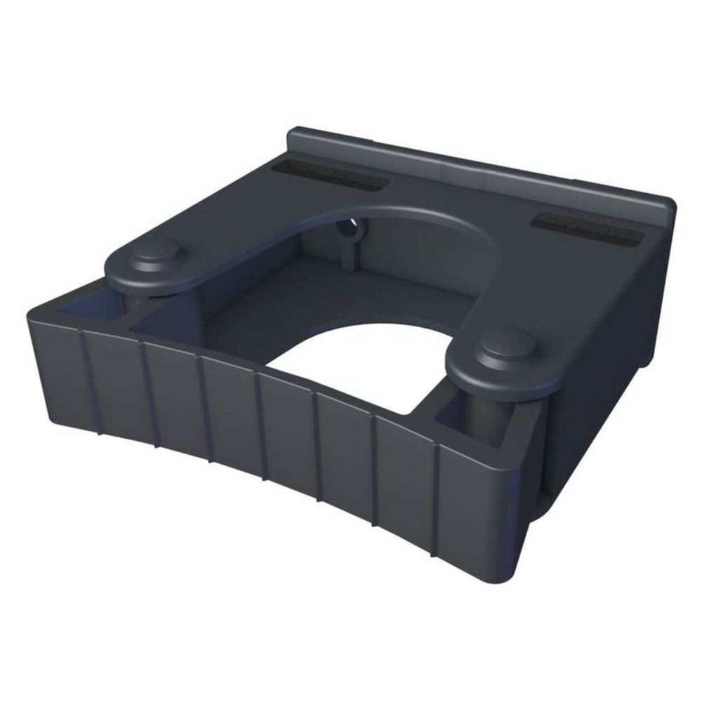

I bought a few fishing pole holders with the rubber/stryo in the grooves. I have about 3 installed and another 2 or 3 still in the box. However, I seem to "like" storing them under whatever lathe I am using. The hunt of finding the right chisel is part of the thrill. Seriously. I like this fishing pole holders.
I also had the bright idea of making these nice holes in my lathes stands. It was a great idea until I dropped something, bent down and hit my head on the points..I don't do that any more. I also bought a lathe bed attachment that looks real nice, but the chisels don't stay in the slots.
Something like these, but Walmart sold the for about $6

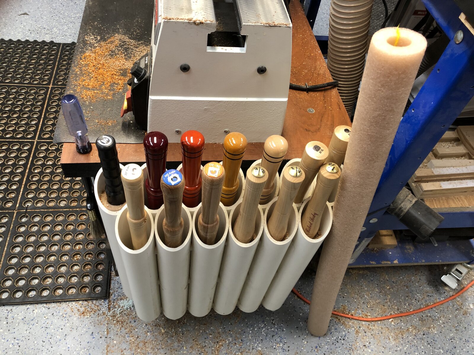

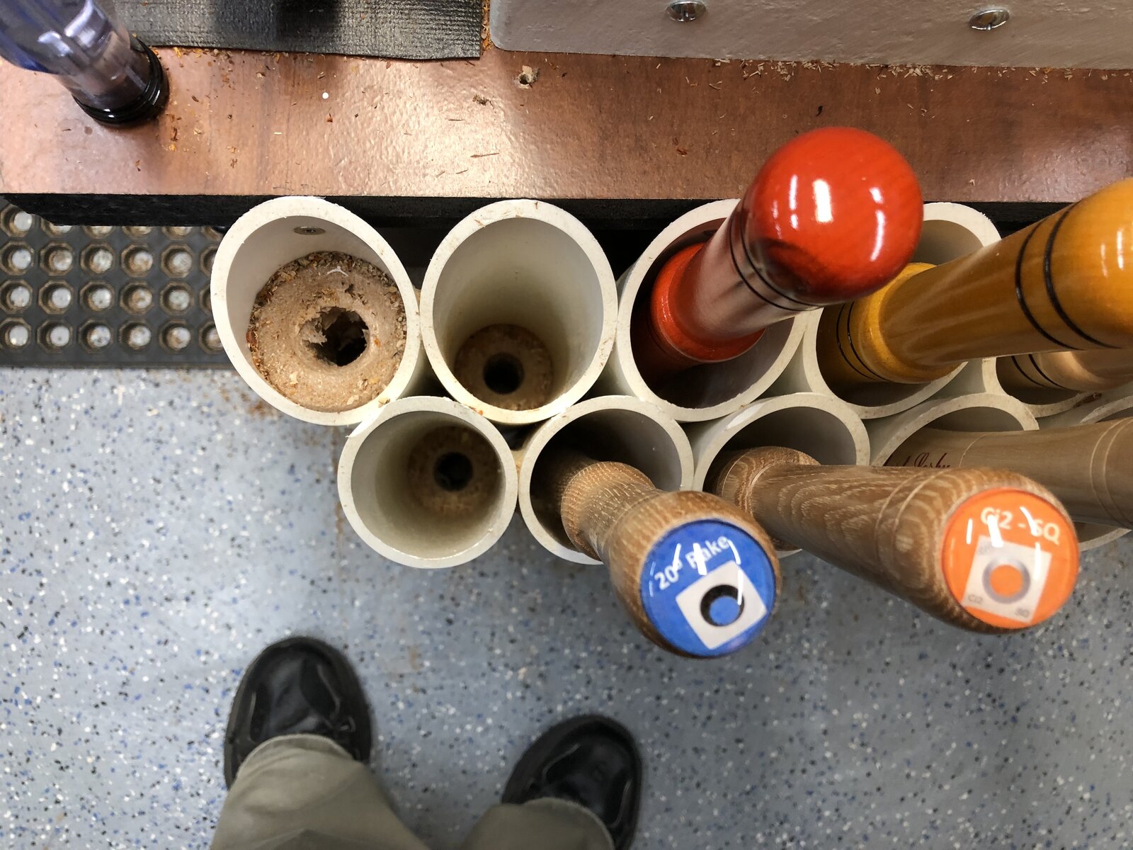

Greetings - I constructed a tool holder that is attached to one side of my lathe table. I used 2-inch PVC Pipe with a plug on the bottom. I cut the tops on a bias for aesthetics I guess. Using the foam insulating "tubes" intended to keep water lines from sweating or hot water lines from loosing heat too quickly, I fashioned inner tubes cut to the right length as to keep the handles of my tools at the right height when they are dropped into the tubes. I essentially glued them together to make them into a single chunk and the whole thing is screwed to my lathe table. So far it has been working quite well for me.

I like this idea. Very clever.

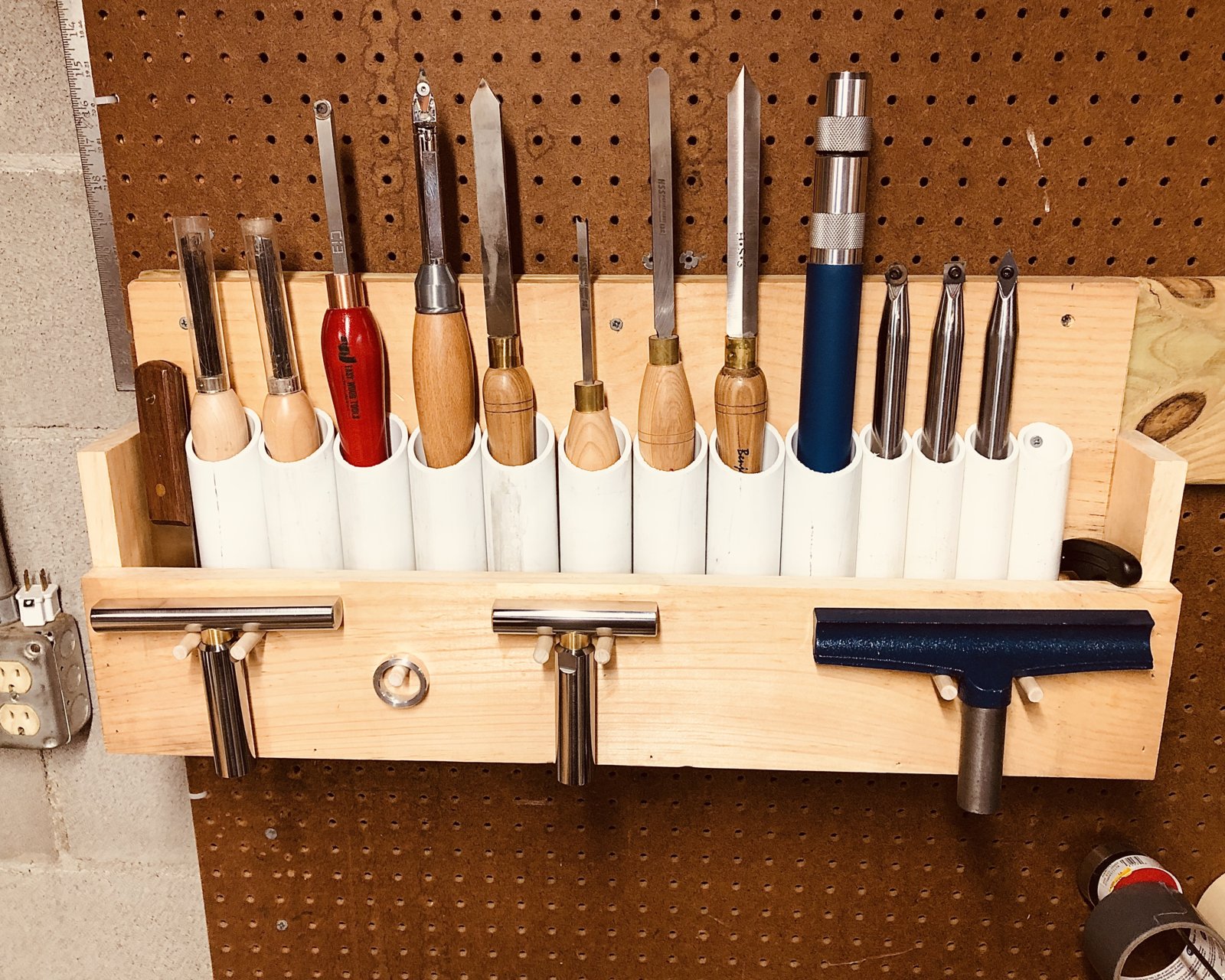

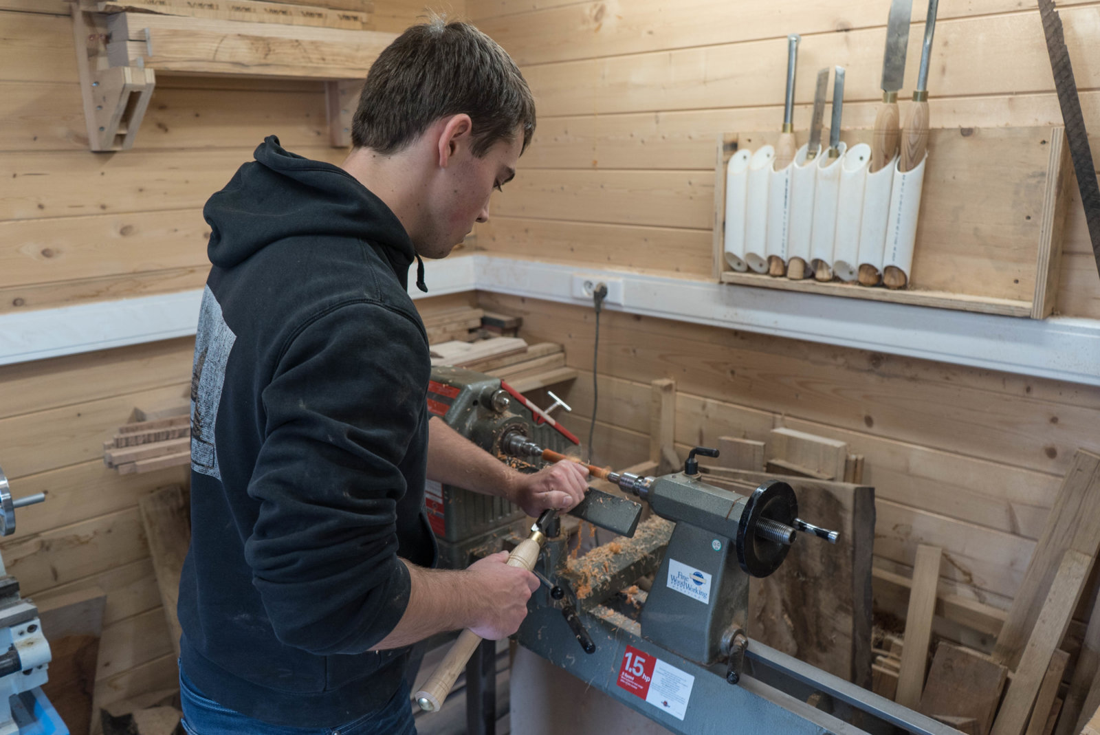

I have made a couple of years ago this very easy rack.
It's maybe not the prettiest,but works like a dream!
Just bought a 3 meter Pvc pipe and cut both sides to 45 degrees so it's easy to take the chisels out.
Found the idea/design on Pinterest if I'm not mistaken
.View attachment 234658
Simple and effective. I may have to re-think my setup for tools. I just have so many :)
