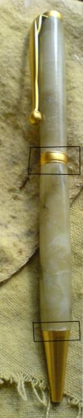

I can cut, drill and mount the stone very easily, but it keeps cracking at the ends. Is this due to pressure being applied by the mandrel? If so, how can I combat this? I have been advised that I should wet the stone, see if the water seeps in anywhere then coat with CA glue. But I am not convinced that CA would hold.
I had managed to get 1 pen turned and put together (attached photo) but noticed after the ends of the stone had chipped. I imagine this is from the pressure of putting together? Again, same question: any way to combat this?
I love the effect the stone brings, and am determind to figure this out, but any helpful advice more than welcome..

Philip Townsend has very successfully made soapstone pens before and I'm lucky to have one of them. Perhaps the issue is with the stretching of the tube when you press the parts in rather than from the mandrel. I would have thought that CA would stabilize the ends a bit though, but Phil is the guy to ask.

I have messed with soap stone some, and thin CA glue has very low viscosity and surface tension and will run and penetrate where water will not go easily. That may make it your best tool.
Woods and acrylics are much more flexible and handle distortions from the mandrels and the fittings with elasticity. Soap stone has almost no elasticity (for practical purposes none). Plan to set any fittings with a fitting compound such as loctite medium after releiving the tubes to allow a snug but loose fit.
The epoxy I have seen used in rock grouting (foundation anchors) is not clear and would change the patterns and colors of the soapstone, but I have only seen a few.
Have done some turnings where I needed to run a mandrel into the object and fastened it for shear with several layers of masking tape - you may want to do somthing similar instead of pressure on the end, or have the tubes over long and trim after turning (compression only on the brass tube and not on the stone).
Neat pen -- and nice effort to push the envelope further.
(plain ca finish may be appropriate too -- though the feel of soapstone is special).

Looks like the mandrel pressure is too much.
It also looks like you're using artistic soapstone, and I doubt you'd have much luck
in making a pen that would be usable. (but boy, it looks great!)

Hi Andy, Although I've done Lapidary work for over 30 years I'v never worked with Soapstone, but I tend to agree with Ken V, when you are pressing the hardware in it expands the tubes slightly and since there is no room for expansion that could be your problem,also looking at the chips in the center band area also makes me think you may be tightening the mandrel a bit too much. I do agree, it makes a very nice looking pen, welcome aboard.

I have been giving some thought to the dilema, and must agree that when the kits is put together, the lack of elasticity is probably my main issue. I did have the idea of maybe drilling 2mm at each end of the blank slightly bigger to allow for this, but, again I have no idea if it would work.
I had a go at cutting the soapstone blank a little shorter, and adding a piece of "neutral" wood to each end. It did work, to a degree. But I found the wood was too "small" and snapped in 2. Although, that could have been my tooling.

Andy; Welcome. Corian has the same non-elasticity issue as many stone materials. I expand the ends of the tub with a transfer punch until the fittings are a slip fit in the tube. drill the tube and glue with Polyurethane glue (Gorilla glue). It expands during the during process and may provide some give between the tube and material. After making the tubes, glue the fittings in with a little dab of medium CA. Put a small drop into the inside of the tube, and insert the fitting with a twisting motion.
