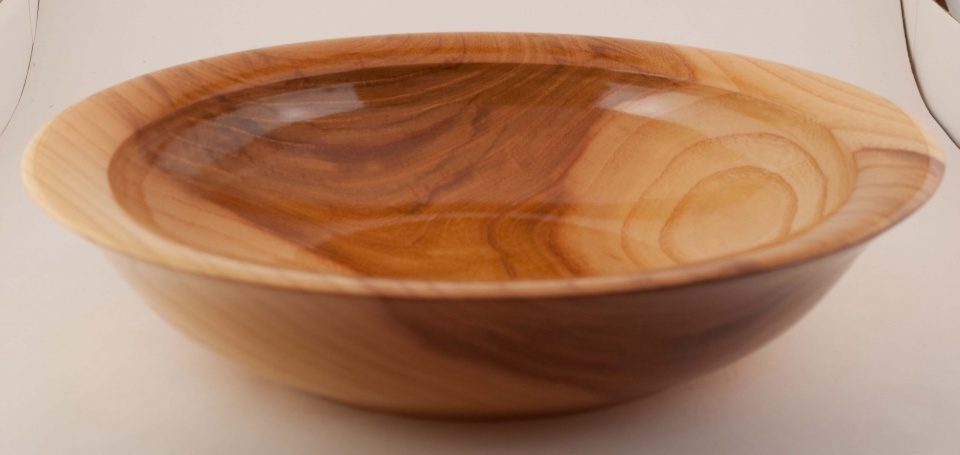

Chinese Elm Bowl. Around 9" (22cm) across, finished with Bush Oil and Polyurethane. Rough turned in Santa Ynez while on vacation and final turned back home once dry.

Looks great. I'm curious how do you apply the poly finish? Do you do that while it's still on the lathe. If so is the lathe on?
Thanks Derek, I do apply the poly on the lathe. I had applied the penetrating oil before heading out on a 3 week business trip so it was well cured by the time I got back. I gave it a good scrub with mineral spirits then applied the wipe on poly with the piece held in a vacuum chuck at low speed.
Thanks,
Pitoon - the dry time was a few hours per coat, I typically put on one coat before work, and one when I got home every day. I tended to alternate sides each time so that I was vacuum chucking it on a cured face.
