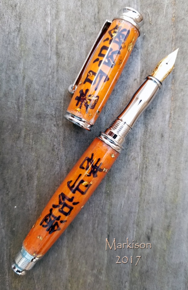

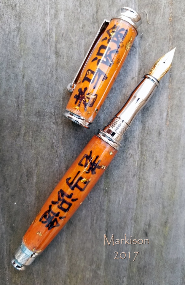

My dear Chinese calligrapher friends have put me through the paces (strokes), and this encouraged me to make some proverb pens on some of my handmade papers. Here's my first:
"An Old Horse Knows the Way" may date back to the time of ancient Chinese civil wars when a struggling army used old horses to find their way out of trouble; ergo experience matters.

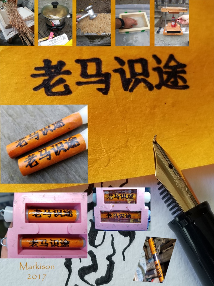

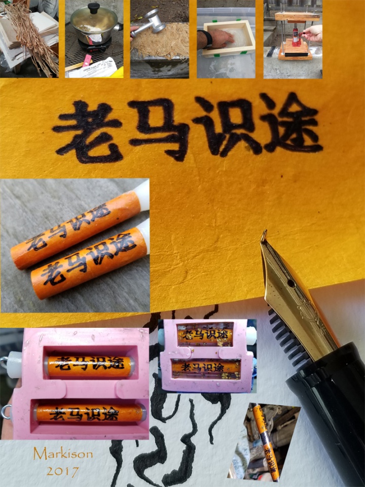

I used standard paper making techniques with 70% Abaca fiber from the Philippines, and 30% Kozo fiber from Thailand; washed thoroughly, simmered X 2 hours at a pH of 10-11 (soda ash used to alkalinize the water); rinsed well; beaten to a pulp with meat hammers; brought into a pulpy solution with a tiny bit of added sizing (alkyl ketene dimer) to make the paper slightly more hydrophobic, blending done with a heavy duty blender; pulp solution dyed with Jacquard dyes (little picture inset below was a plain sheet with no added dye); paper sheets formed with home-made mold and deckle; sheets pressed between blotter papers in a home-made 2 ton bottle jack press x 2 days, then air dried; lightly airbrushed with Createx Clear Gloss Top Coat, and rolled flat by hand with a print-makers brayer (roller) to smooth the surface for calligraphy.
Calligraphy done with India ink (after a lot of practice), using my now-favored and surprisingly versatile 55 degrees-bent-nibbed pen (low price for Sailor Fude De Mannen - Stroke Style Calligraphy Fountain Pen on Amazon).
Calligraphed paper run through the Xyron to add permanent adhesive to the back; then adhered to the acetone-washed brass tubes.
Tubes then twice-sealed with Judikins Diamond Glaze, 48 hours drying time between coats.
Cast tube-in using Douglas and Sturgess Clear Casting (PR) Resin with some flakes.
Turned and finished as usual:
attachment.php
attachment.php
I showed the pen to my buddies in Chinatown this AM - and they came up with all sorts of proverbs for future pens - fun ahead. Old horse may go for it.
Happy Monday to all - Bob
