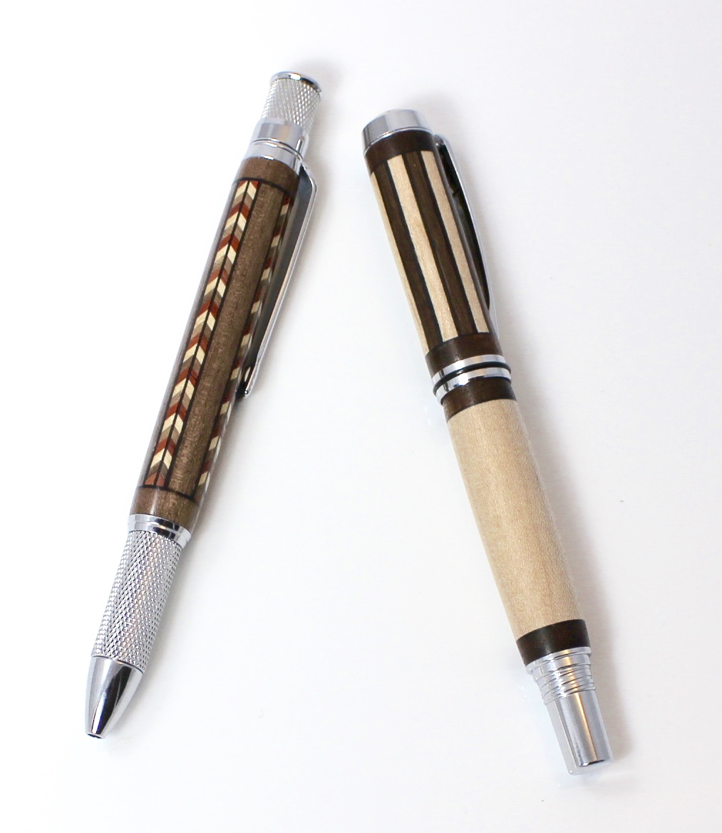

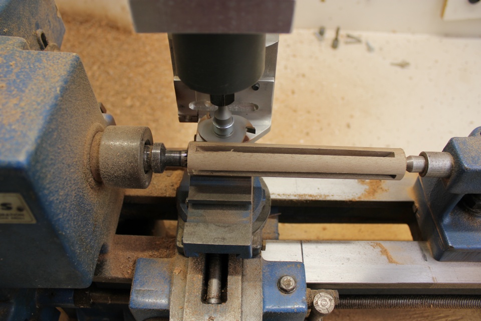

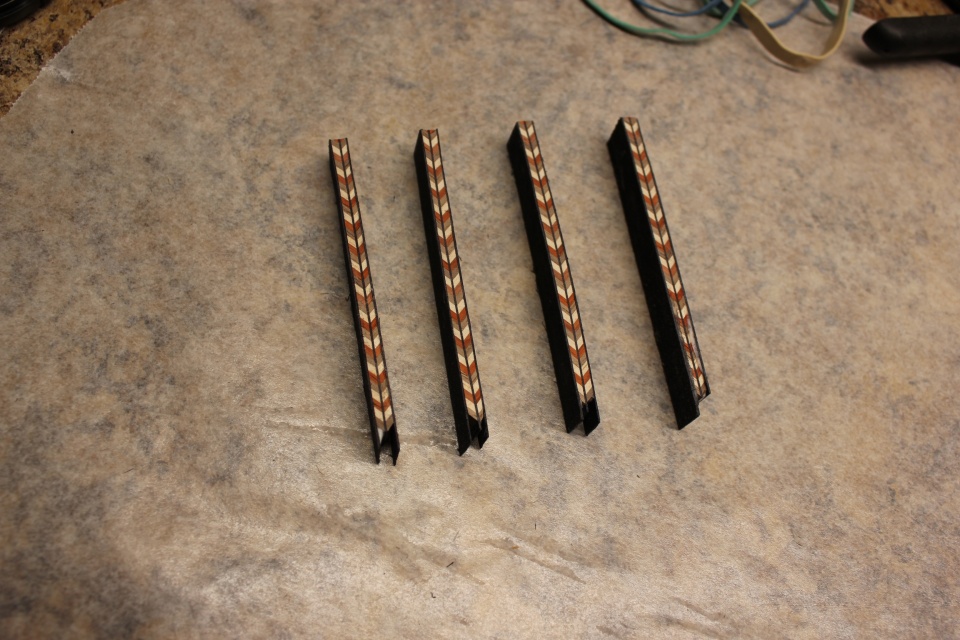

Very well done Mark. I have said this before but it bears repeating. You have come a long way with your segmenting. Have a question are you making the segments in a stave pattern or are you using a router??? I ask because it looks like at least 6 sided on the long stripe pen. Do you have a before turning photo of the blank. ???

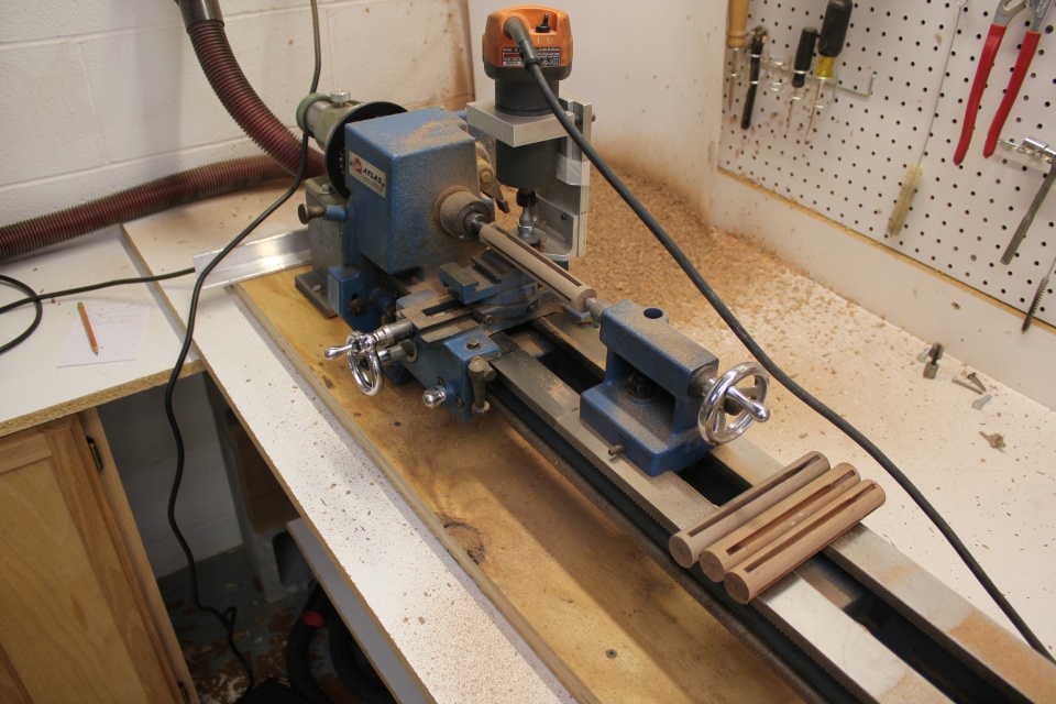

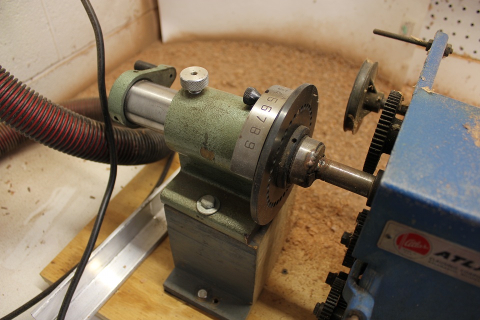

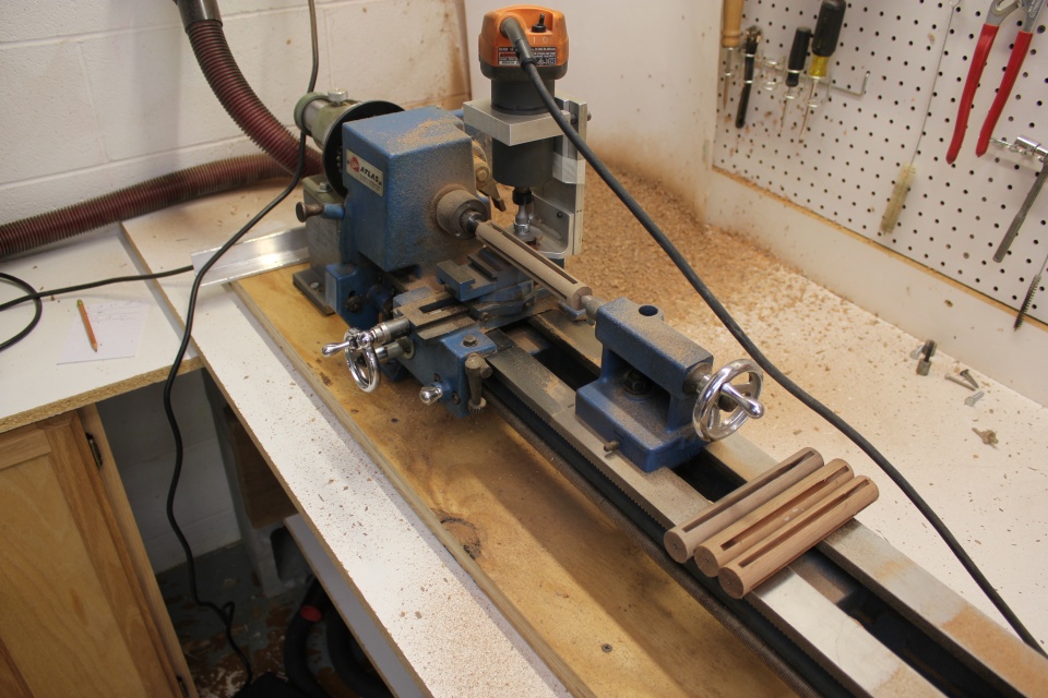

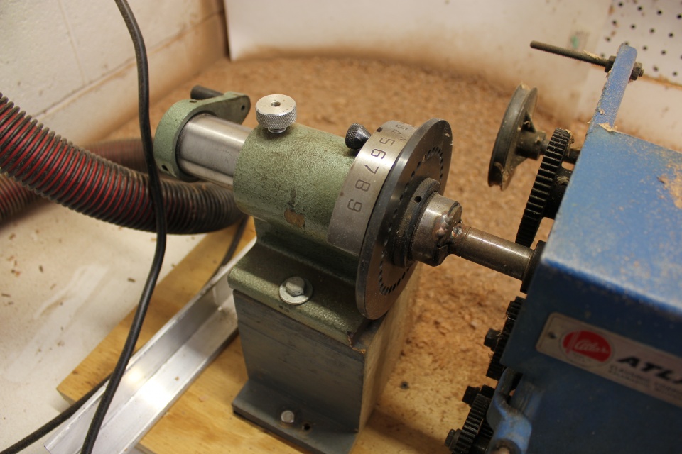

JT, Meet "Frankie" (Your conversations with MPX a few years back was very helpful).
As you can see "Frankie" has long ago lost it's motor; but it does have a rock-solid 360 point indexing plate!

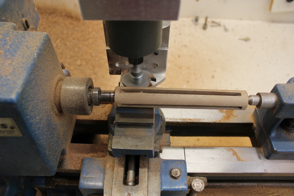

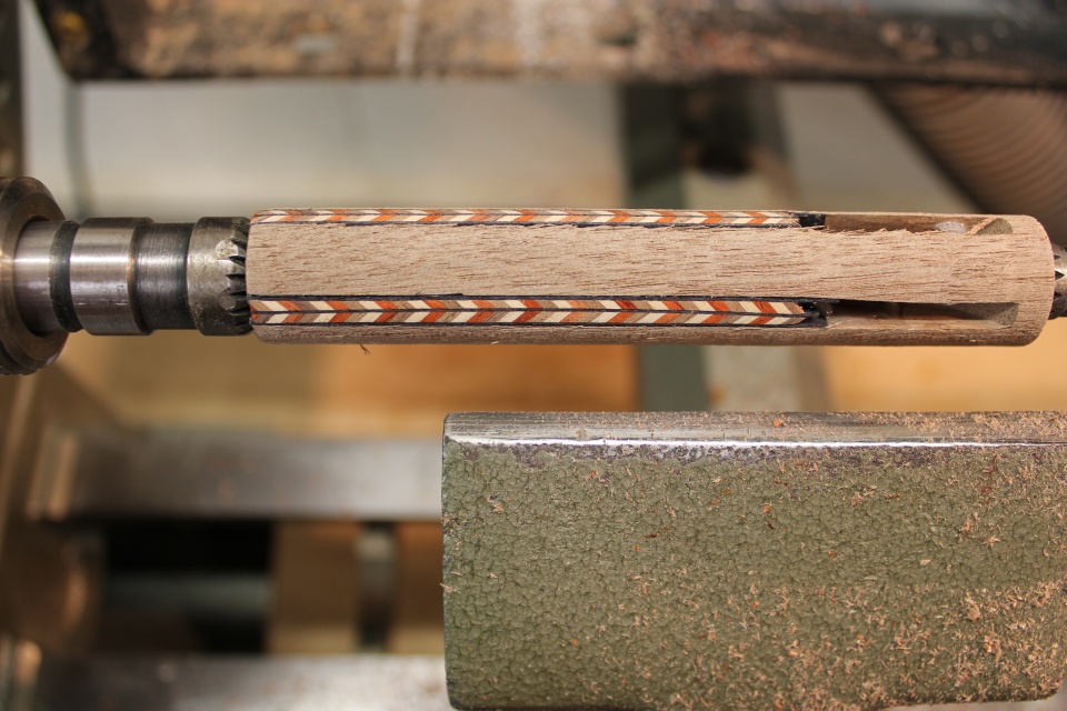

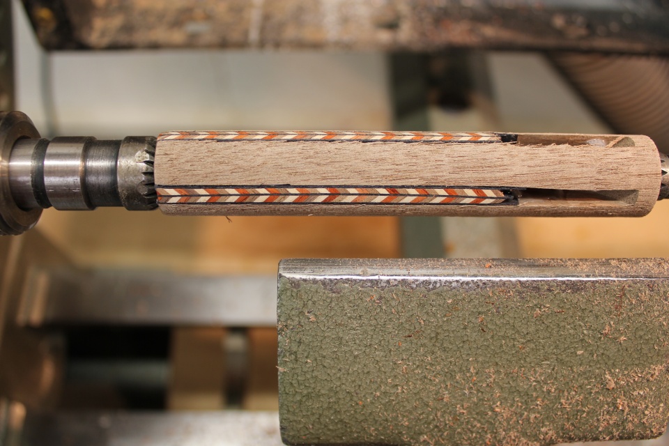

Yes, that was six slots. The other is 4. I will next try 8 and 12 with thinner slitting blades. But as opposed to doing pool cue billets (which I have never done) which have a larger diameter, pens are thinner, and there is very little left in the middle when going above 12 slots (at least I think). But admittedly, I'm just playing with these designs so far.
I am feeling proud right now:biggrin: My knowledge has rubbed off on someone. It is so good to see others attempting this kind of work. As far as cutting slots go you can cut as many as you want as long as the material you are infilling is thin enough. I have cut 12 with no problem. The smallest bit I have is a 1/16". I do have to get back into pen making.
Thanks for the photos and thanks for showing your work. Love what you are doing. When I do get back to having some time with pens you and I are going to push this thing to new limits that have not been seen here.

Nice work, Mark !!!! . Very nice indeed !!!! . And thanks for posting all the how-to pictures. . I think I get it !!!!

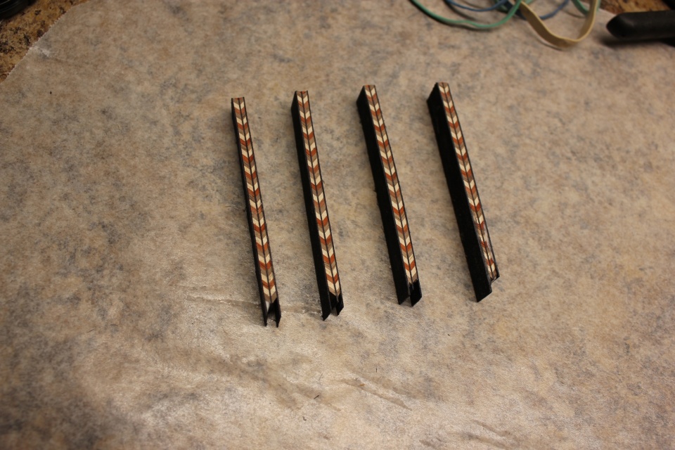

LOL - That's OK! I do realize the Chevrons are possibly not a good disguise for me anymore. But they are fun to make. I'm trying to make 20-30 blanks to sell at the MPG (donate the proceeds) to support the event.

I like everything about this post. The blanks, the pens and especially Frankie. Well done. I nominate one of these for the IAP collection.

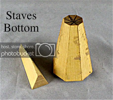

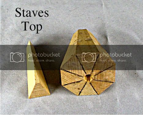

Mark you probably know this but another way to make the stripe blank is to do a stave piece blank. You can add accent pieces in of any kind. Here is an old example of a bottle stopper I was making. This happened to be a compound stave cut but a straight stave will work for those blanks.
