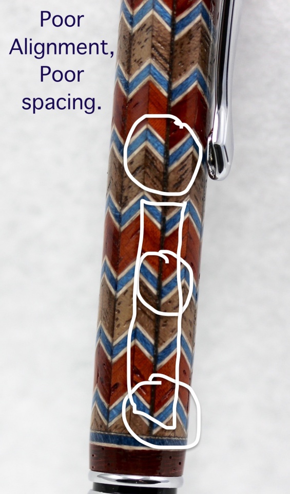

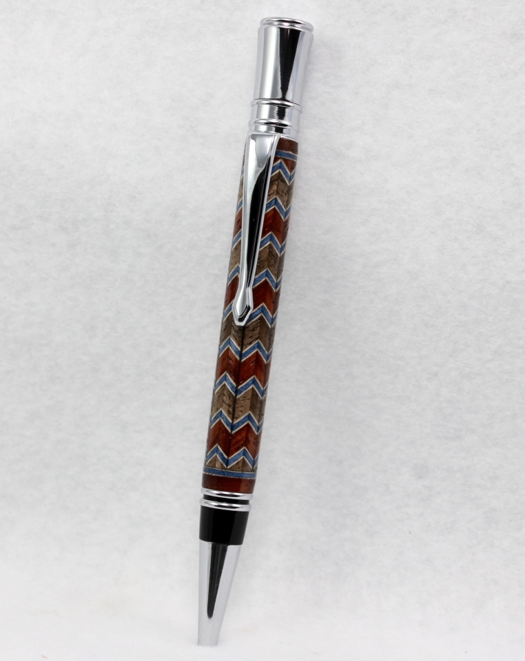

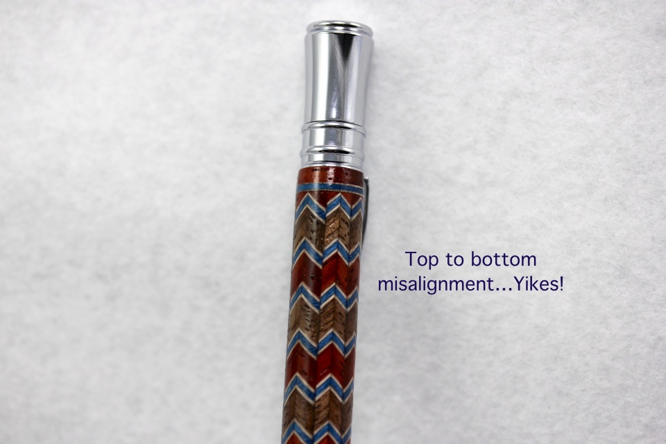

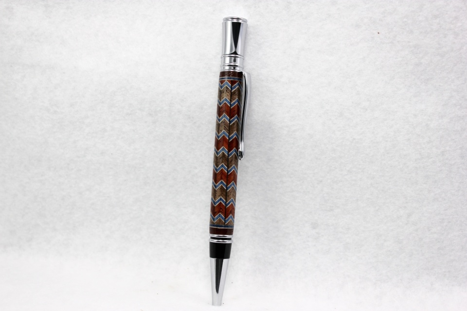

Hi Segmenters!
I previously posted the construction of this blank: http://www.penturners.org/forum/f179/different-chevron-method-finished-blank-only-155799/.
While it was fun to construct, overcame several obstacles, the final symmetry was poor. Nontheless, It escaped the scrap barrel and was final turned, finished and assembled (I had to be coerced...).
So... Its a very nice segmented pen, lots of complimentary colors, looks cool... (But to an eye for segmenting, not so fast on the compliments...).
Lets use this thread to do a healthy critique! So often we see perfect, final products; no hint at the hrs, days, weeks that went into the final assembledge.
AND I'll start: My pickies need sorting, so look in the next thread.

I see where the segments didn't line up properly in the 2nd, 3rd and the 4th picture ... yeah, that would drive me nuts too, man ...
Barrel Stave construction style? Aside from the mismatched alignment I think that the colors generally match up quite well and look good together.
Did you use some kind of jig to get proper alignment? How would you feel about making some minor adjustments and trying it again? Do you think it would have been better to arrange it in segments and then put the segments together in order after re-squaring for alignment before you drill for the barrel tube?
Do you think it may also be better to do all that work and arrange it to look perfect from the outside as an angled barrrel and then cast it and turn a crystal clear exterior barrel around it?

The mismatched alignment sort of jumps out at you. Aside from that, I think it is just too busy. Too much going on for my eye. I cannot imagine the work and hours that went into that pen and give you an A+ for effort. Breaking up the chevron sections and placing some solid strips between the sections might help.

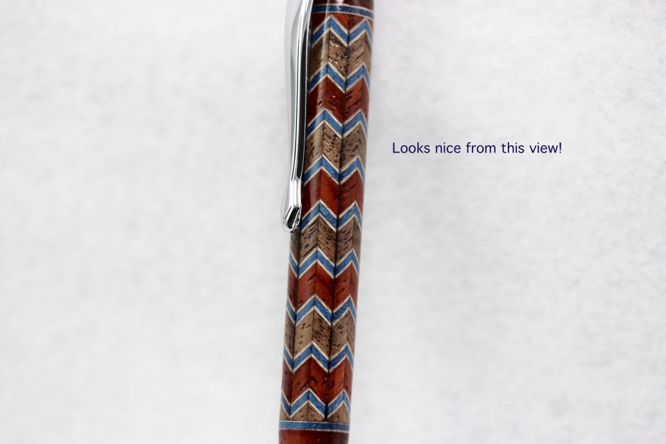

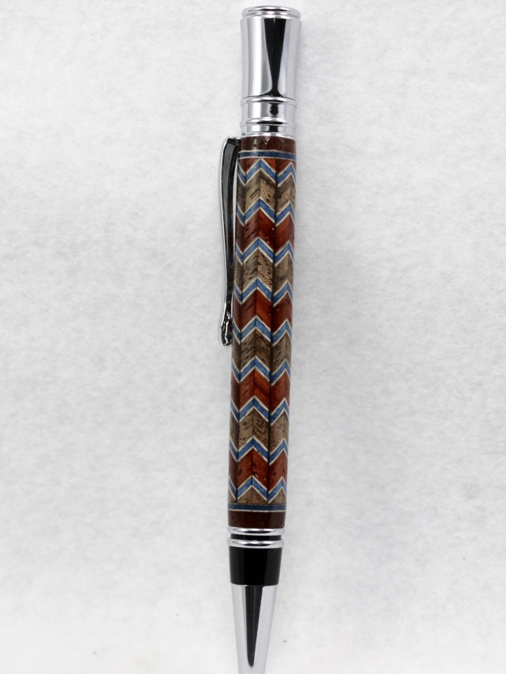

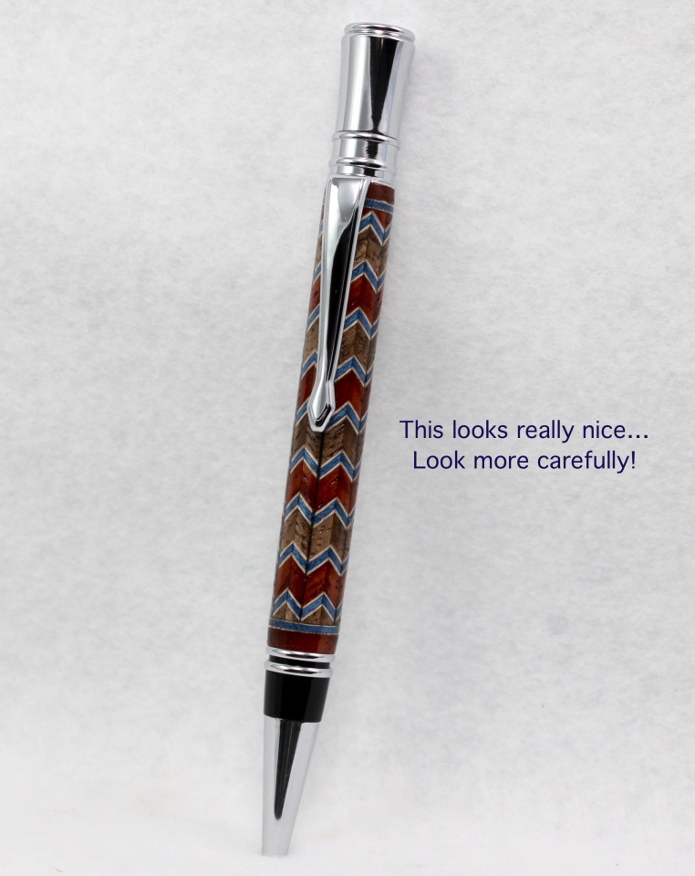

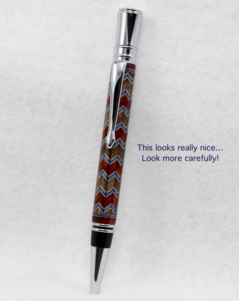

One view may look GREAT! But look carefully. Yes, I do know that many family, friends, customers, etc may not notice, these issues really bug me!

IT looks like a labor of love of pen making for sure. And, You sure are brave to work on something that tedious!
Still, Great work!
Now to my questions if it were me: Do you "know" where the misalignment came from? That is what drives me nuts. Alignment issue? Thickness issue? measurement in cutting issue? These are the things that I contemplate over and over until I find out where it was off that I didn't see when I was doing it. I am more obsessed with finding out WHAT I missed doing and why I missed it than anything else.
Barrel Stave construction style? Yes, this was my first attempt at a stave construction. Aside from the mismatched alignment I think that the colors generally match up quite well and look good together. Yes, the colors are fine.
Did you use some kind of jig to get proper alignment? I got the angles (posted previously) with a belt sander. SteveJ has done a better/more precise effort with a Byrnes saw (which I have). How would you feel about making some minor adjustments and trying it again? (No problem tweaking this!) Do you think it would have been better to arrange it in segments and then put the segments together in order after re-squaring for alignment before you drill for the barrel tube? (Ya lost me here!)
Do you think it may also be better to do all that work and arrange it to look perfect from the outside as an angled barrrel and then cast it and turn a crystal clear exterior barrel around it? We've been tossing that idea around (Segmenters). Only issue as I see it, the OD at 3/4" may not match the OD at .520" for a finished blank. The symmetry outside may not be a good view of the symmetry inside.
Please continue these thoughts. This was NOT a "Look at a fantastic pen! Thread." It was a "Let's tear this apart and have some fun improving!! Thread.

I think that if you started out with slightly wider chevrons you might be able to make better joints. Also, you are using the sander to make the angles, when I tried that I found the staves to be inconsistent. Using double sided tape and cutting the staves on the Byrnes saw kept them more consistent. Of course I did 8 staves (which also simplified the angle measurement).
Yes, the sander did not give the best angles.
Constructing Chevrons with wider sections is easy. This is a variable that can easily be incorporated. TY.

Hi Hank.. OK, so for the "misalignment", I suspect that when I assembled the "star formation" several of the points were too far in, and others were too far out. This would result in the final width of the chevrons being too wide or thin, or in several of mine, 1/2 of the chevron was too thin.
SteveJ has a more precise method of getting the angles cut. His concept may be the best ava way to get a center-point with very precise angles.
Happy segmenting!

I think you did an excellent job with the concept. But for eye appeal, it as CWalker said, "too busy", it doesn't seem to meet the high standards you have continuously been showing us.
I agree, a different method to construct the blank, but little thought was given to the dimensions of the chevron. A critique well deserved! :)
GaryMGg
Nov 23, 2006
5,786
McIntosh, Florida, USA.
I believe it wouldn't be too busy if the alignment was perfect; I believe it would be magical!
The colors and pattern would be like a kaleidoscope—I've never heard anyone complain a K is too busy.
IMHO, it's 'busy' because of the misalignment.
You might get better alignment using painters tape during the glue up once you work out perfect consistency for each stave.
Even with the issues, the work is quite wonderful.

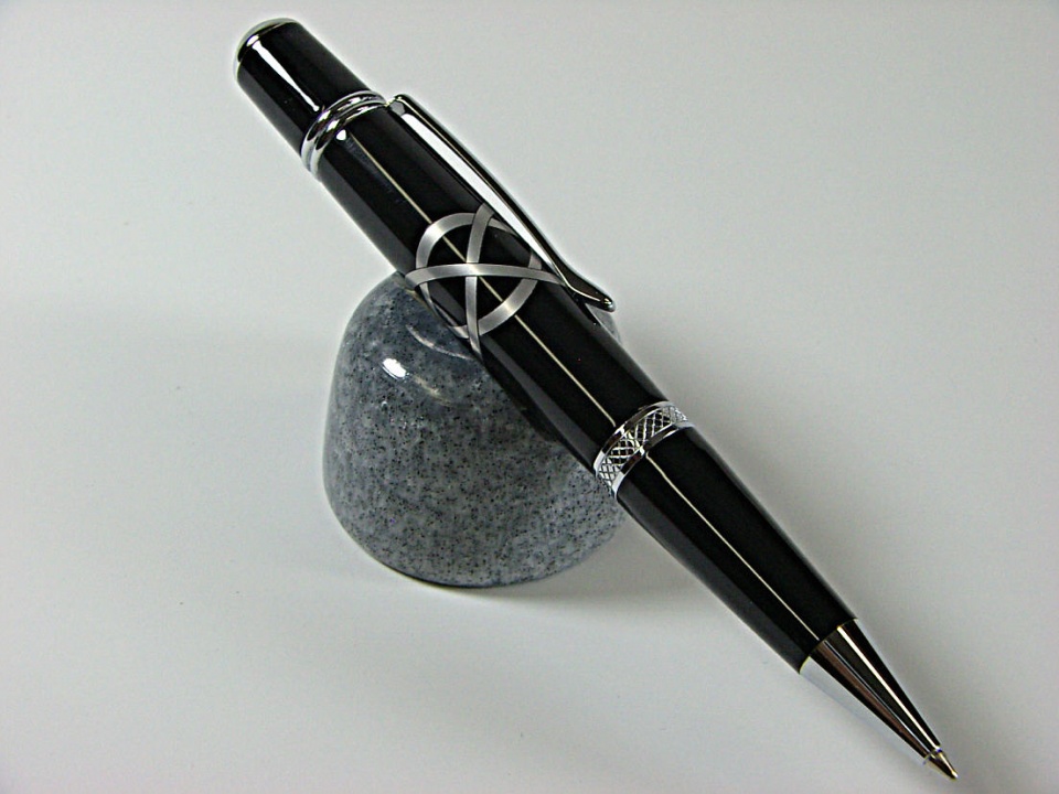

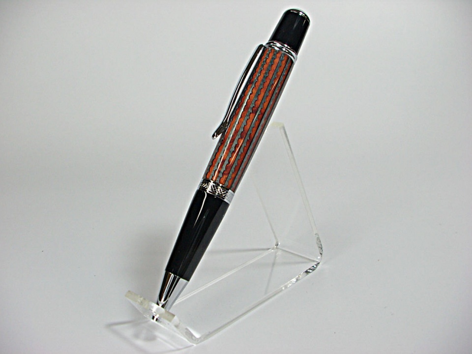

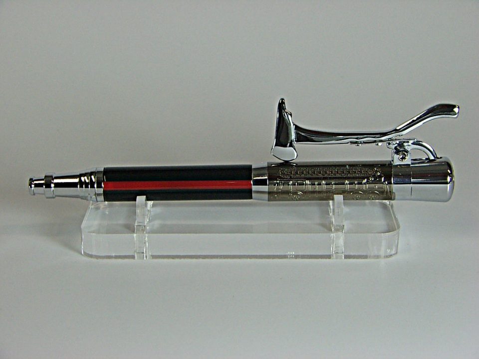

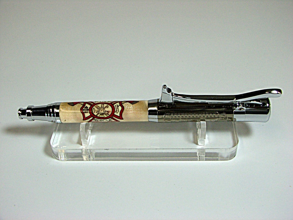

Well Ernie lets muddy this thread up too. This is for you. The very latest of my pens that came out of my shop.
First one Celtic Knot in aluminum and black acrylic made and shown 3/21/17
Second is 2 Fireman pens, one is a laser cut inlay and the other is a thin red line which I cast on my own and shown 11/19/17 These I made a few of for some fireman friends I have.
The scrollsaw blade one was made by me and cast for the casting contest for the Bash of 2018
The last one was for the Pretty Wood contest for the Bash of 2018
Also worked on a Pen box that was labor intensive and a pen stand for that same Bash of 2018.
Now since then I have had knee surgery Got back in my shop 2 months ago and am currently trying to get some inventory stocked up for my shows in November and Dec. I do other woodworking such as scrolling for which I have shown numerous projects over the years that I have done. I really do not have to answer to you but to shut you up there are some projects. I do not make many pens and the ones I do are one of a kind. When I do get some done I will add to my album and not put them in the thread of SOYP If you want me to send you a PM when I get any done just let me know so that you can degrade them.
I do have about 4 pens in various states sitting on the workbench. They may come into play for this years Bash.
Again not sure what I ever did to you for you to take this attitude but so be it and have at it.

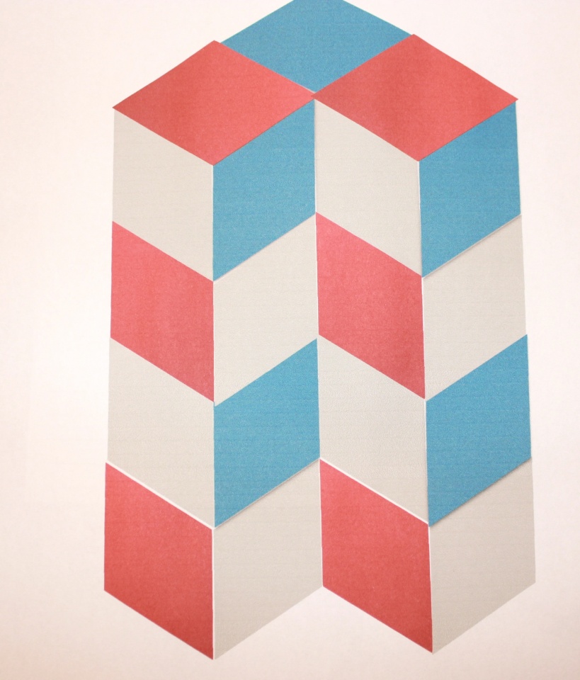

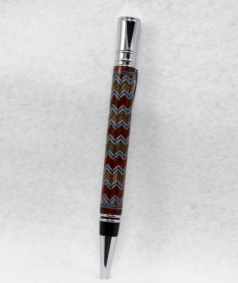

Back to the original topic on hand .... CHEVRONS IN A SPIRAL PATTERN down the length of the blank .... This could be possible with the use of your chosen patterning and the barrel stave method to assemble. You'ld need to construct a longer stave pattern, with an additional variation in the colors that you'll have to match up and arrange into your spiral pattern.
It would have to be a set pattern so that you can reverse it and have it match up to itself. Perhaps have this "special spiral chevron color" every 5th or 6th one in the arrangement, so that you can move it's position as you go around the barrel blank. The number doesn't matter, just that the pattern is even. The more you have, the more spirals will be going down the barrel.
As you set your paired chevrons, one set will be pointing down the barrel, the other side of it will always be unpaired with the proper color. You may be able to call attention to this as part of the design by having the chevrons themselves form a chevron going the other way back up the blank instead of spiraling down the blank.
Like this ?:

lol ... so, you already had the spiraling chevron pattern he asked to see next squirreled away somewheres ... :)
mark james
IAP Collection, Curator
Sep 6, 2012
12,752
Medina, Ohio
G'Day Greg... Sorry, I believe this posted a day before/after you came back from your hiatus (Feb-Aug). It was part of a process, but all your comments still apply, and are appreciated!
http://www.penturners.org/forum/f13/360-degree-nanogon-chevron-pen-155985/
