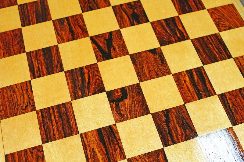

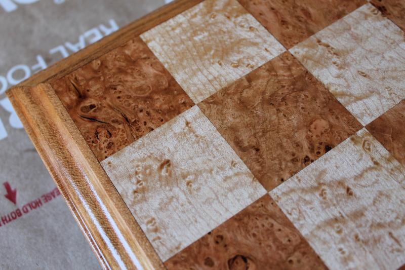

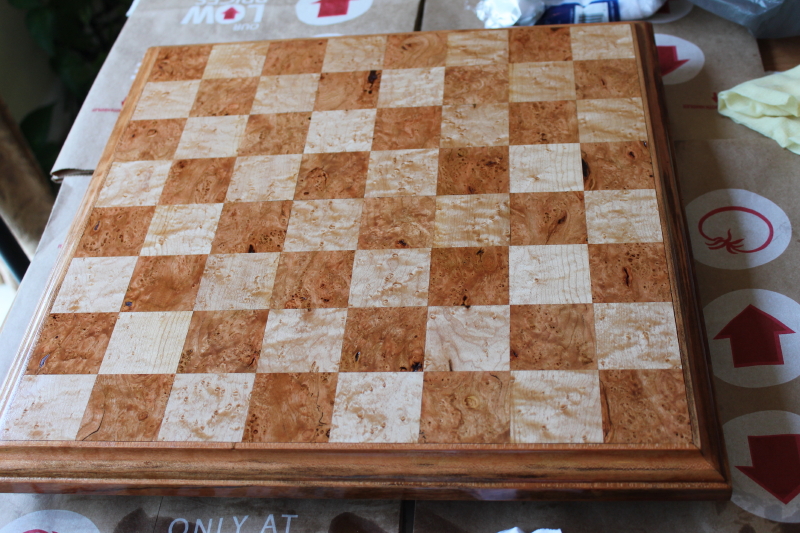

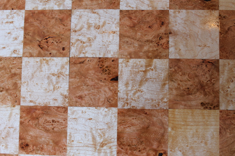

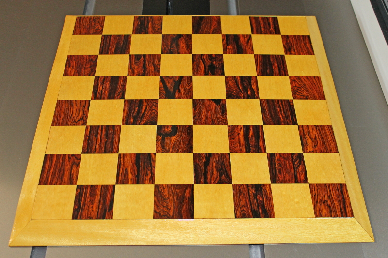

Taken a little break from pen making and tried my hand at a couple of other things. Here are a couple of Chessboards I made.
Cherry burl/Birdseye Maple
Cocobolo/Yellowheart
Would love any thoughts, feedback, advice?

I really like the cocobolo/yellowheart the most. The only aspect I'm not a fan of is the border. The color and grain in it and the squares are so similar it gets lost. I'd love to see one with a cocobolo border. Since the grain is so different I think it would stand out more.

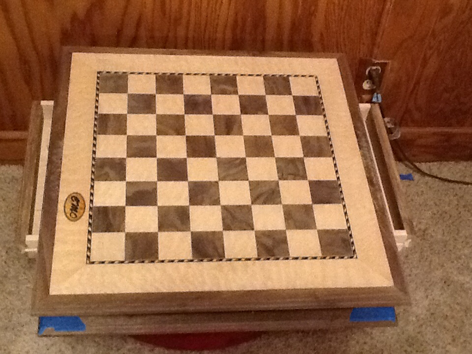

Looks lot like checker boards to me. Lol. Nice work. Game boards always fun project and much appreciated as gifts. I'm guessing someone is going to be very happy this Christmas. Here's one i made for co-worker son for Christmas last year complete with piece storage and his initials inlayed.

Those are both fantastic, really well done. I really like the Cherry burl/ Birdseye maple the best. I has an aged look to it really amazing.

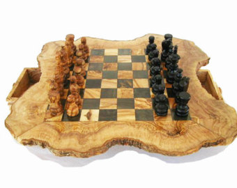

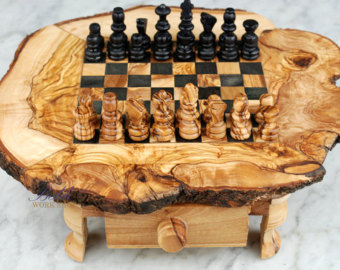

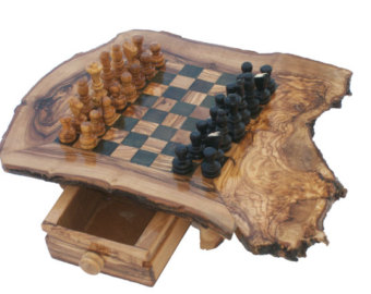

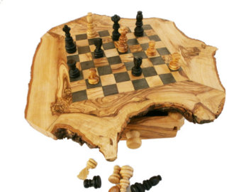

I ran across these on ETSy.com.... they are practically giving them away.. highest priced board is US$79 down to as low as $39.... I think they're olive wood... They are from Tunisia, so price may be appropriate.
