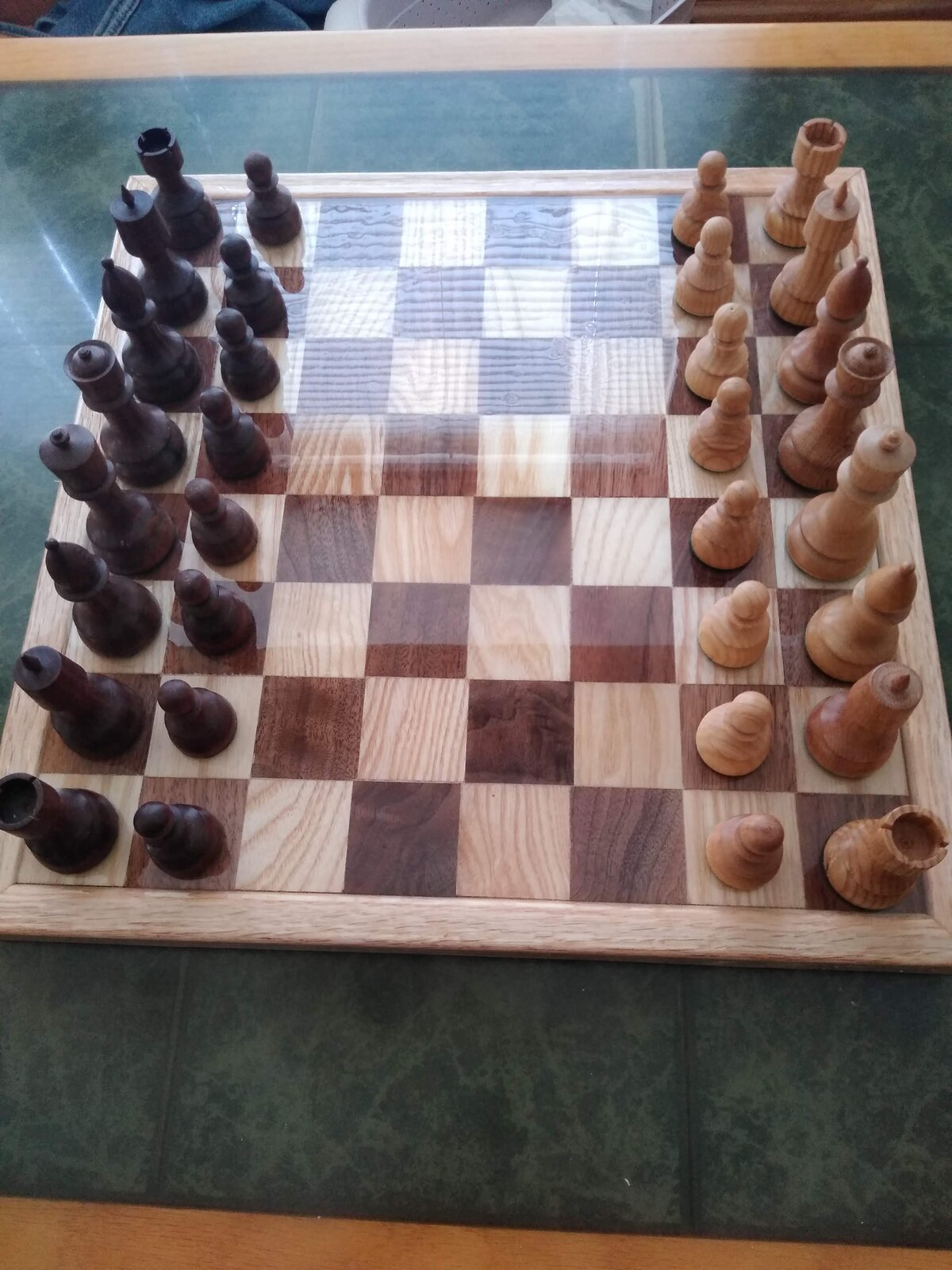

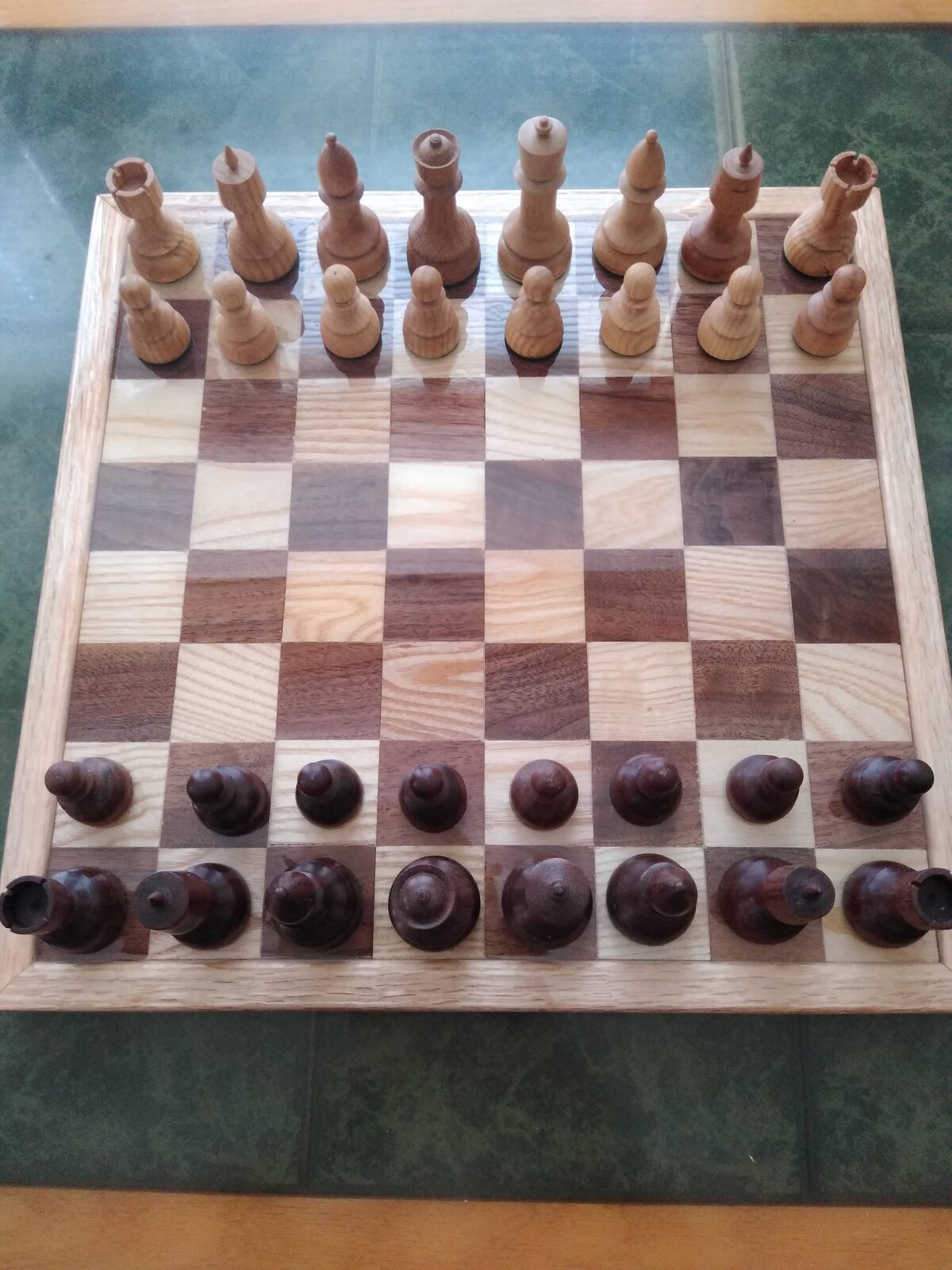

Good morning all. Just wanted to share a chess set that I made about three years ago. I am currently making a second set for my chess-loving brother-in-law, so I thought that while this was fresh in my mind, I would share the finished product and how I turned them.
Firstly, here is the chess set. The board is made of the same two woods, white ash and black walnut, and framed in with red oak.

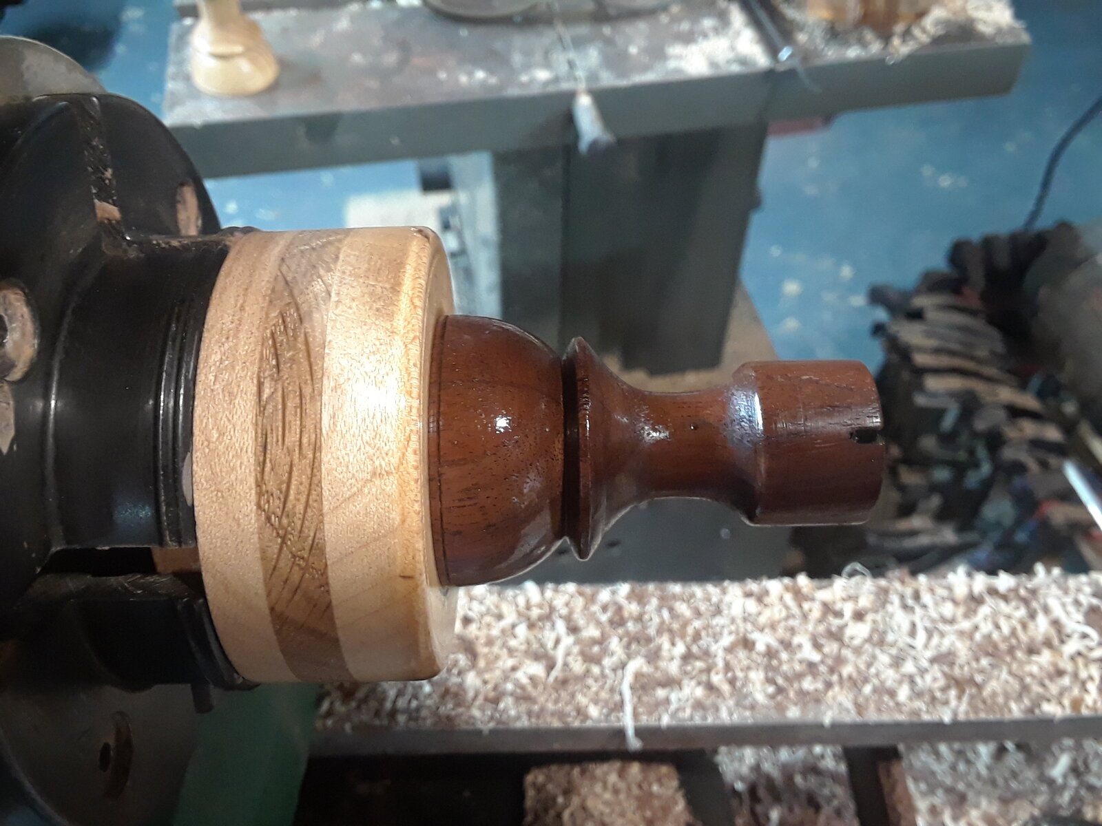

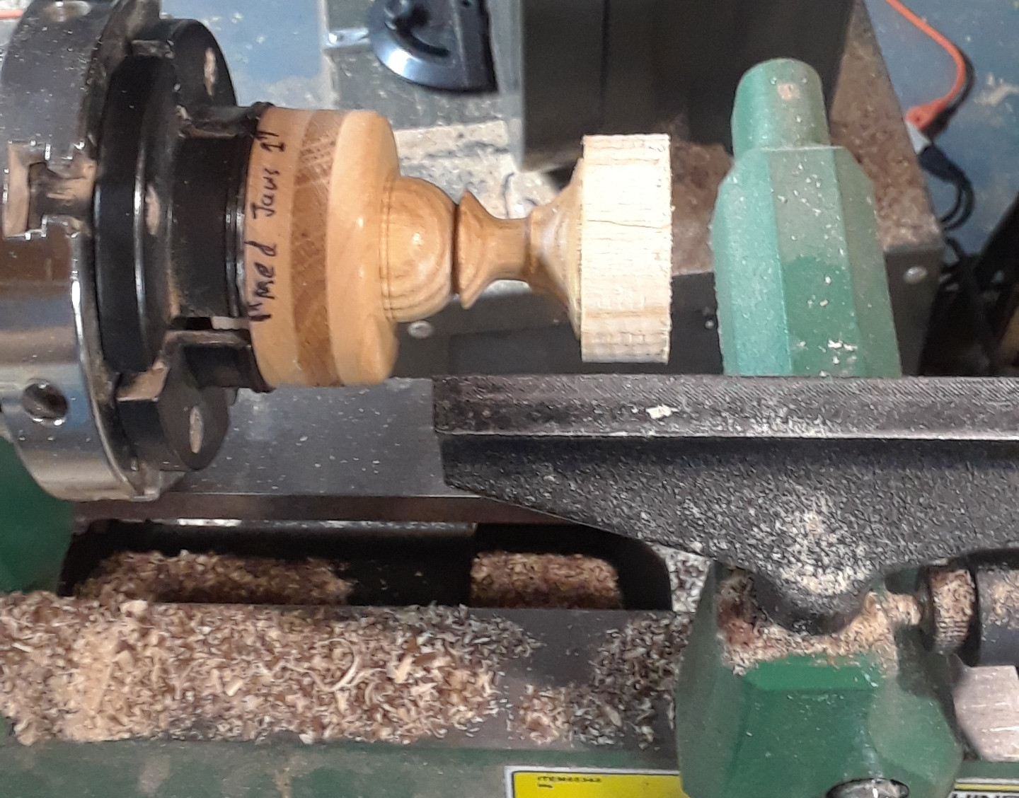

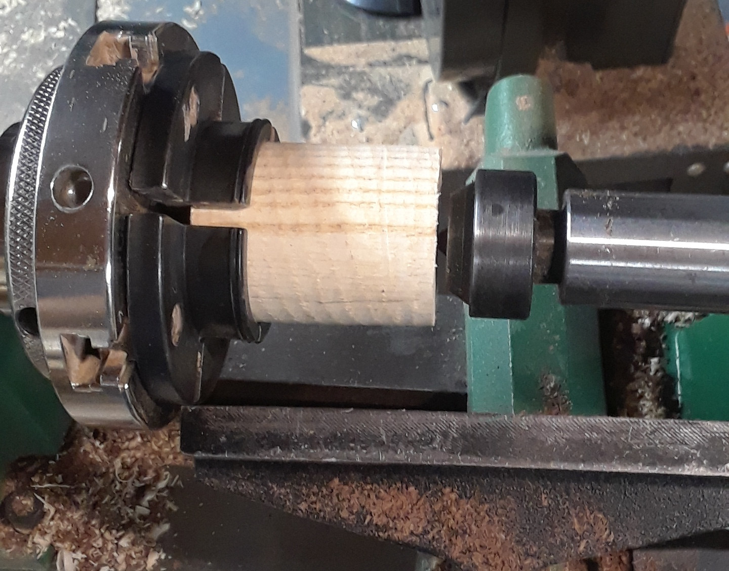

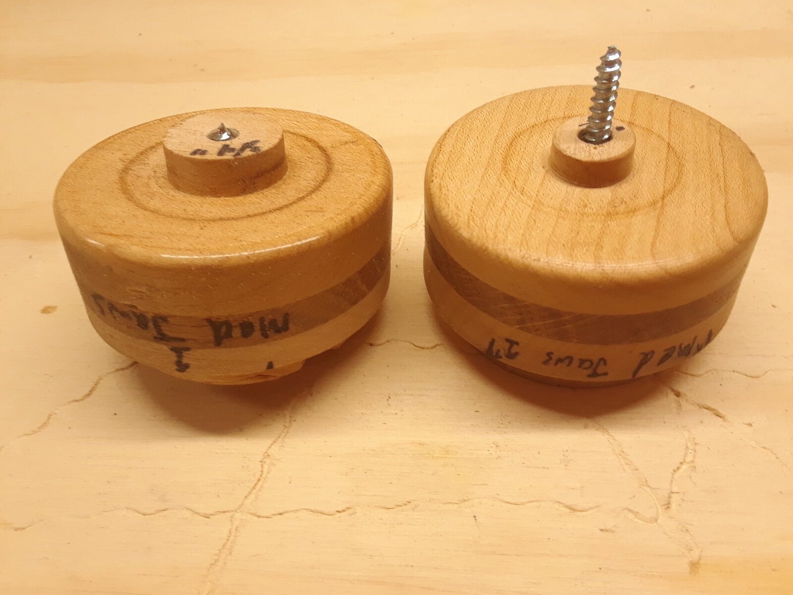

My idea was to turn the pieces of white ash and black walnut. I had scored a ton of rough cut wood, which was quite ugly looking. I would turn the pieces into cylinders on the larger lathe to make sure the wood was sound, and to look at the grain. I would then cut them down into the sizes I needed. I also had to make two chess chucks. One for the back row and one for the pawns, since the needed a smaller base. I had some scrap maple/red oak from a project I had prior, so I used the cut up chunks and created the chucks:

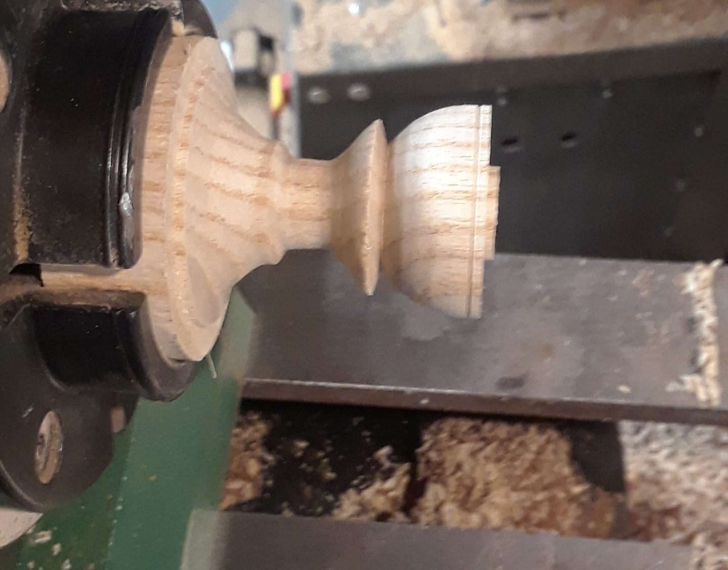

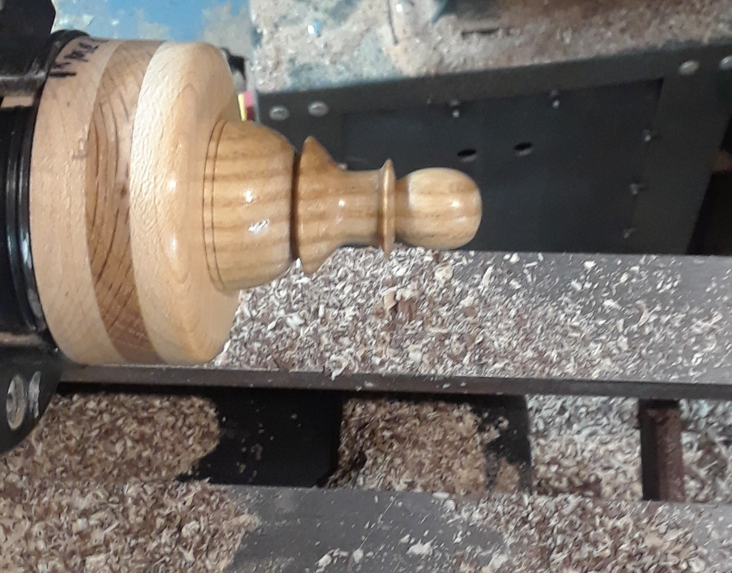

I then tossed a hunk of wood into the regular jaw chuck and turned and finished the bottom of the piece first. In these examples, I am working on a pawn:

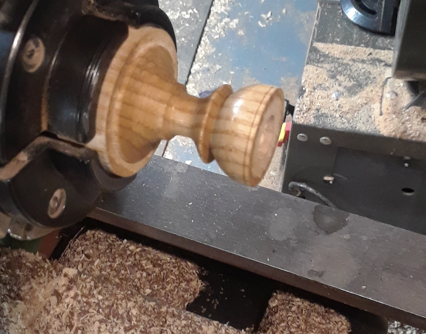

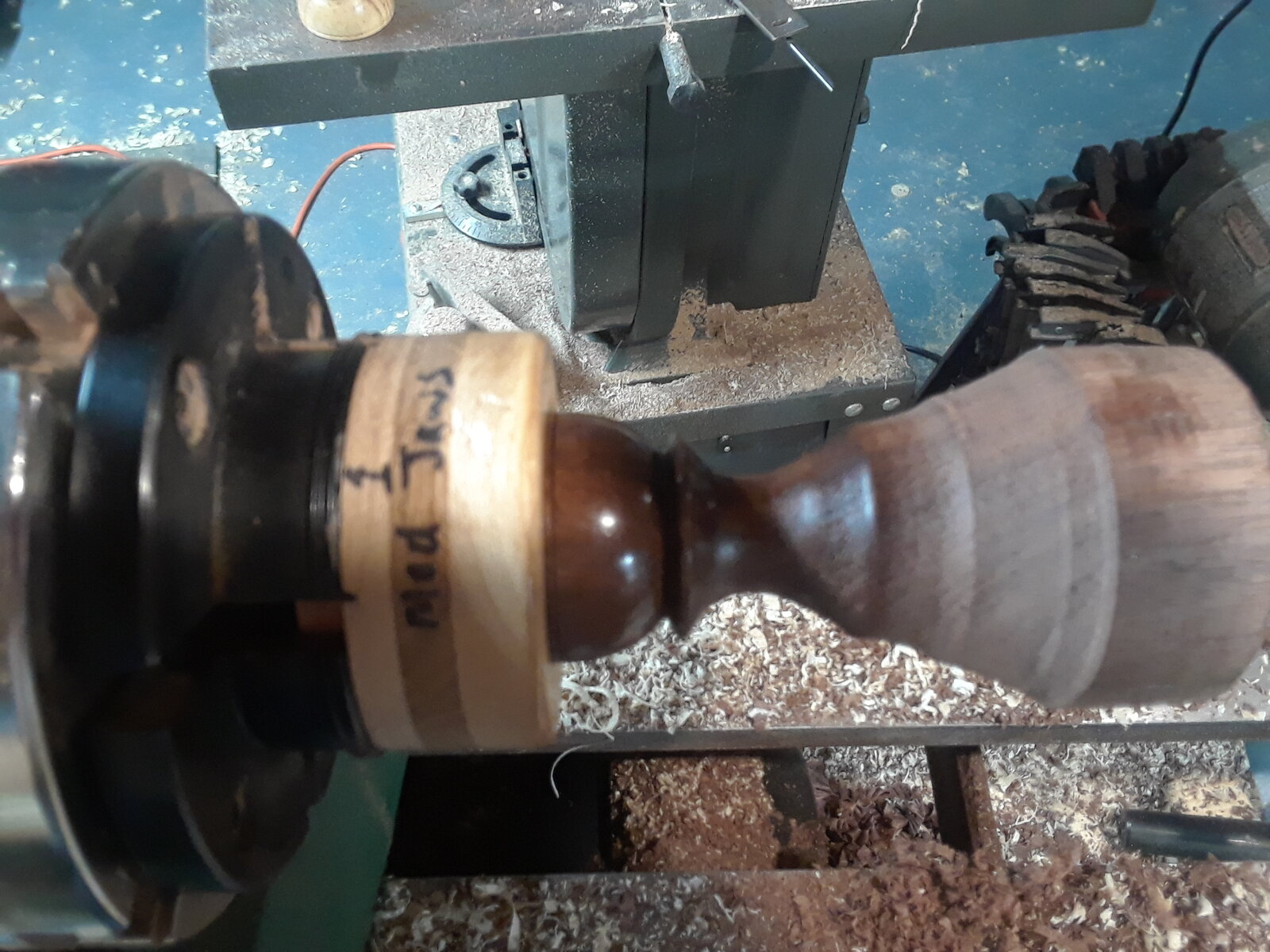

Once I have done the bottom, I drill the appropriate size hole to fit the chess chuck, and drill a smaller hole for the wood screw to hold the chess piece firmly in the chuck. Once I have done that, I start turning the rest of the chess piece
And that's about it.
To weigh the piece down, I crush some led bullet projectiles to fit the cavity left behind by the forstner bit and glue it in with epoxy. I then cut a disc of green self-adhesive felt and cover the bottom with that.

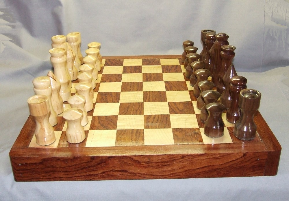

for my chess set I used bird shot for the weight... my friend that does his own loading sold me a 10 lb container of bird shot that I poured in the recess at the bottom and then added CA to hold in place... I left a slight recess at the bottom and added wood putty before I covered with the green felt you mentioned.
The set has long since been sold... the fellow who bought it said he needed a new chess set so maybe he could beat his son.. :)
I used Pecan and Black Walnut for the pieces and Maple and Bubings for the board... don't remember the frame and didn't make a note of it in my notes...
