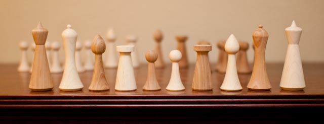

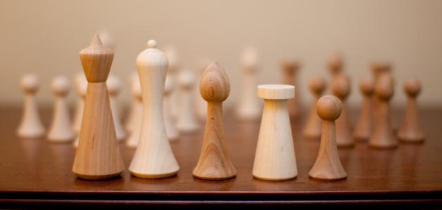

I somehow got it in my mind to turn a chess set. Inspired by the modern, minimalist design by Hermann Ohme, I've finished turning everything but the knights (which are striking fear in my heart). The woods are cherry and hard maple. Getting the pieces to (almost) match is certainly upping my skill!
I also have a collection of errors that will land in the "chess set of misfit pieces," including one cherry pawn I left out to darken in the sun and got chewed on by a chipmunk!

I'm going to go for the knight as Ohme designed it, though I'm still trying to figure out the order of sawing and turning. If I saw the head shape first, I'll be working with a square piece of wood, but I'll have to leave more slop because the axis won't be well-defined yet. If I turn the basic shape first, I'll have to figure out how to hold the round piece firmly on the band saw. I'll definitely have to practice before trying to do it for real!

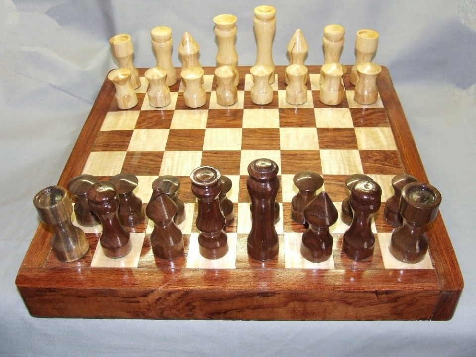

Interesting process, especially the knight, but seems like a waste of wood having the bit left in the chuck after each piece.... but a process I'll take into consideration on my next set.... the set I show above each piece was turned on a collet pin chuck... each piece was drill to fit the pin chuck, then counter sunk with a forstner about 5/8's inch... each piece is then weighted with birdshot and sealed with a wood putty to keep the shot in, then I had a sheet of adhesive felt... I have about 2 lbs of birdshot in the whole set.... I'm a bit of a miser with my wood, even though I have wood stacked or piled everywhere around my shop.
