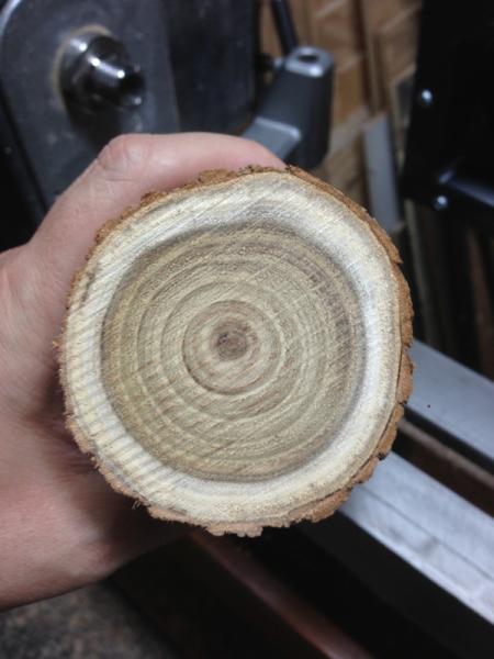

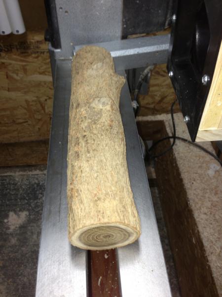

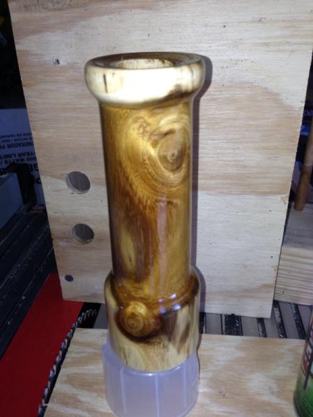

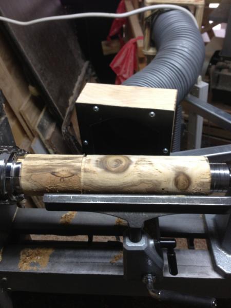

Here is what it looks like. I cut 18 inch off the end of the limb to get to a straight section. Has about 4 smaller limbs coming out around it. Got it turned to shape and forgot to get a picture. Will add more tomorrow.

That is some nice looking wood... the end view... but sure doesn't look like the cherry I have here... mine tends to be more red and without the rings... still should make some really nice looking pepper mills... looking forward to seeing the finished product.
From the cross section and its colour I would have guessed more like sumac. Even the view of the outside looks more like the sumac I turn. Anyway good luck with the mills. They are a great project.
