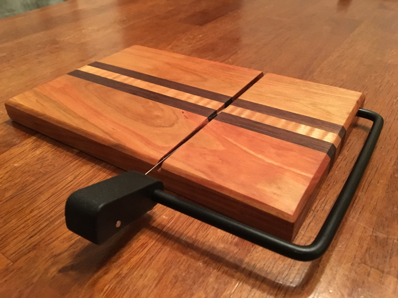

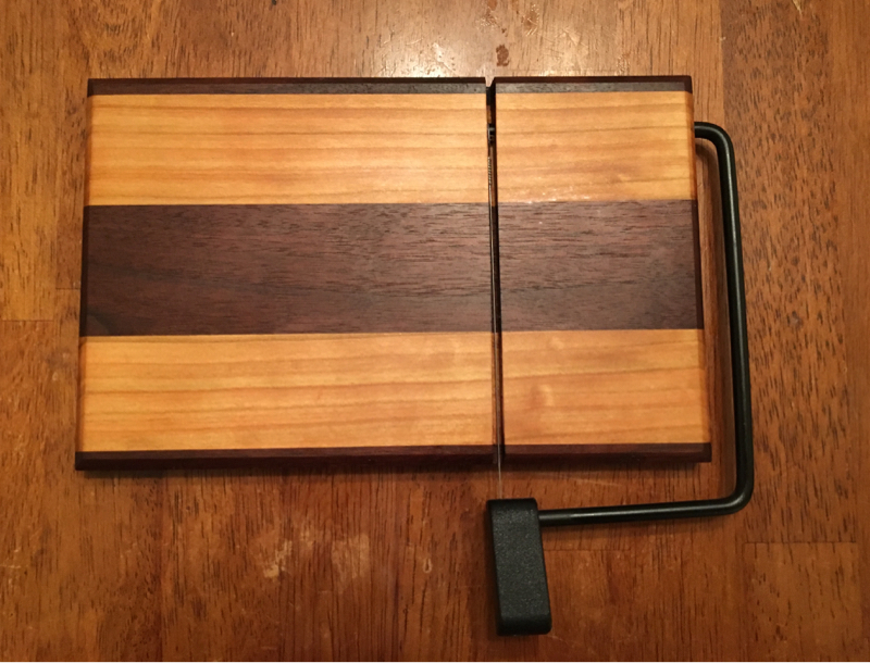

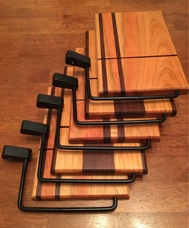

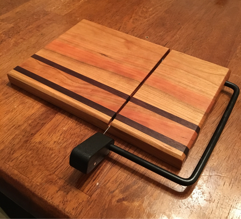

Here's some I finished up this week. If anyone needs any advice or help with making these, let me know. I made a bunch for the holidays last year and plan on having a bunch more around this year. These are mostly cherry and walnut with a strip of curly maple in one.
