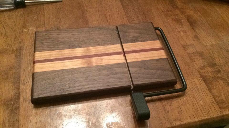

I keep them pretty basic with just s couple of woods each.

OK I see the board. What is everyone buying??? What is getting turned if anything??? Where does the drilling come in.
What you are buying is the chrome or black arm, wire and handle. You need to make the board, like a miniature cutting board about 5-3/4" X 9-1/2". You need to drill a 1/4" hole 2 7/8" deep in the board for the arm. Instructions can be found here on the Woodcraft site and here on the Cheeseslicing site about hald way down the page/
