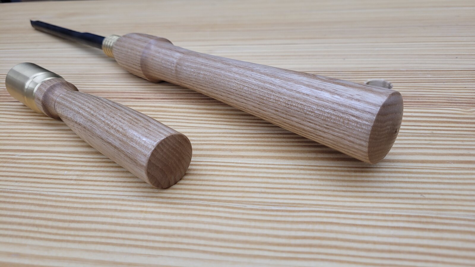

I made these mallet and spindle gouge handles from white ash.
I started with the wood in a 4jaw chuck, turned it round, then drilled a hole in the end with a drill chuck in my tail vise. I added a 60 degree live center to my tail stock and turned the shape. I still had a square section by the butt of the tool.
I think I made a mistake in not leaving the blanks long. I had them at my desired length.
For the gouge, I wrapped the ferrule in tape and chucked it into some small jaws on my scroll chuck. It was not very stable and I added a tailstock. I turned the butt, and got most of the marks off except the last little pinhole.
For the mallet, I mounted the drill chuck in the headstock and jammed the handle over the drill bit. My main issue was the drill chuck wanting to wander off, but it finally behaved. It worked pretty well and I got the entire butt finished nicely.
In neither case did the blank turn perfectly true when I flipped it end for end.

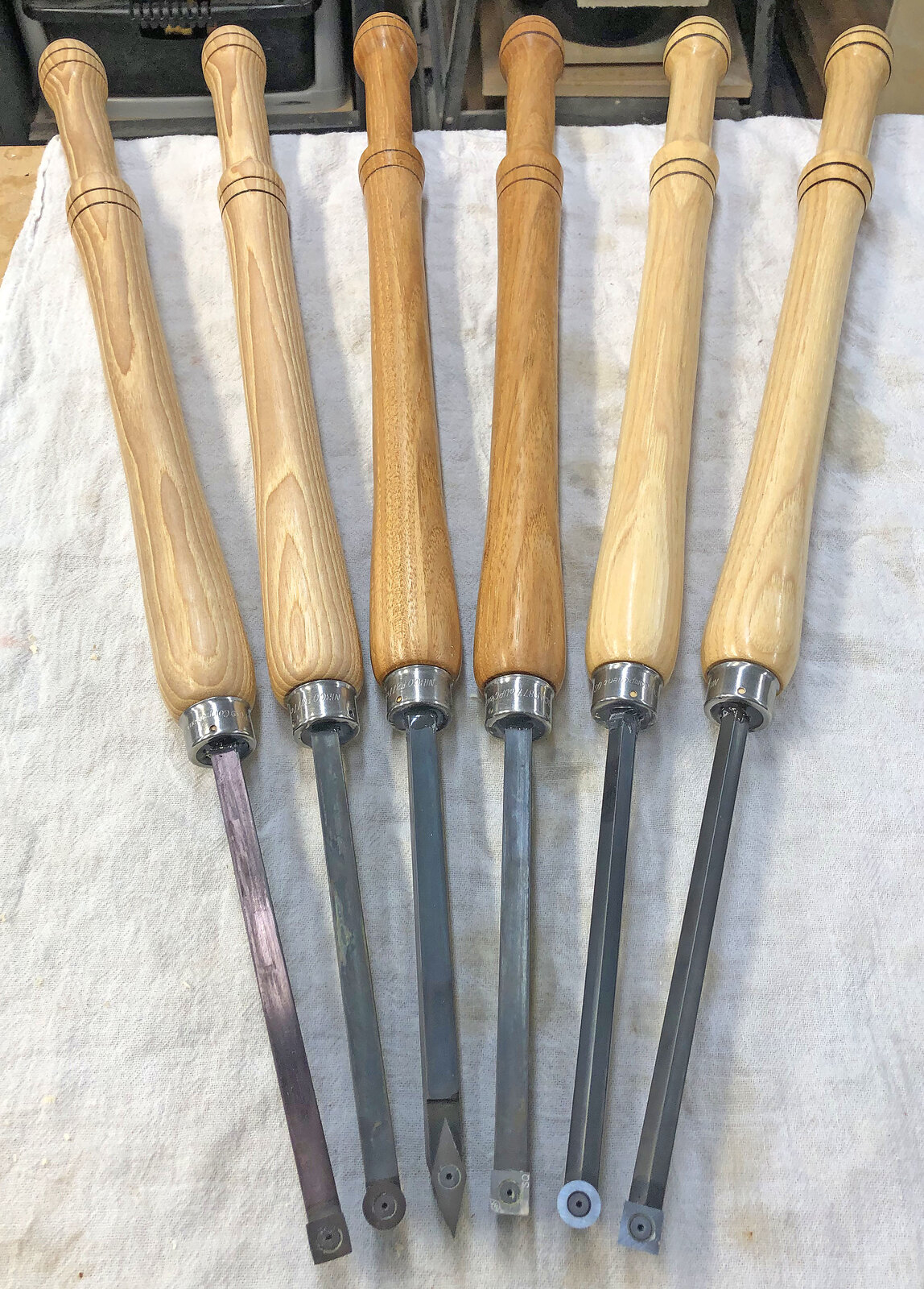

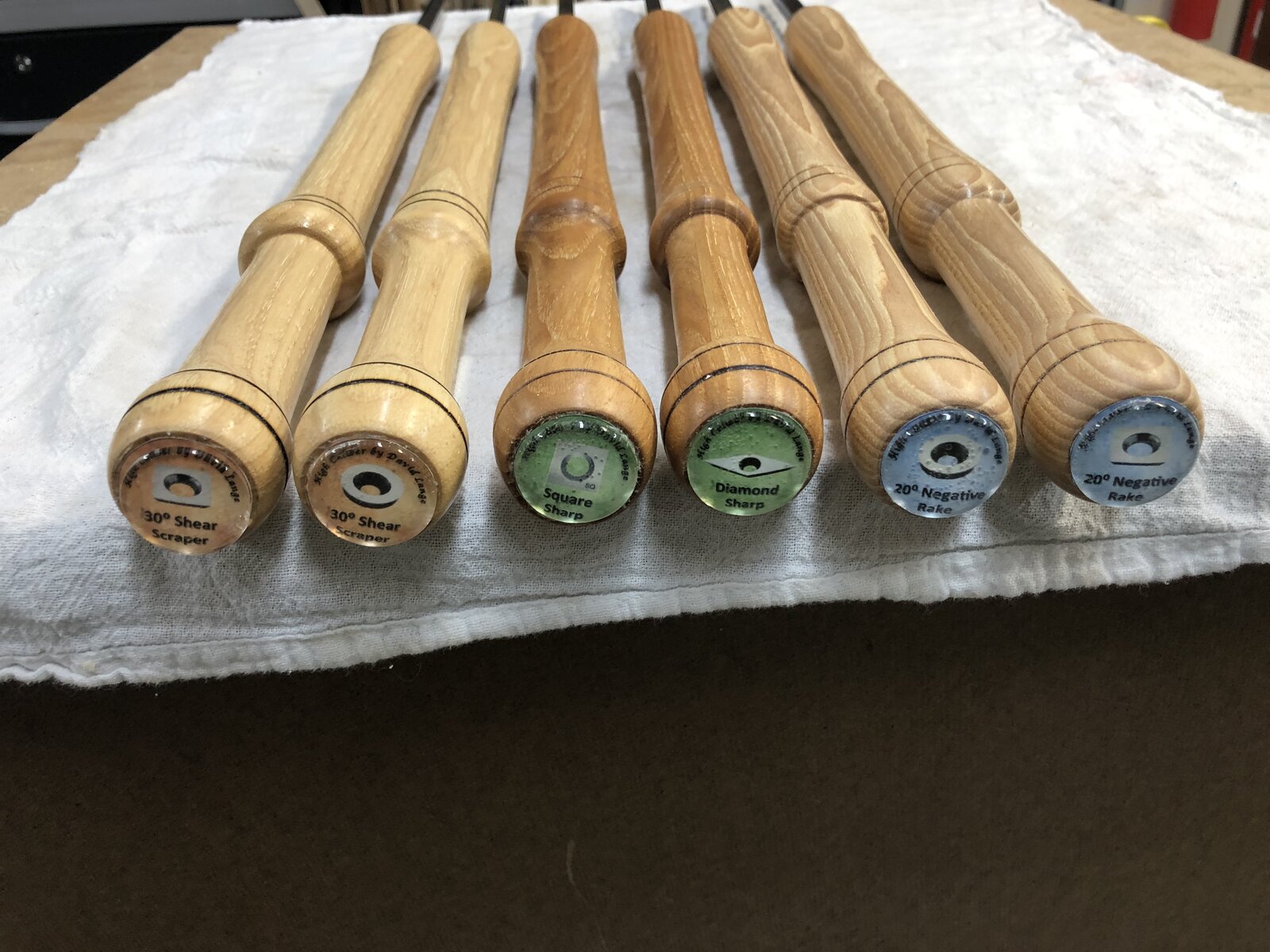

Like many have commented already, I usually turn my handles between centers. I either sand the point marks that are left behind on my dead center off or cover them up with a cabochon of some type, a turned bit of wood, a dowel hole plug, or in the case of my turning tools, a label covered with a clear glass cabochon from my local hobby store. For ferrules I use 3/4-inch PEX Press Sleeves from the hardware store. The shape is lightly flared on one end and lightly crimped (or rolled in) on the other end.
Your White Ash is very attractive. I usually use Hickory (a matter of availability and cost for me). I've attached thumbnails of some turning tools I made recently that shows the PEX ferrules and glass cabochons. - Dave

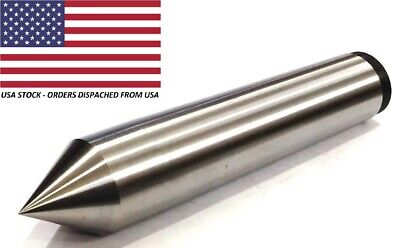

Are there 60 degree drive centers available?
Also thanks for the compliments on the results. The Ash was just the straightest 8/4 stock I had on hand.
Here's one that's available on Amazon.
They used to be readily available at most of the pen supply houses, but the ones I checked only seem to carry drive centers in 60 degree.
There are a ton of them on eBay as well. I just ordered one myself the other day
Nice work on the handles - I'm going to be making a few for carbide tools soon.
Michael
Realized I didn't provide a link - this seller has a fair number of lathe accessories:
