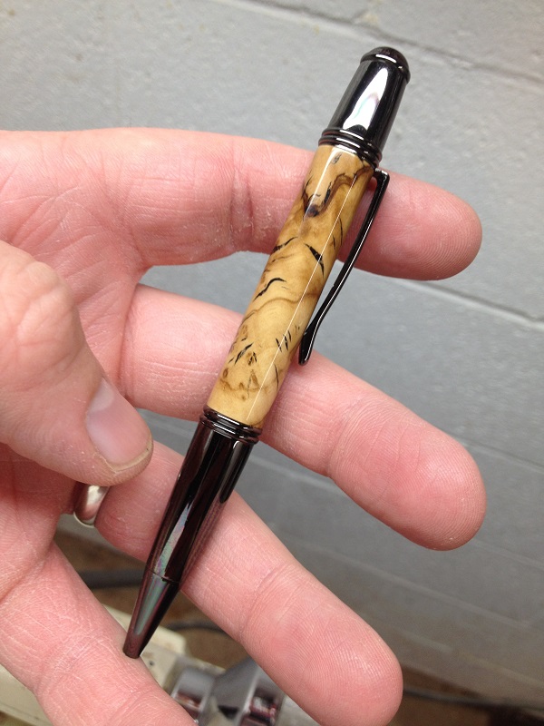

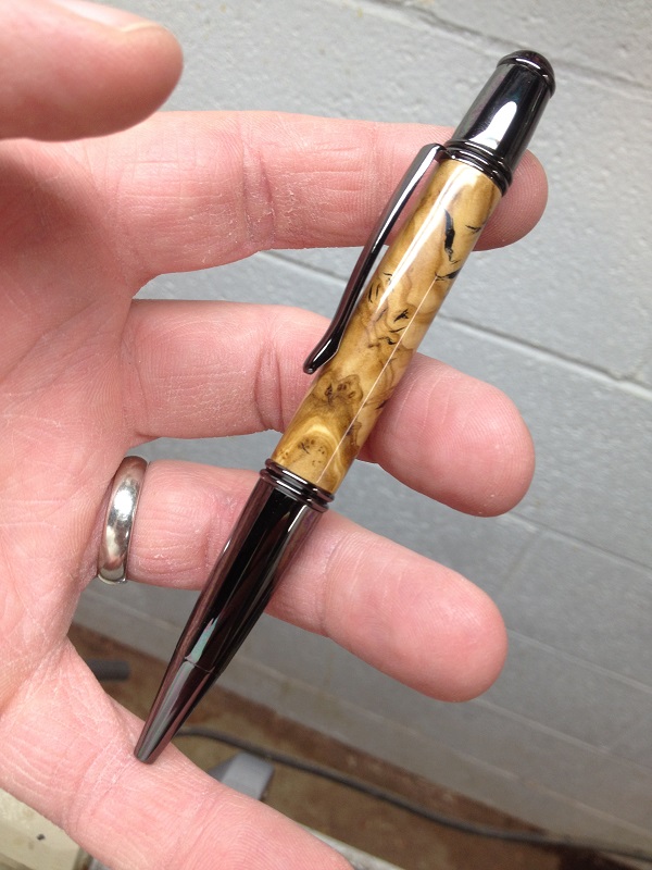

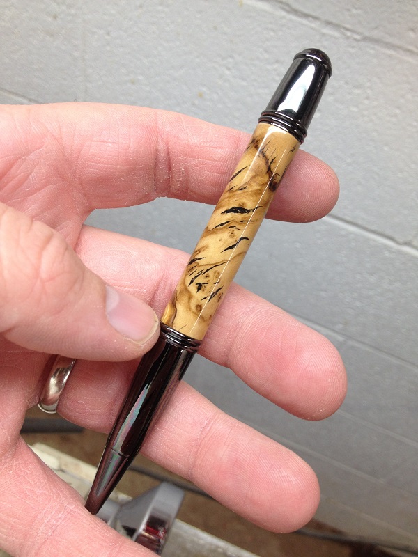

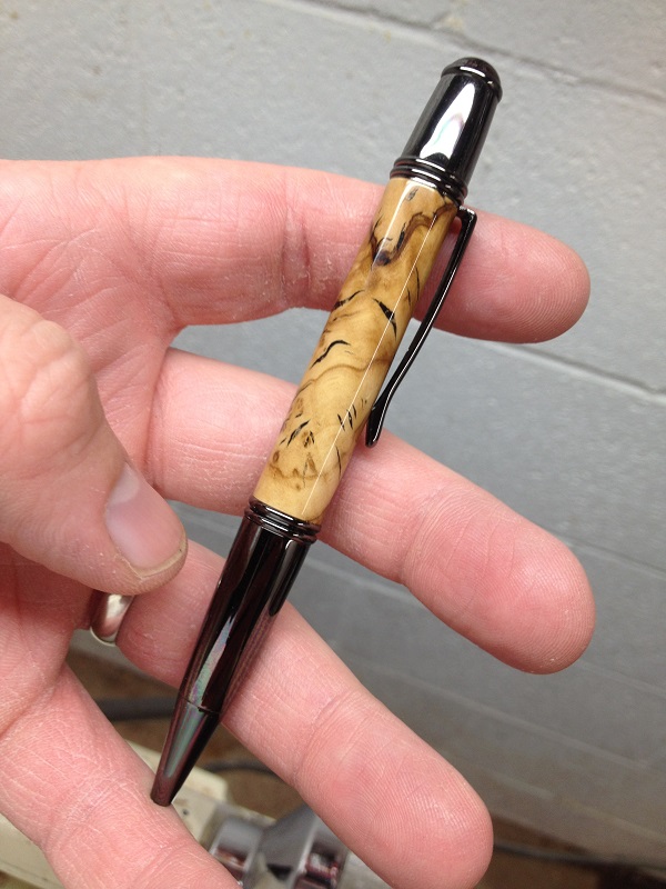

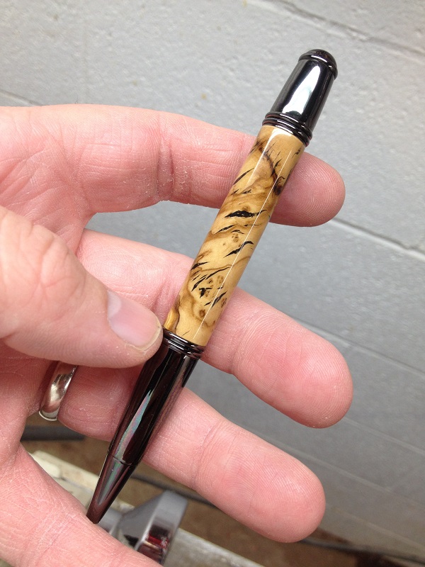

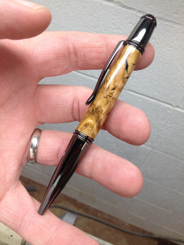

This piece of Olive Burl was perfect for something that I've been wanting to try for a while. I've been wanting to get a blank of some lighter colored burl that had checked while drying and was full of little checks. What I did from there was instead of glueing in the tube with clear CA like I normally do, I glued it in with black CA. This would partially fill some of the checks that were inside - and would ensure that when I got it turned down to size I wouldn't find checks filled with clear CA showing off the brass tube.
After turning almost to size, I filled in the checks with a few applications of black CA. After that I turned it down to size, sanded, and did my normal CA finish. The kit is a Gunmetal/Gunmetal Le Roi v. 2 from Smitty's.
I really really like how this pen turned out - it's probably one of my favorite pens I've made. I really like the effect of the black filling the checks on this piece of Olive Burl. Methinks I need to sometime get some more olive burl that was checked like this piece, especially since this pen will be on its way to a new home soon. I could have easily kept this pen for myself, but I made this pen specifically to give it to someone and am glad to be packaging it up and sending it on.
C&C welcome.

Thank you, everyone!
