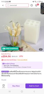

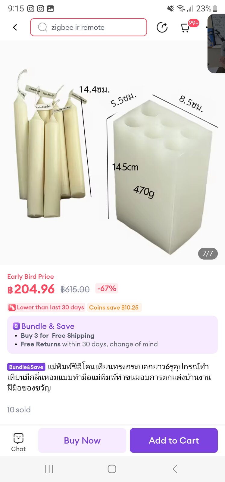

Attached photos from the sales page; you should be able to find these on temu/bangood/Ali. They are decent and around $10-12USD. I've had 4 successful casts so far with them.
My other cast mold was imported from the US; lasted about 2 casts and cost me around $90USD.

$204.96 for a mold? How many castings would it take to break even? Curious.
Not very many. At today's exchange rate 204.96 Thai Bahts(THB) is only about $5.60 (USD).
And buy 3 for free shipping! - Dave

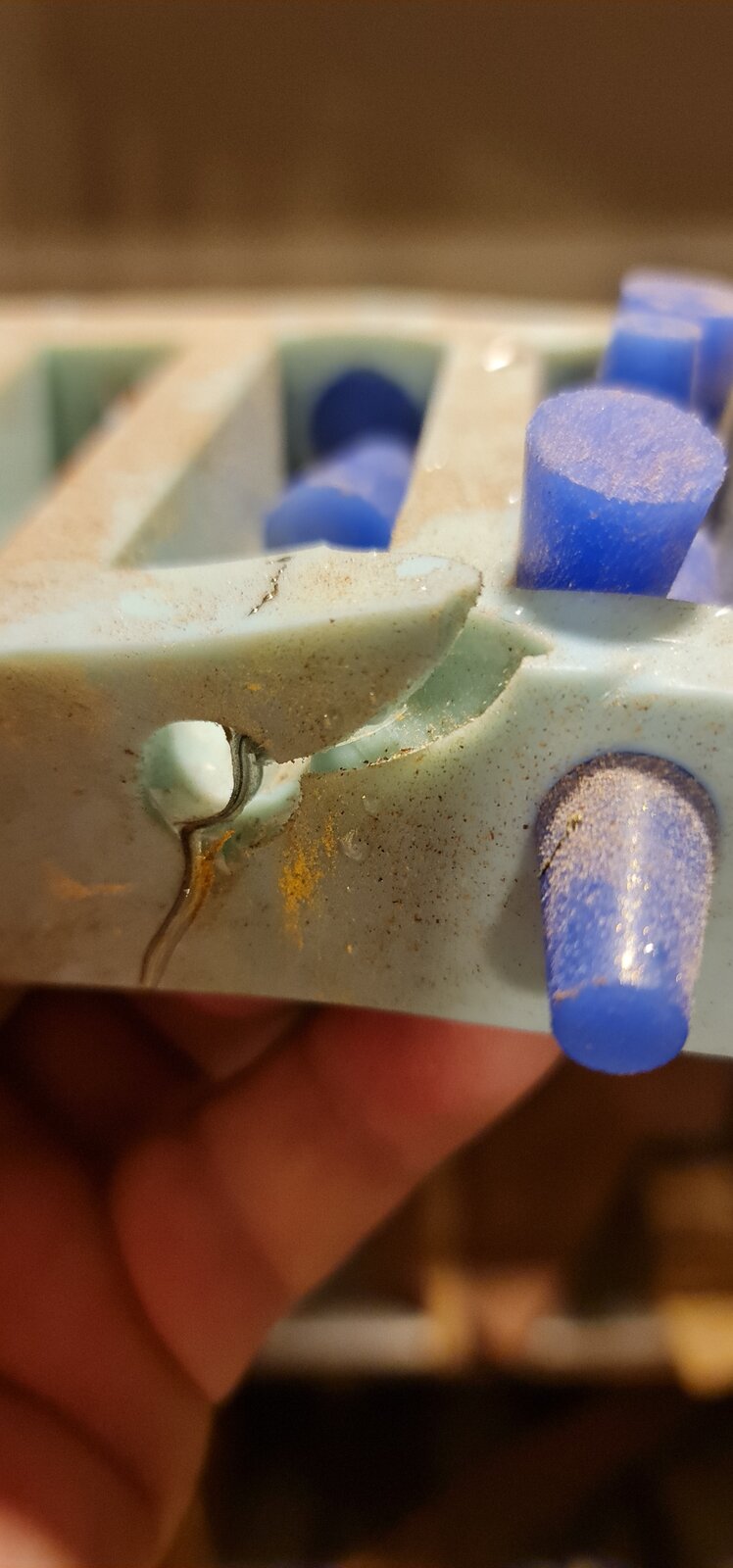

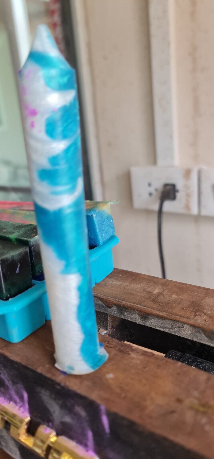

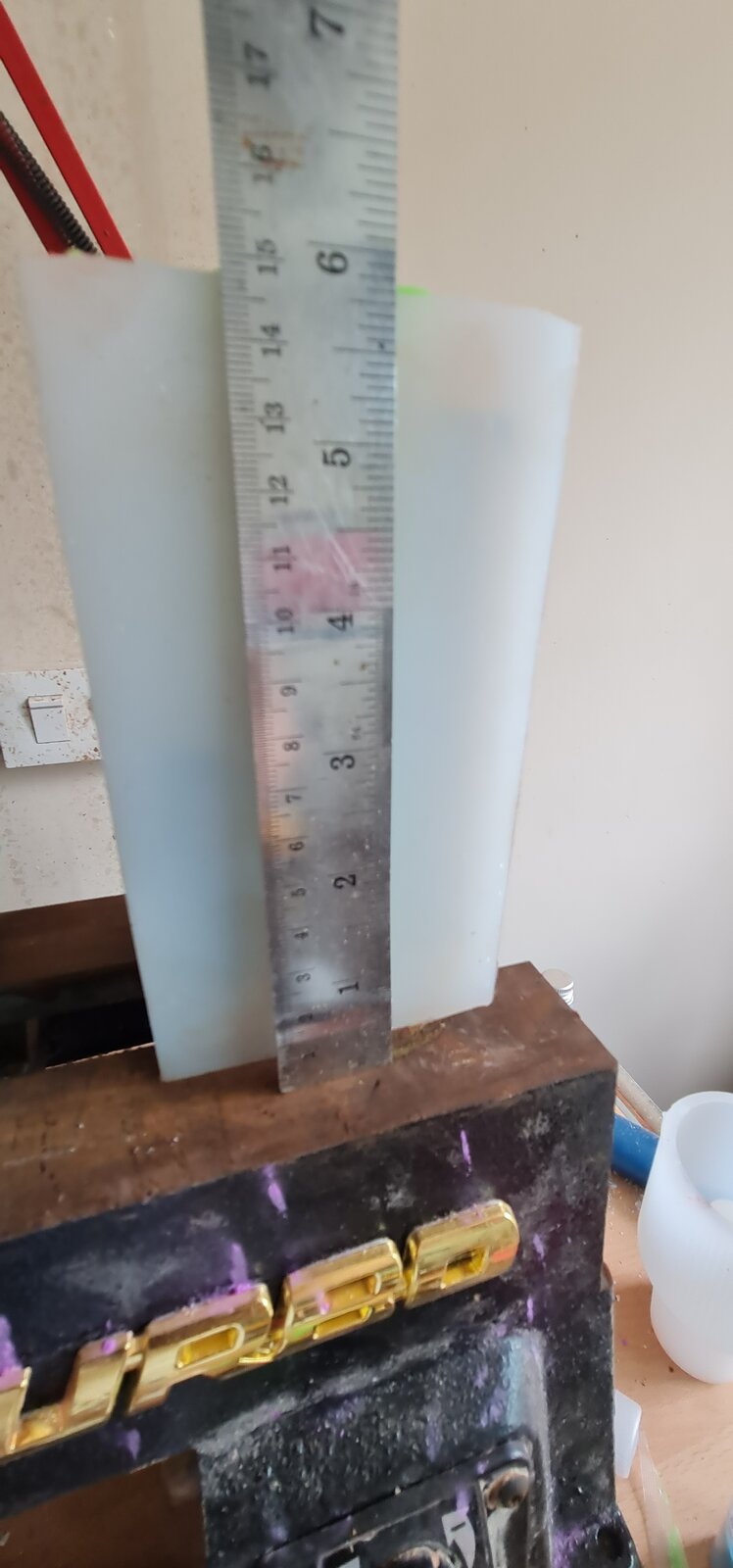

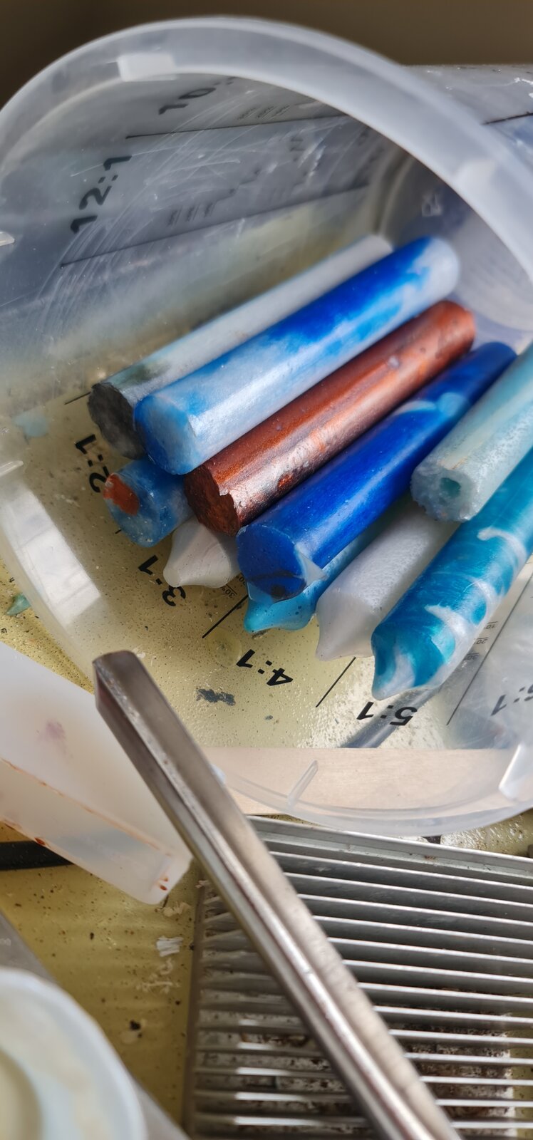

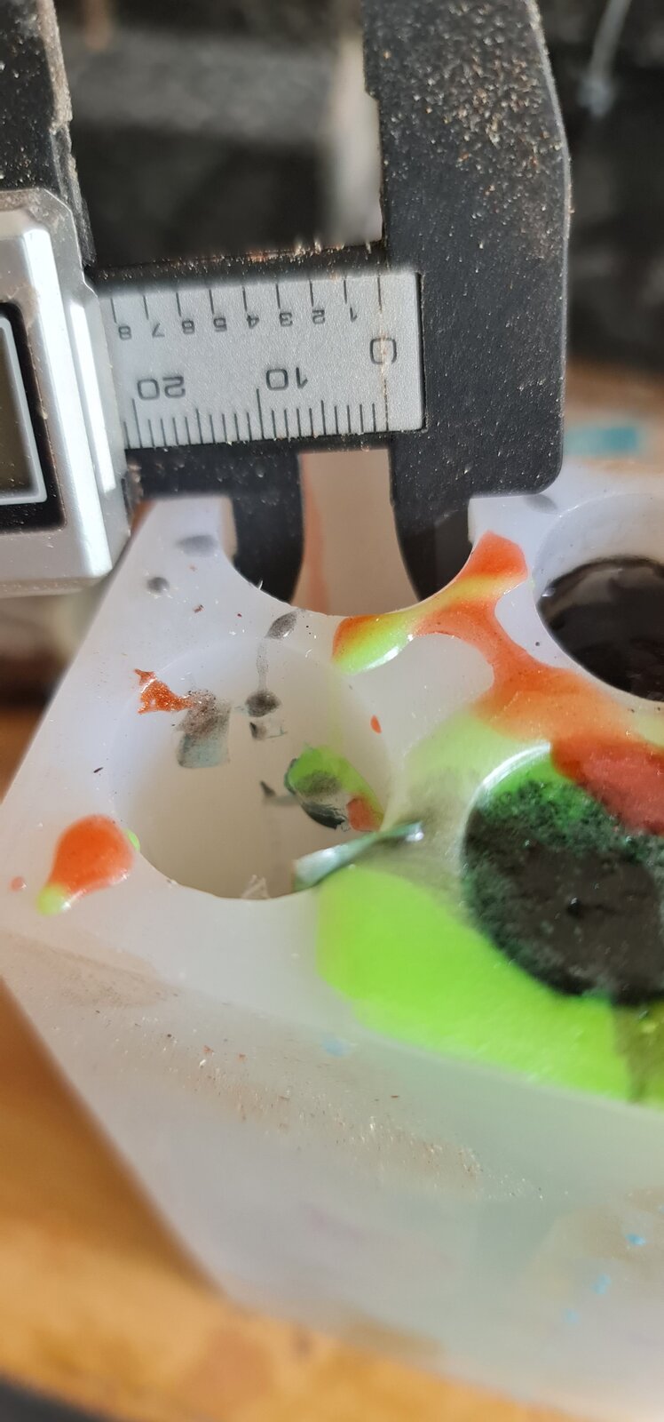

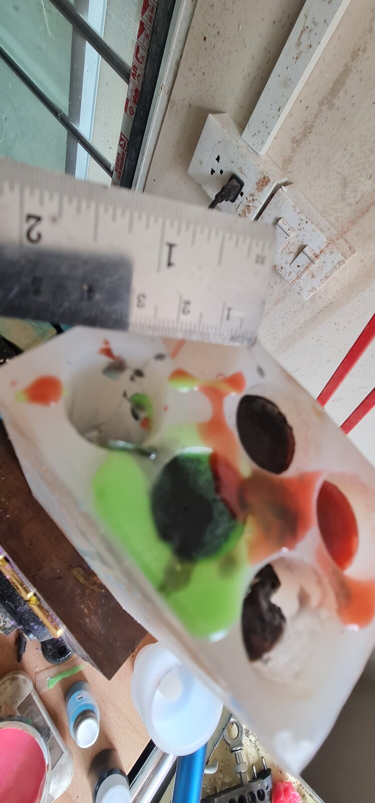

Noooooo dont pay $20... Keep looking on temu, aliexpress, banggood, taobao; they cost me around $5USD. Check out Aliexpress "choice" they usually have a deal where if you order 5 items there is a large discount. Or add it to your aliexpress cart and logoff; they will drop the price and annoy you via email for a few days.
I have 16 pours now; the mold is still good; but nothing lasts forever. I ordered a few more because I would really like to convert them to "tube in" with a brass rod
About 20mm. I have been pouring all day; polyester resin + cobalt + MEKp... no cure inhibitions or weird reactions (so far). I was using different ratios of mekp, this mold literally smoking hot and it is fine.
words of caution;
1. this is actually a very soft mold, so you cannot lean it and pour on the side; the blank will come out bent. I would avoid sticking sharp objects in the holes to mix around the resin.
2. The only way to demold this is with compressed air. Use caution when demolding with compressed air; the smoking hot blanks shoot out like a m777 howitzer!
3. The polyester casters; this is a deep pour for polyester resin and they get real hot; there has to be a temp limit on these; I have not found it yet.. since it was designed for hot wax I AM GUESSING 200-250C.

PVC vs polyester resin never worked well for me; I tried the blue pvc, grey "UVPVC", black pvc (used for sprinkler systems). I prefer these cheap silicone molds at $5USD the mold is actually cheaper than a can mold release spray.

I just demolded a batch without compressed air; i had to pull and twist and they came out kinda easily.
