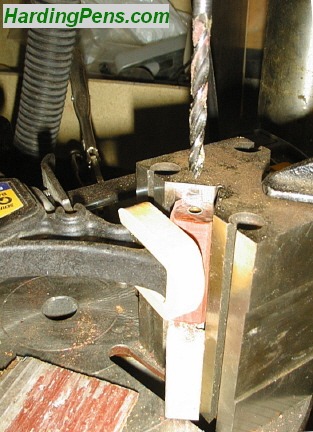

Until someone took pity on this doddering old fool and blessed me with a vise I used a setup very similar to this pic (not my pic).
The only thing is my DP kind of became a permanent setup like this.
The machinist vise is also a HF item and it was like $5.00 on sale.
Turn the table 90º bolt the vise to the table.
I use a rod from an old shock absorber I cut off with my dremel to center the vise and the chuck. I also use this same rod to align my TS on the mini-lathe.
