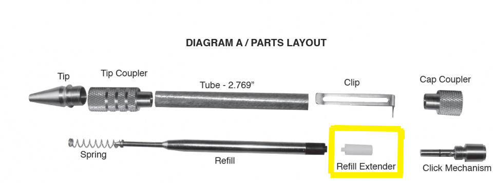

In my search for lightweight pens, I've just gotten a batch of the new Dura Click pens from PSI. My initial impressions are favorable; there's enough weight so it doesn't feel "cheap", but it's comfortable to hold and write with.

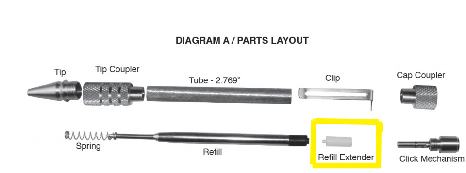

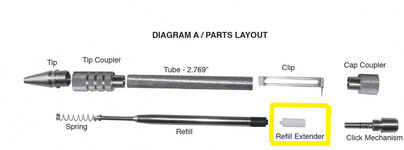

My only concern (and this has been mentioned in another thread) is that the pen uses the mythical "refill extender" as shown in the photo below. So far I can't, can't, can't find a place to order extras in case one gets lost. Before I start trying to modify things, has anybody EVER been able to come up with a source for these adapters?

I guess one COULD turn them, but they're awfully tiny. It'd take more skill than I currently have... Possibly an adapter could be made for the Schmidt click mechanism and either epoxied or press-fit.
Is it possible to get longer refills and do away with that part?? Do you have measurements of the refill with and without that piece??
JT, the refills are standard Parker type. I'll have to go over to the refill database site and search for other refills.
Seems like I recall that Monteverde made these extenders at one time, but so far I can't find them now.
Go to a stationary store and buy some Unibal 207 refills or get them online. They should be long enough so you can eliminate the extender. On the old style Sierra Click they had the same little extenders in metal that you could leave out when the Unibal was substituted. They write better and the ink can't be washed out of the paper like crooks used to do to alter the amounts. For what it is worth we never lost one of those spacers when using them in the pen. If you're selling them show the buyer how to change the refill so they know they are in there and won't loose it.
They really aren't very hard to do. True they are small, but give it a try. I'll bet you can do it. They main drawback might be tools. You will need some sort of chuck to hold the blank. You could use a carbide tool, or a parting tool to turn the part.
I think an adapter would be harder to make than the extender.
I have a PSI that has a similar adaptor. (don't remember which one). He's my unwanted .02. Are we too concerned with something that might most likely will not happen. But now I'm curious...can someone post a good close up with dimensions. I'd like to see what I can come up with.
Also contact PSI and ask if they can stock x amount of extensions and sell as 3 or 5 packs.
A "refill extender" doesn't need to be made out of metal. Nylon or delrin (aka acetal) would work just fine and would be easily turned (including the little nipple) with wood tools.
You don't even have to have the nipple, but the extender is much more likely to get lost if it isn't stuck to the refill when pulled out, but probably no worse than the spring. Of course, if it's not stuck to the refill it's less likely to get tossed with the empty refill by a user that isn't paying attention.

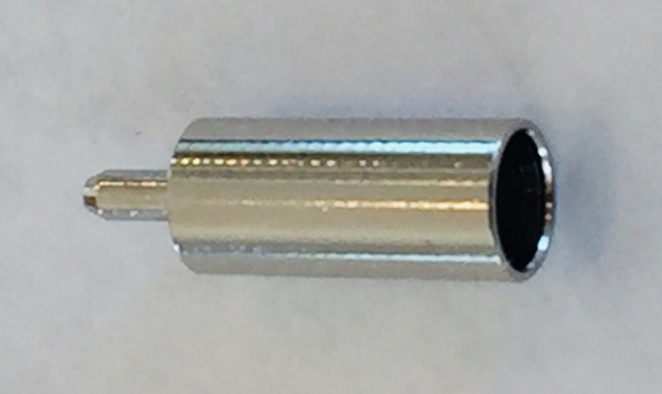

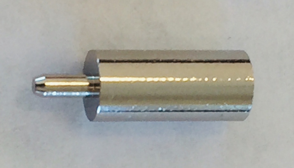

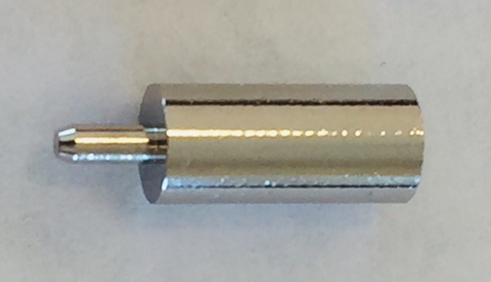

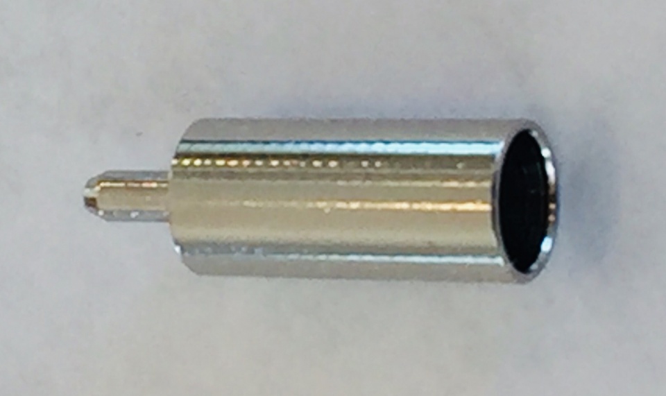

I found one of the metal ones from the old Sierra Clicks. At one time we had handfuls kicking around from pens we put the Unibal refills into. I haven't taken any dimensions because this new pen may differ. These were drilled out to reduce the weight I think.
No they wouldn't have to be duplicated in metal if you wanted spares. I think the new pen has them in plastic because of ease of manufacturing them.

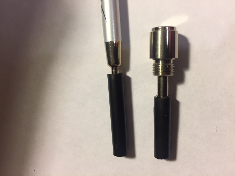

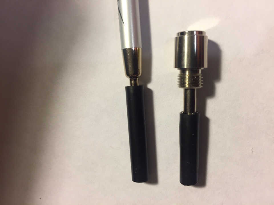

Here's an idea. Cheap too. Use the plastic piece that comes with the Schmidt refills. Trim to length and press it onto the clicker. Press it until it stops against the c-clip. I don't have one of the pens together yet to determine the actual length. Guaranteed the piece won't come off.
