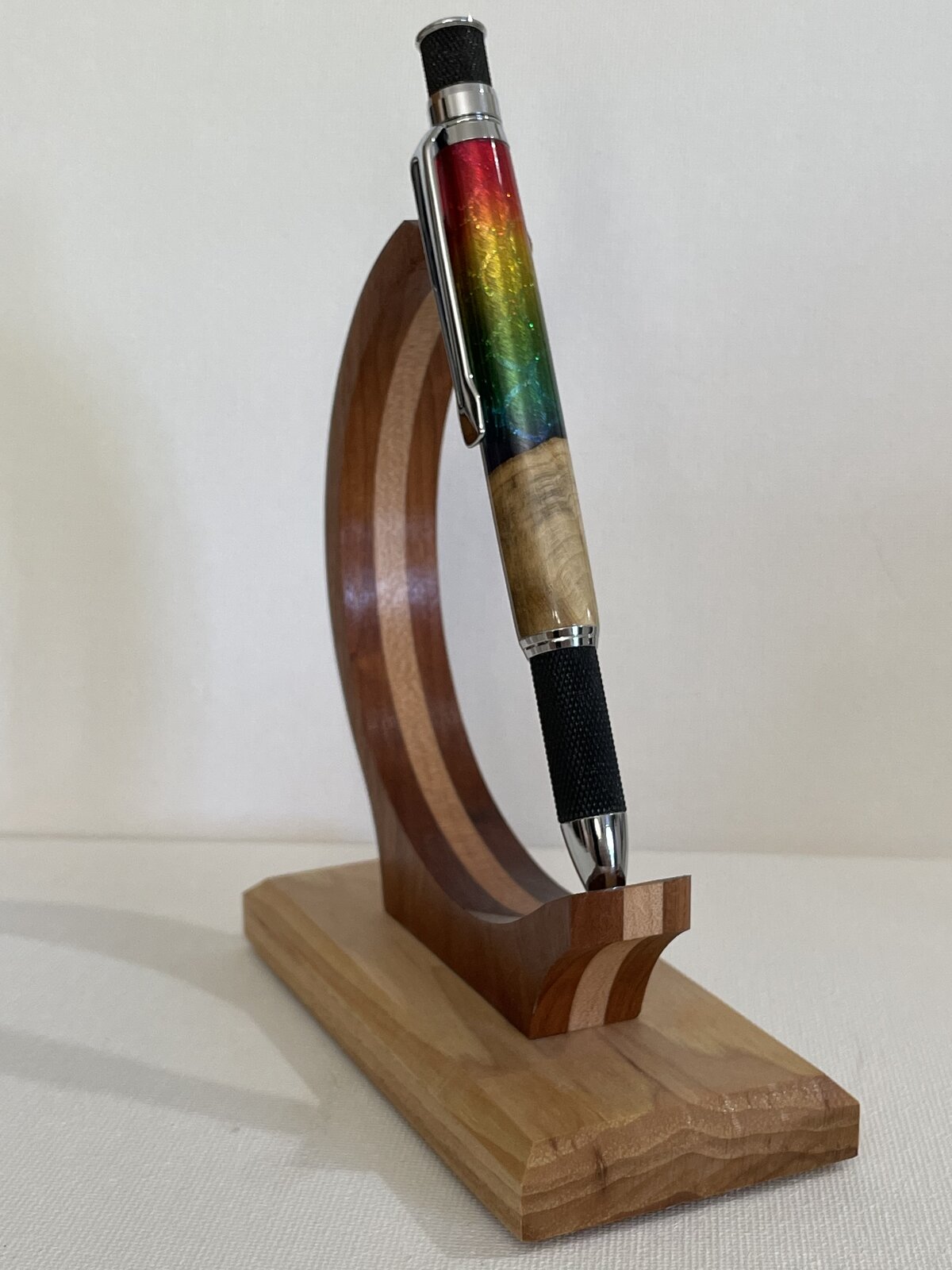

Original Knurl GT, clear cast by me using liquid diamonds. I have to say this is a very attractive pen. If you zoom in, it almost looks like you can see the brass tube but it's just the design on the backer material.
Your still doing impressive work Ken. If I'm not mistaken it's a hybrid blank with a live edge on the wood. If so I'd like to hear how you did the seam between the wood and resin. Thanks for sharing
Kenny I just counterbore the hole about a sixteenth deep and then just slide the tube in just until the backing material is in far enough that the brass tube doesn't show.
