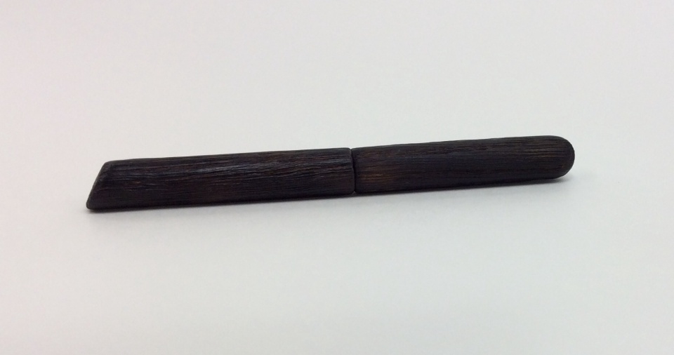

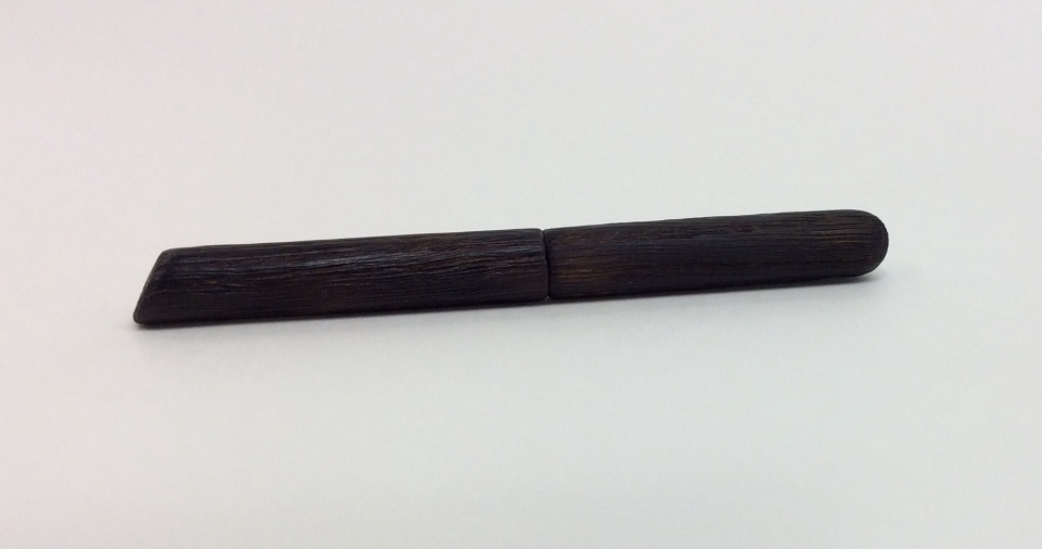

This pen was created by torching some red oak, wire brushing, repeat in the process and burnished with a nylon brush. Sprayed with satin Lacquer....just enough to seal the burnt smell and give some finish but not build up and be noticeable.
Again, not sure what look you are going for but an option.

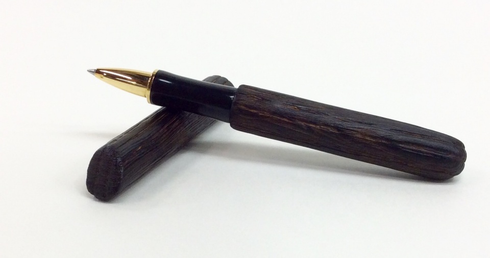

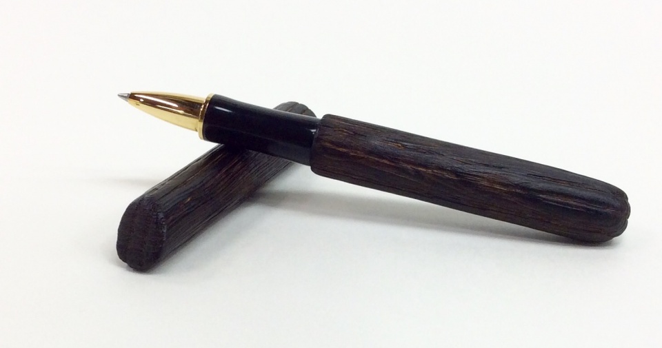

Hey Mal,
I'm not wanting to hijack Bubba's thread but the short answer is yes, it is a Zen Kit. The cap has the clip and corners ground off and is buried deep in the wood cap. The magnetic cap still seats as it normally would. The cap covers the section completely. The section is black ebonite.
I wanted the texture of the torched wood to be counter balanced by the smooth sleek surface of the ebonite. Sort of a fountain pen look with the grip section. It ended up with a disproportionate appearance (according to some) as the cap is longer than what is considered "normal proportions" for a pen.....but I still like it!
