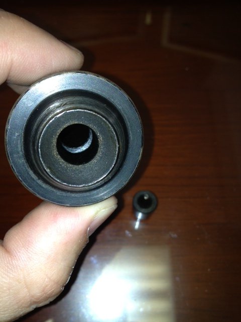

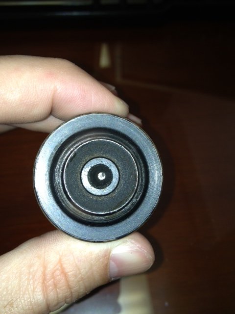

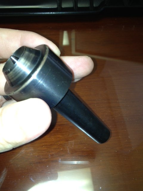

It is a hollow MT@ and the tip looks as if it can be replaced by others. Anyone know where you can purchase additional and different tips? Pics attached and thanks

That looks like the stock live center from Jet. Don't use mine very much, never even realized the point came out. Usually use a 60 degree live center. Woodcraft sells one that looks a lot like it ($18), but I do not see any replacement points.

This center isn't a true 60 degree center. Our mandrels have a dimple for a 60 degree center.
Levi Woodard
Sent from my DROID RAZR using Forum Runner
What Levi said. You can possibly make due with it but it's not the best
Also, it may or may not have unacceptable runout. I've not tested my stock live center as I hardly ever use it.
