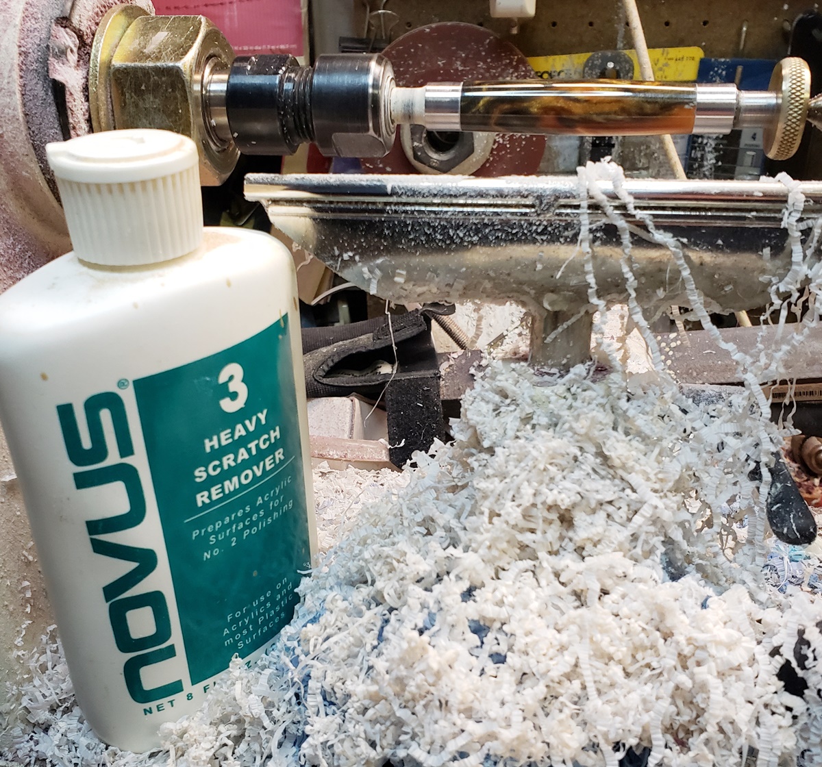

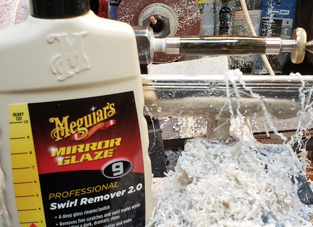

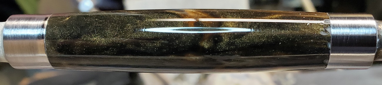

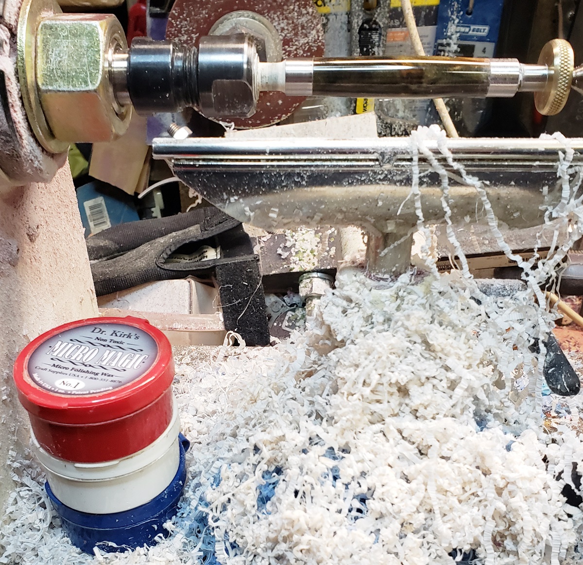

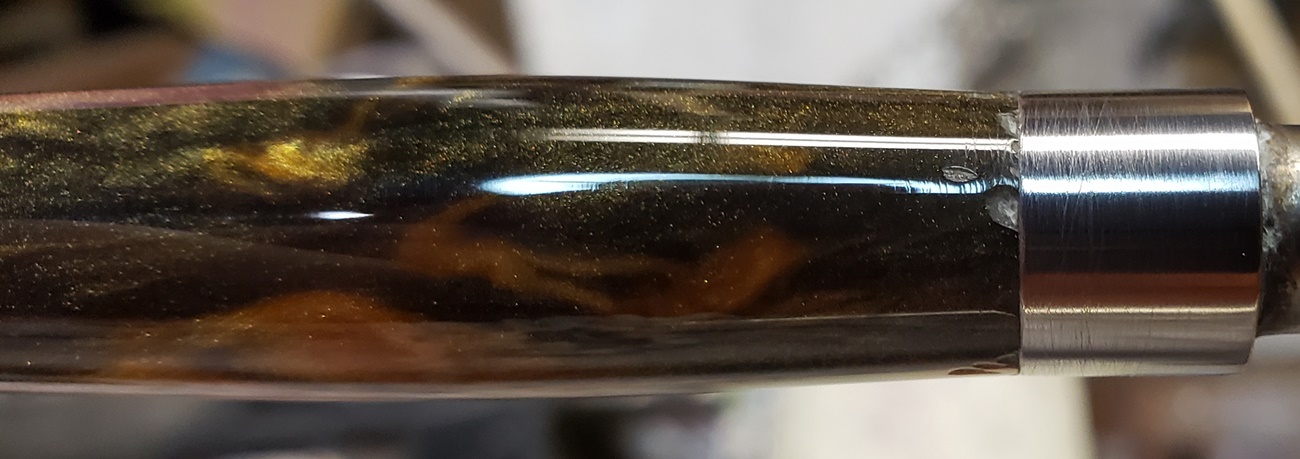

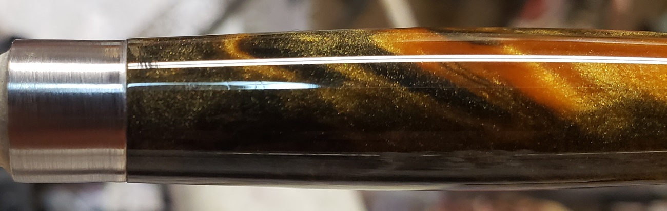

I get a decent polish on my acrylic blanks, but if you look close, there are always micro scratches. I tried some buffing pads my detailing friend uses, but they weren't any better. So I decided to try lambskin chamois. I figured if it's good enough for a Ferrari, it should be good enough for a pen, right? If anything, it left worse scratches. My regimen is wet sand to 500, then Novus 3, Dr. Kirk's, PlastX, and finally Meguiar's swirl remover. Could speed have anything to do with it? I usually turn and polish at 2000 rpm. Slower? Faster?
I tried all of these and then another 10 or more. Until I was able to turn only very thin, shallow tool marks (heavy radial scratches), I never achieved the level of finish that I was looking for (invisible with a 20x loupe). I saw videos recommending the elimination of low spots by ensuring that material was completely covered with "saw"/acrylic dust before proceeding to the next finer grit. I was doing that, but still was not satisfied. After buying a microscope , I saw that the sanding dust was accumulating in the fine tools marks. This is just my experience. I attend many shows/craft fairs and most pens that I see have fine radial scratches (I never say anything of course). Apparently, it doesn't hurt sales and the turner is quite happy.
I have used it, and still do. I can not say that it will improve on what you are already using, because I can not see the really tiny swirl marks that it leaves. I do however, wet sand up to 600 or even 1000 grit then use all of the Micro Mesh grits with water. Then I go to the plastic polish.
105 cuts the most, then 205 (I called Meguiars and asked them). I only use it now if I am going to use MM.. But I only use MM when turning M3 and Trustone.

Ii always follow the Novus 3 with Novus 2 before PlastX.
I use these polishes on the lathe, but rotating the headstock by hand .... not under power.

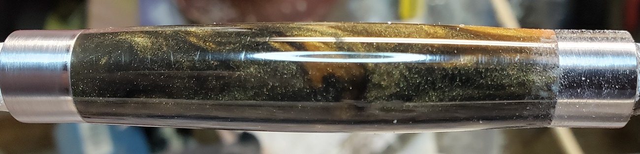

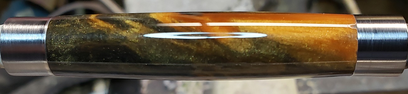

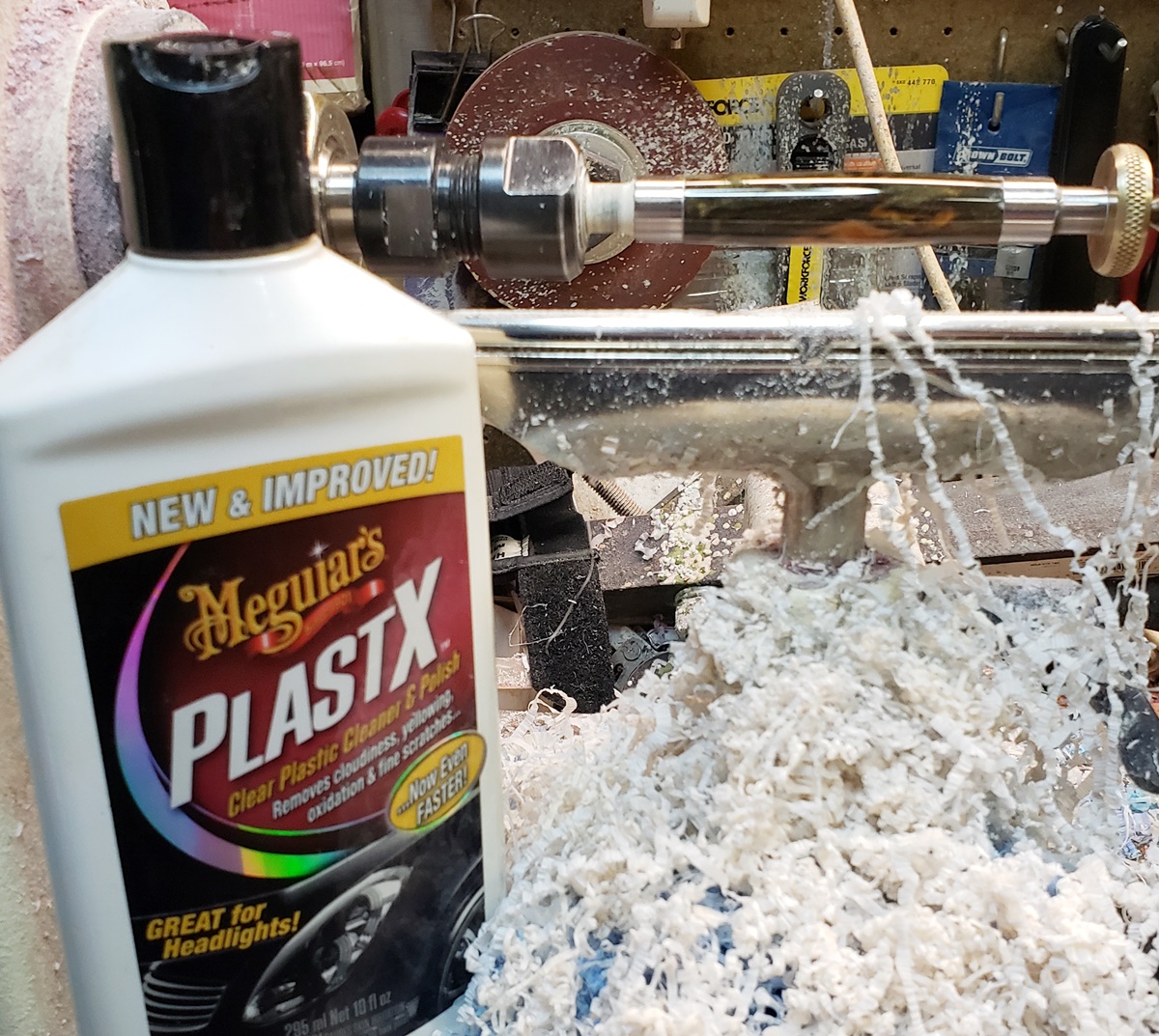

I tried it again with microfiber. This time I used Novus 3 and 2, Kirk's, PlastX, and Swirl Remover. I think it's actually better.

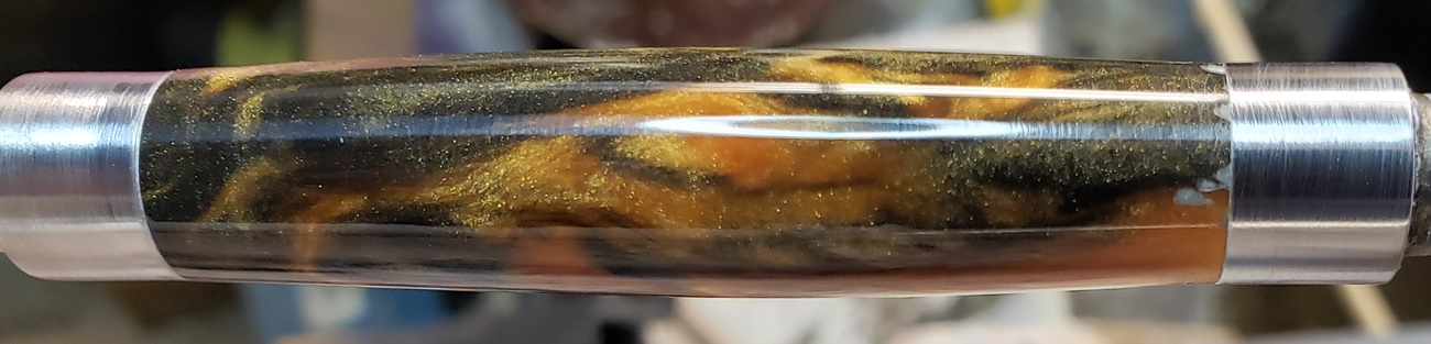

I don't understand how more light would reveal less scratches. I have 4ft and circular fluorescents above my lathe, and a 4ft fluorescent and 4ft LED behind the lathe. They definitely reveal the micro scratches that I'm trying to eliminate.

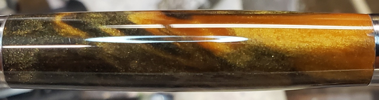

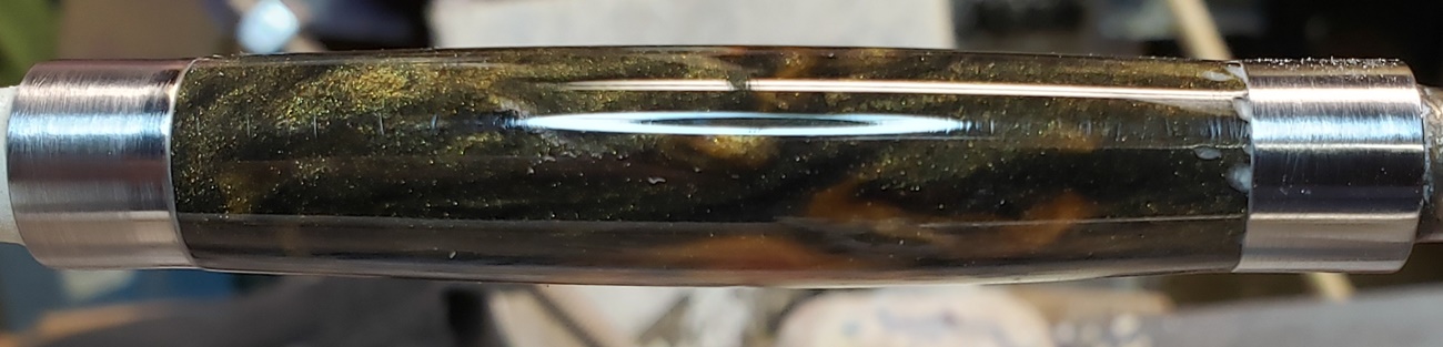

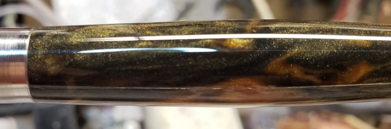

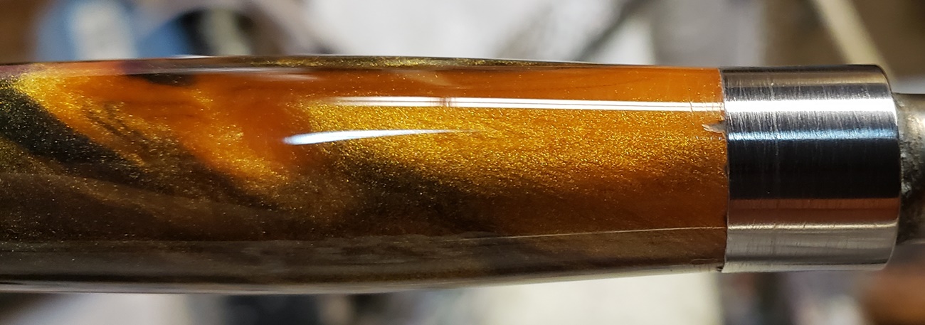

Cute dog! Golden retriever?
Thank you, yes. She is our 5th golden; first female though.
Separately, those scratches are too deep for most polishes to remove. They are like 240 to 320 grit scratches. I would:
start sanding from 240 at 800 to 1000 rpms (don't want to heat-up the acrylic.)
wet sand or dry sand through 2,000 (600, 800, 1000 or 1200, 1500, 2000...HD Lowes has plain old Norton's or 3M)
The run through your MM (1000 rpms wet).
At this point you should not have any visible scratches unless you examine very closely or with a loupe.
Then hit with 105 and 205 or a plastic polish. Get a cheap 10x lighted loupe. I have 3 (LOL).
Make sure your clothes are clean (no trapped dirt). I keep mine in a sealed plastic tub. I use once and discard.
You can get to where you want to go...it will just take a little experimenting. :-)

Perhaps you have already tried this, but are you performing any sort of final abrasive step laterally on the surface? Meaning, polishing in the perpendicular direction of the radial scratches.
I also MM up to 12,000, but I always have very fine scratches around the blank. To remove these scratches, I take it to the buffing wheel and buff it up and down the blank as opposed to around the blank. After this buffing stage there are no scratches detectable by the naked eye, assuming I did my MM routine well enough.
In my opinion, you are not using enough 6000, 8000 and 12000 MM. I do see the scratches that are deep enough which "finish" sanding will not get out, at least in the techniques that you are using.
Something I rarely see related to this is "technique". One should spend more time with each successive use of each MM grit. I would also say that you use too course of a grit to begin with, and each succeeding grit does not take out the original grit's cuts into the finish. I am basing this on looking at the picts in post 18. Couple this thought with the paragraph below:
Another suggestion is to go to TBC. Look at the ends; when you get to the ends, it looks like you are instinctively trying to avoid the bushings, and in doing so, you are not finish sanding the ends to the same extent that you are the middle parts. With TBC in finish sanding, you can spend as much time as you want on the ends and not have to worry about the bushings. Use the bushings in TBC to get close to size, and use a set of calipers for perfect sizing, then take the bushings off for finish.

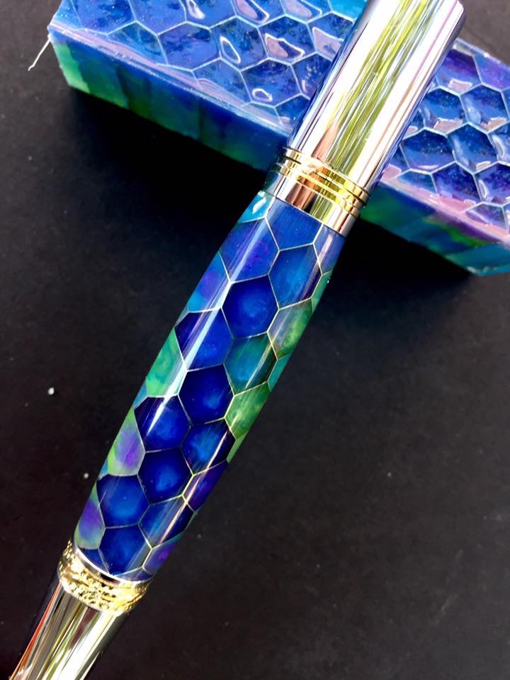

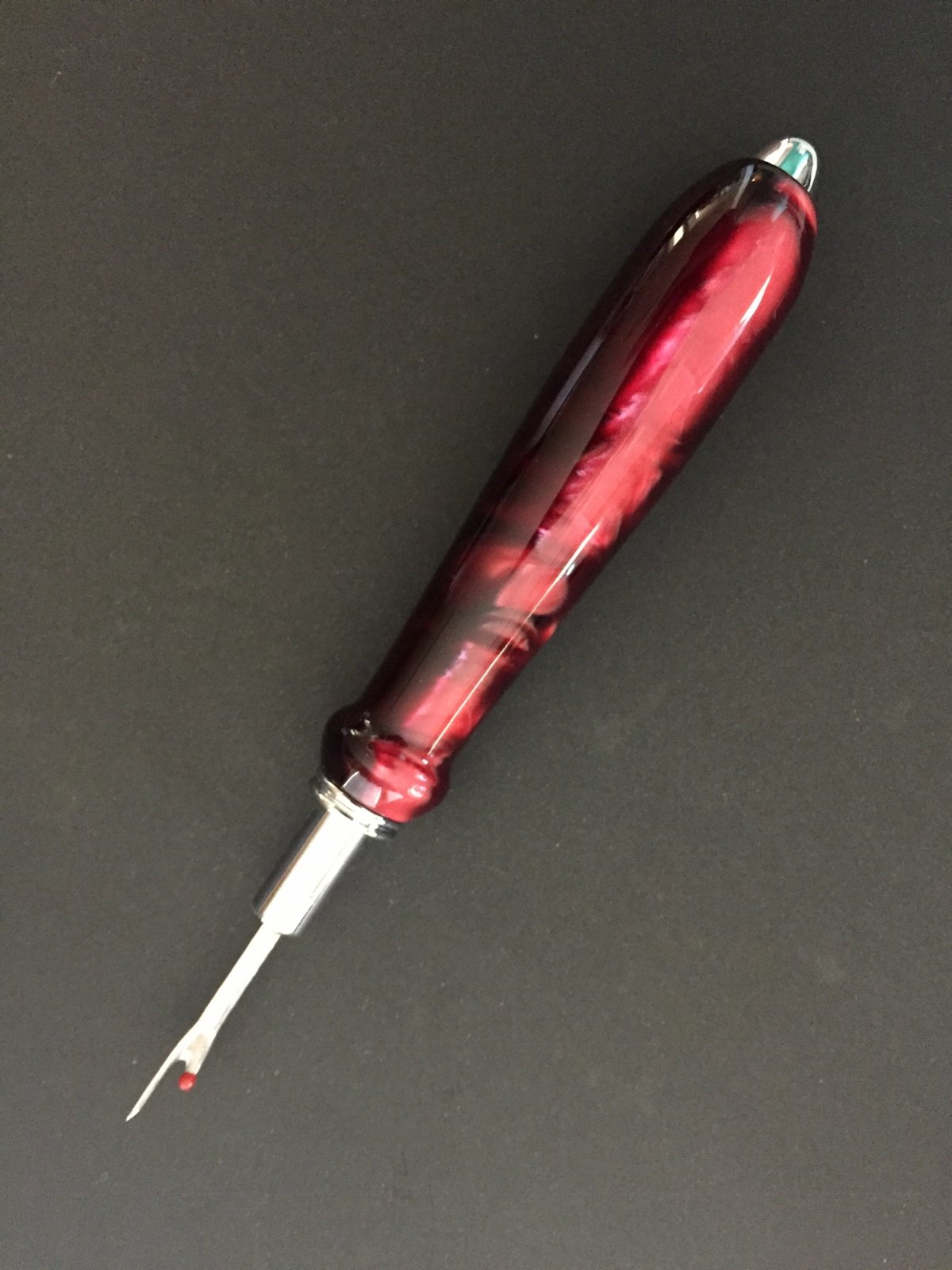

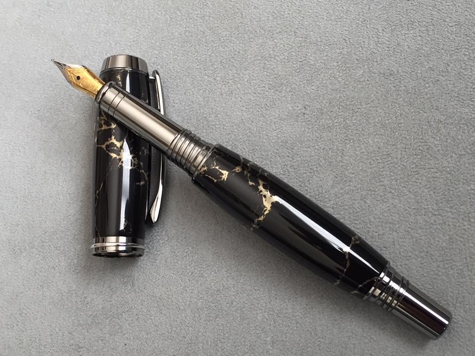

Here are a couple of examples. Sanded dry through 220 and 320 then wet at 500 then wet with MM through 1200-12000 following up with Pink rouge on the buffer.
I always start sanding lengthwise with the lowest grit, and as said above, most critical has been the 500-600 grit sanding. Also try doing this lengthwise to make sure you get all the turning marks sanded out.
