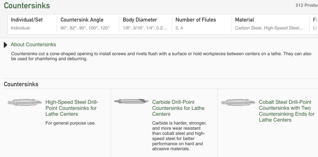

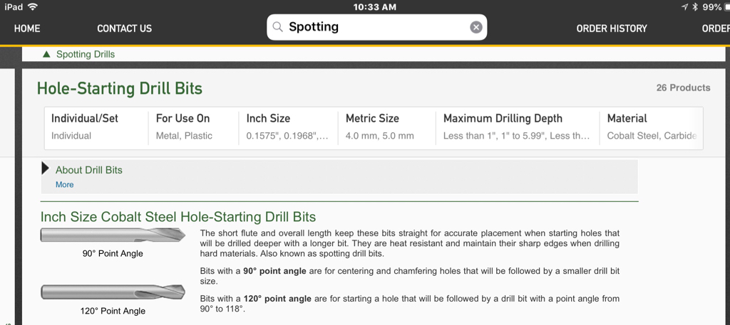

Charlie. The one I have (in pic) was not cheap but I only need one and have not had to sharpen it, used in all sorts of materials including soft metals. Bonus - MIUSA

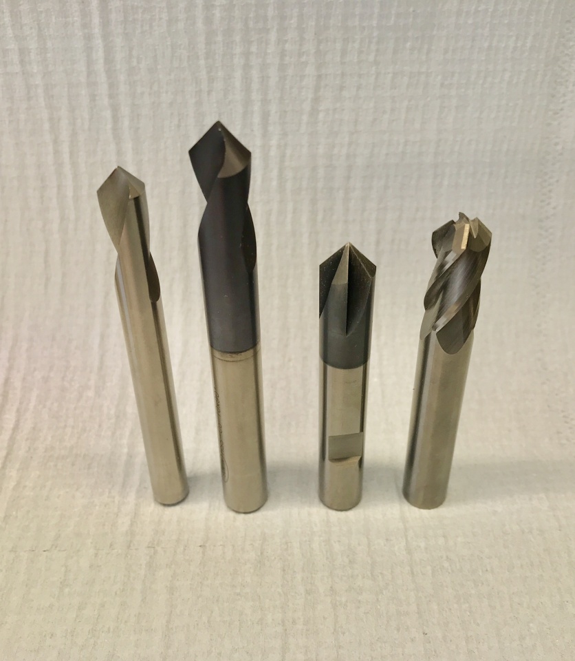

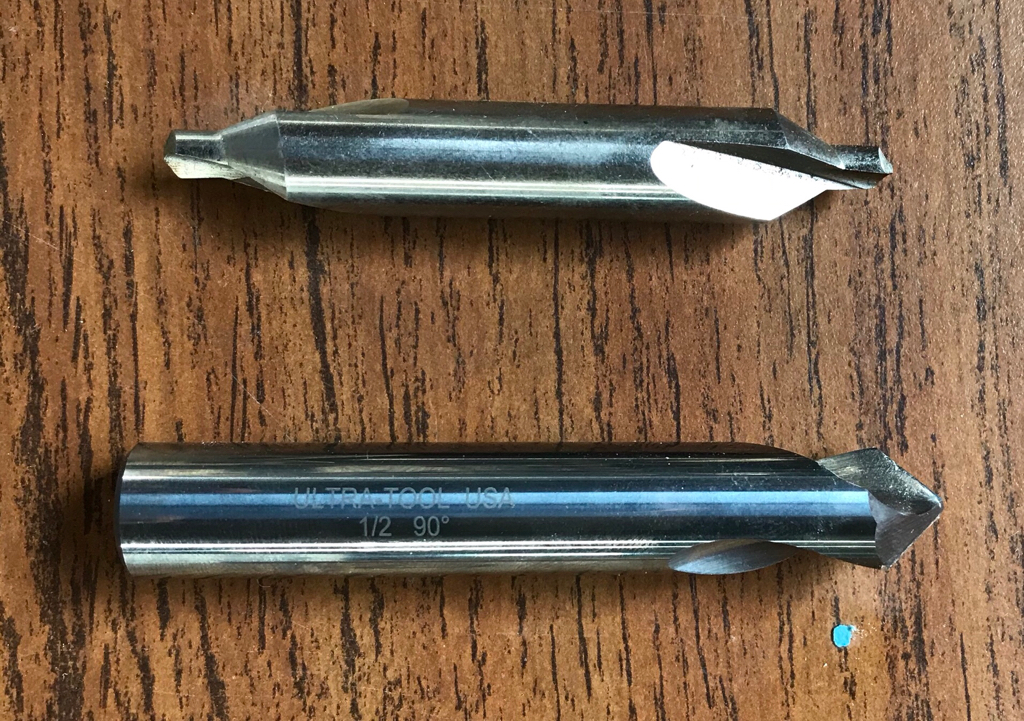

I've been using Spotting drills to start holes for many years. I used to use Centre drills but I had a hole in a brass bush end up slightly off so I made the switch. It's quite surprising how many machinists are unaware of spotting drills.
Attached picture shows two spotting drills on the left, then a drill mill and a chamfering mill on the right. :wink:
