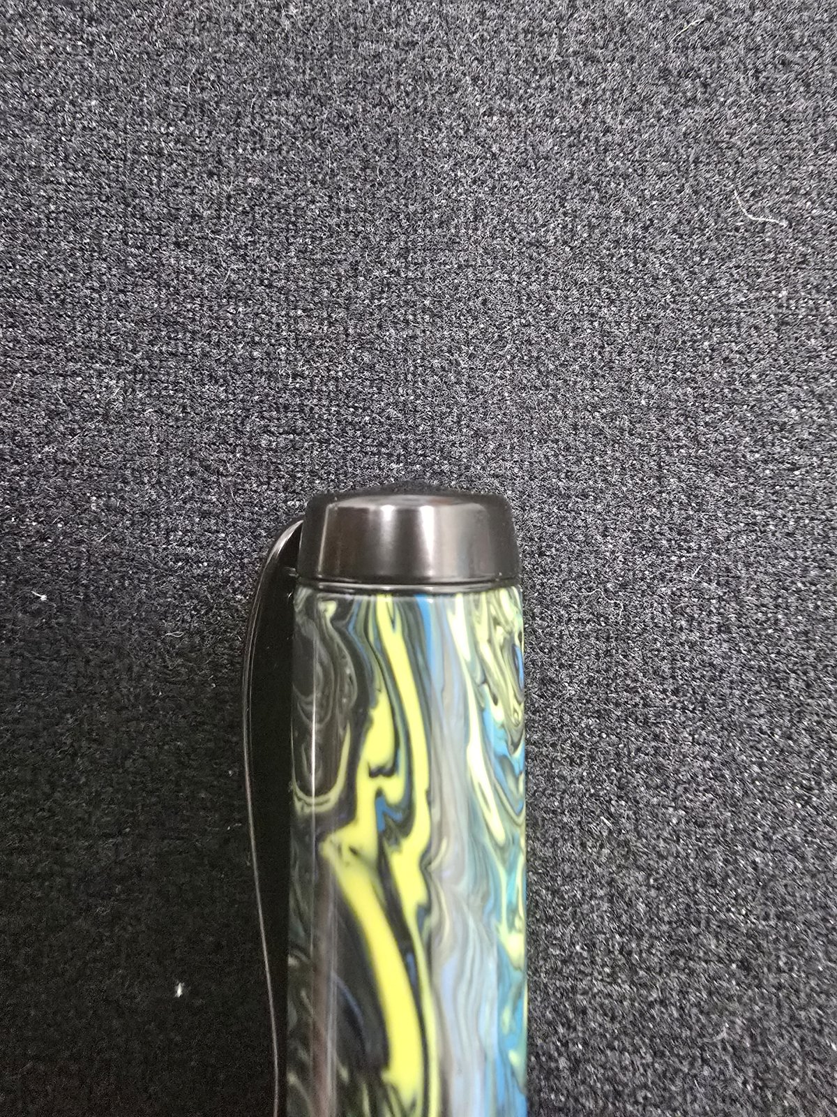

No chamfer, sharp corner where the hardware meets up:

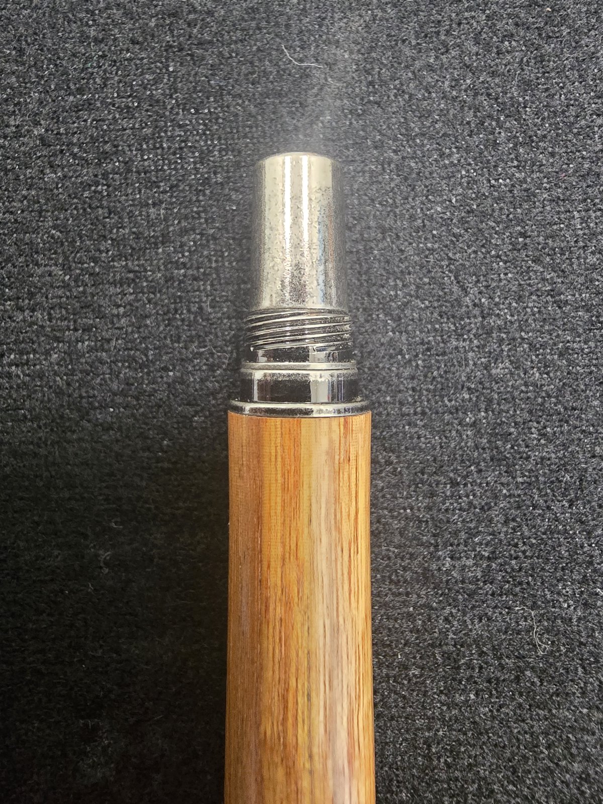

Slighly rounded edge to blend in:
It's really easy to do and I always do it during the sanding process after I remove any kit bushings and switch over to non-stick. A piece of 600 grit sand paper held at an angle gives it a really good look in my opinion. If this is widely known information, sorry for wasting your time, but I really wish I had known about or thought about this earlier, I wasted a lot of good blanks and kits and just don't like the fit up without the rolled edges.
