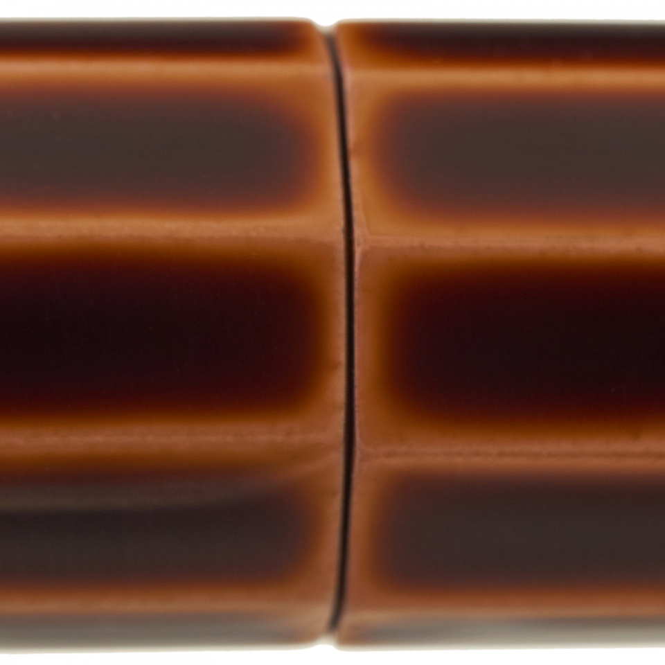

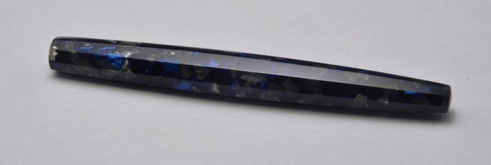

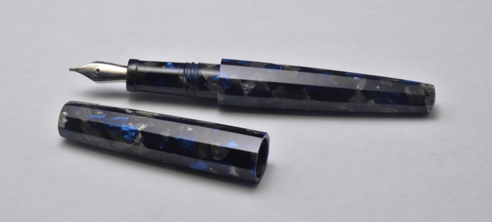

my goal is to make octagonal pen so that the lines of the barrel and cap go straight when the cap is closed, how can this be achieved with normal threaded cap?
attached is a picture to clarify what I mean.
You would need a quad, double or single threaded connector. With a triple thread you have a better than even chance they will end up misaligned when closed.
