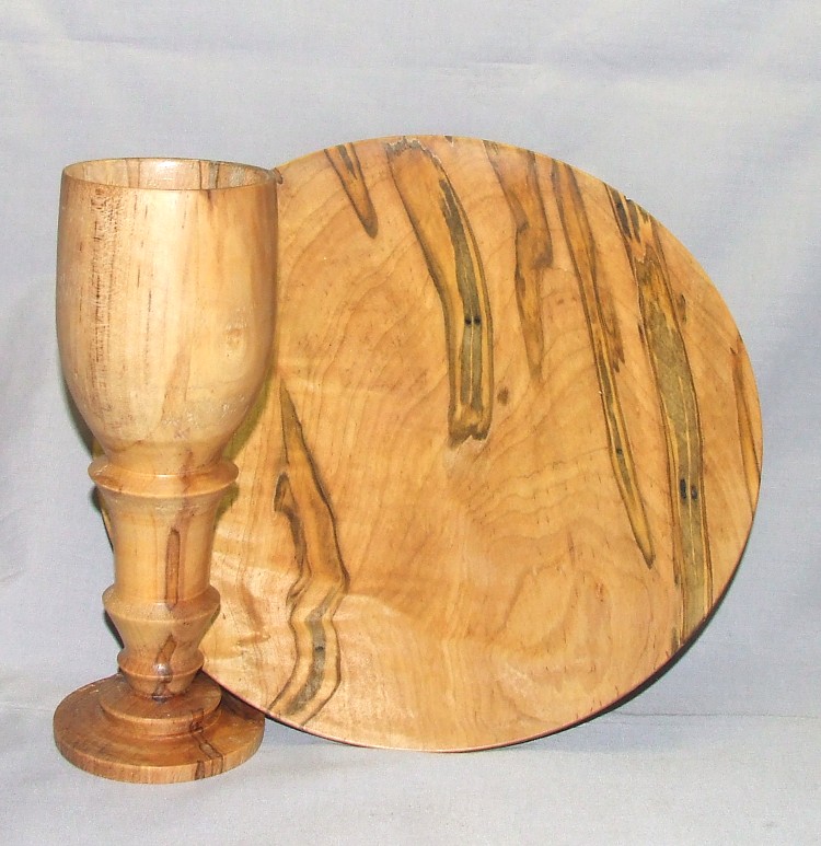

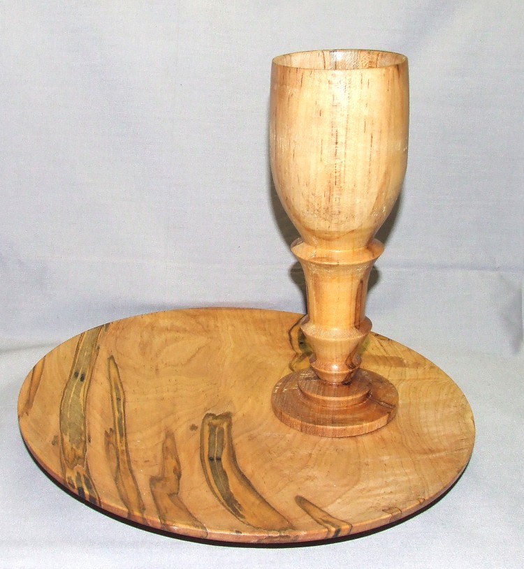

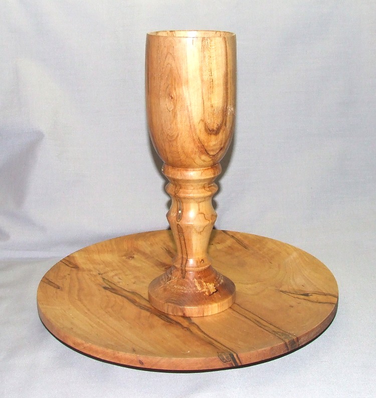

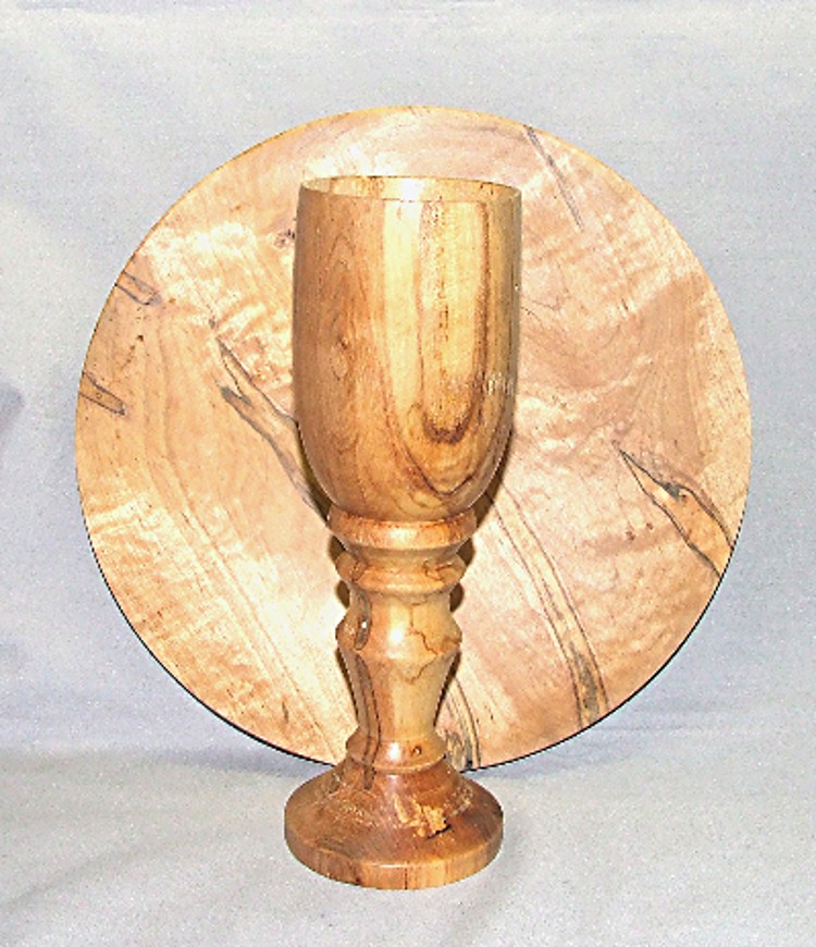

I'm not a big church goer, but I like some things about the churches... especially like the communion sets I see at some of the churches I have visited... here are a couple I finished this past week... I actually started them back in 2013... did the patens except for taking the tenons off the bottoms.... they sat on the work bench all of last year.... finally decided to try to finish and took a couple of pepper mill blanks to make the chalices....
the plates are both about 10 1/2" dia x 1 inch high. They were turned from
a 1 inch thick board.... the finish is tung oil and buffed with carnuba. The chalice's have a coating of a plexiglas solution inside so they are sealed and ready to be used.
