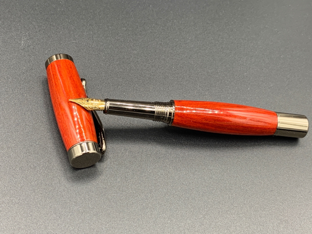

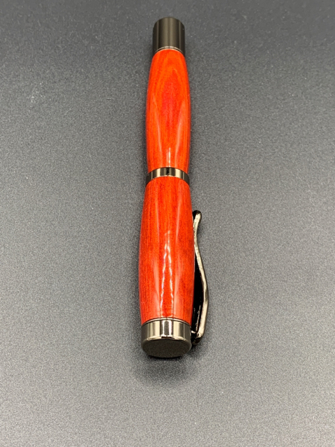

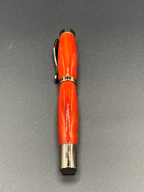

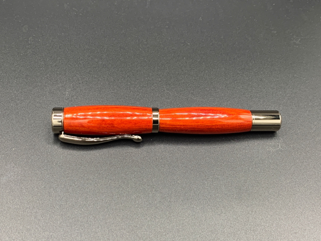

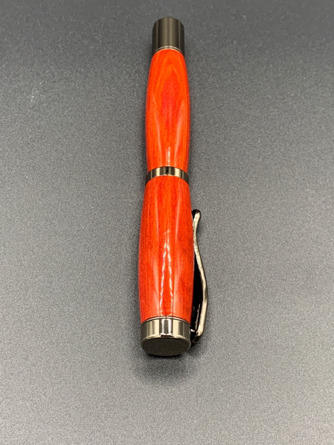

I got a new shipment of 15 Chakte-Kok pen blanks and while they are awesome red on the outside, when I shape them they turn bright Orange.
Is there any way to restore the red colour or will it return with age like purple-heart?
Here is a pen I made for my wife: (It isn't my normal bulbous style pen as it's meant for her smaller hands.)

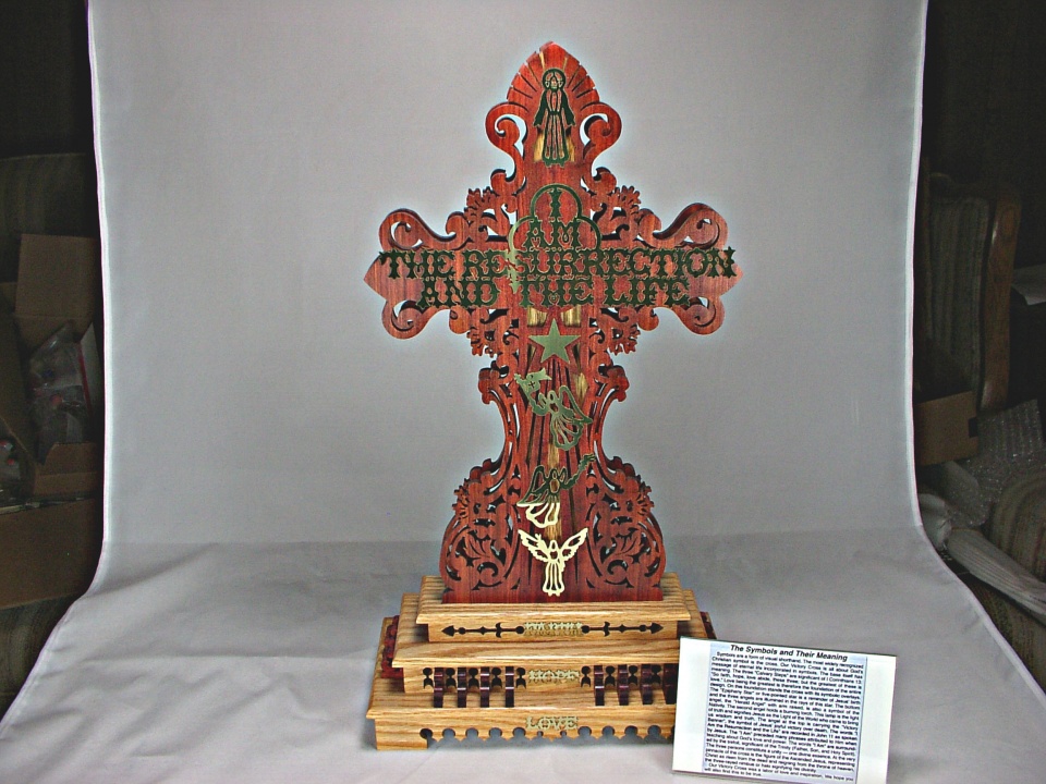

Here is an example of Redheart that I finished with a polyurethane with a UV inhibitor in it and it has held up for about 10 years sitting out and looks pretty much this way but maybe a shade or two darker but still red. My board was red from the beginning and stayed that way even sanded.
