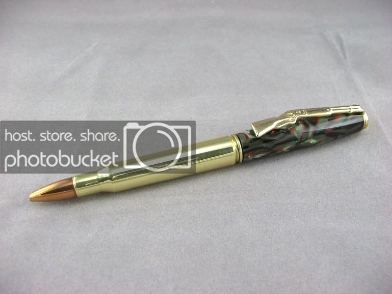

One of the guys at my local gunshop does this for a sideline.
About a year ago I got him to coat 3 x 30-06 pens and a 50 cal in clear for me as a trial.
It looked very promising. I sold a 30-06 and the 50 cal to a regular customer, he bought the 30-06 back about 4 weeks later because of a fault with the transmission, I noticed the finish didn't look too good, there were cloudy looking patches. I asked him if he stored the pen on the dashboard of his truck, as I thought it looked scuffed up, he said it had lived in his shirt pocket since he bought it.
I took it back to the gunshop to show them, the guy said it had been mistreated and there would be no warranty.
I ended up replacing both pens with ones that got my usual wax treatment and refunded the difference to the customer. the 50 cal didn't look too shiny either.
The other two 30-06 pens are in a plastic bag in a drawer in my shed they still look good.
I had high hopes that this would be my answer to clear finish for my cartridge pens, but I didn't like how it turned out, so have not had any more done.

Yes Cerakote. The guy did tell me that the product he used was the one for brass, there is another clear that is apparently for chrome that is tougher, but he didn't have any of that at the time. I told him to give me a call if he got some and I would trial that. Have never heard back from him.
