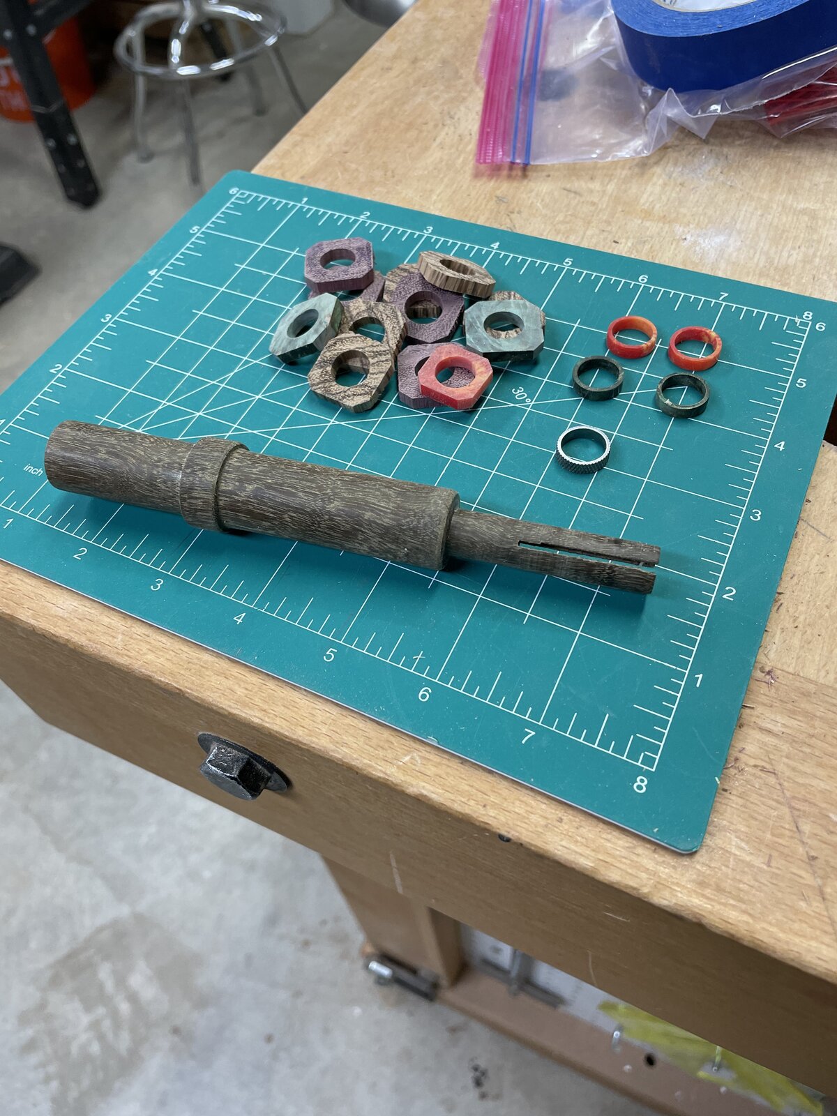

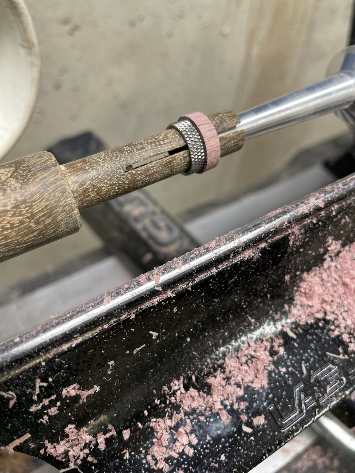

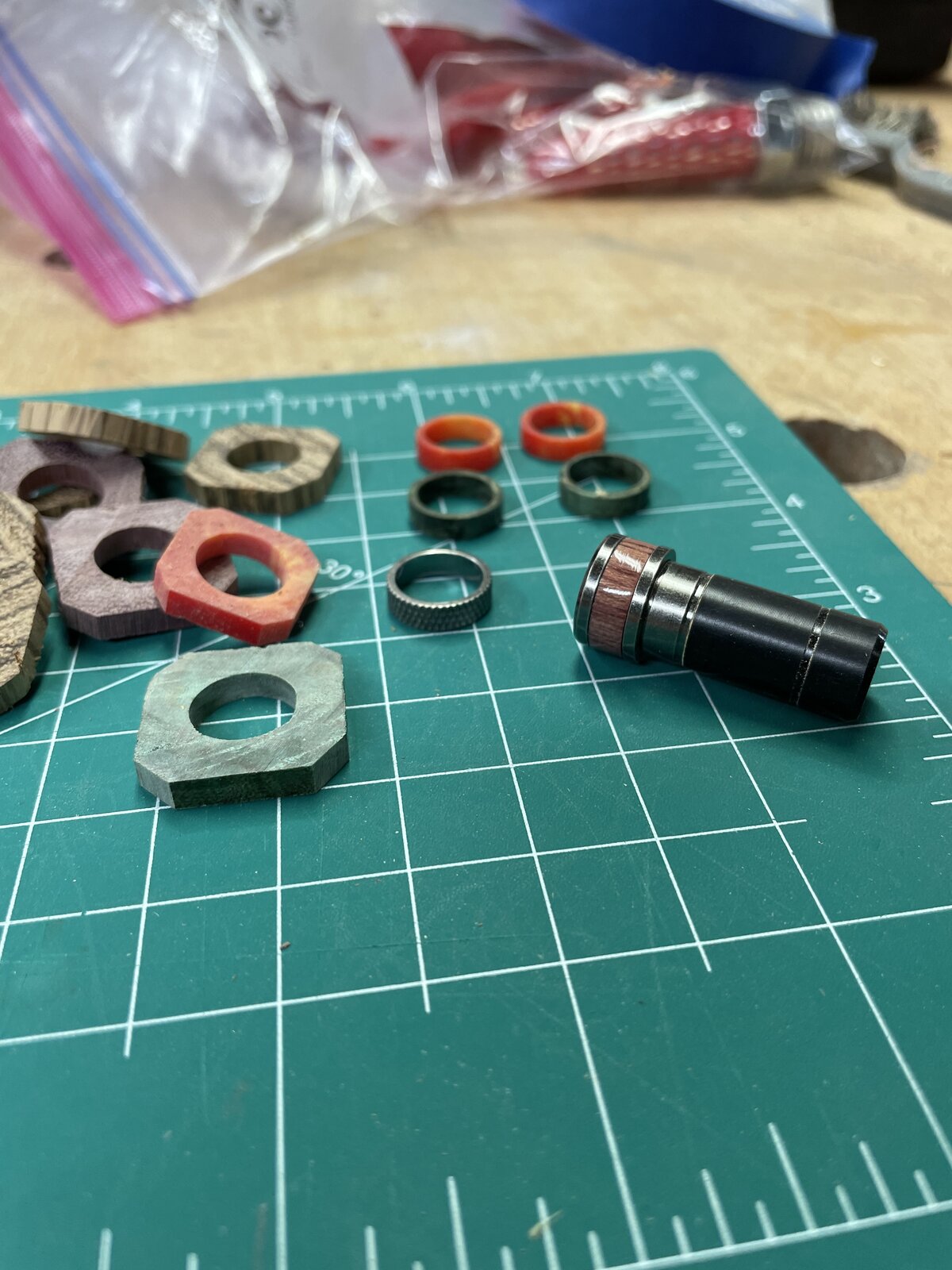

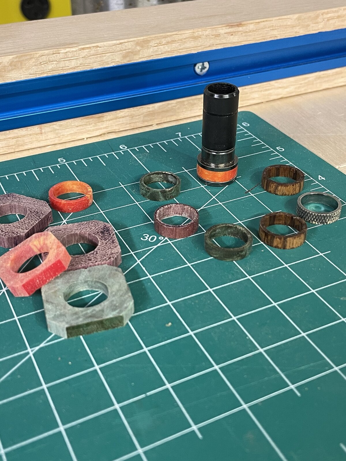

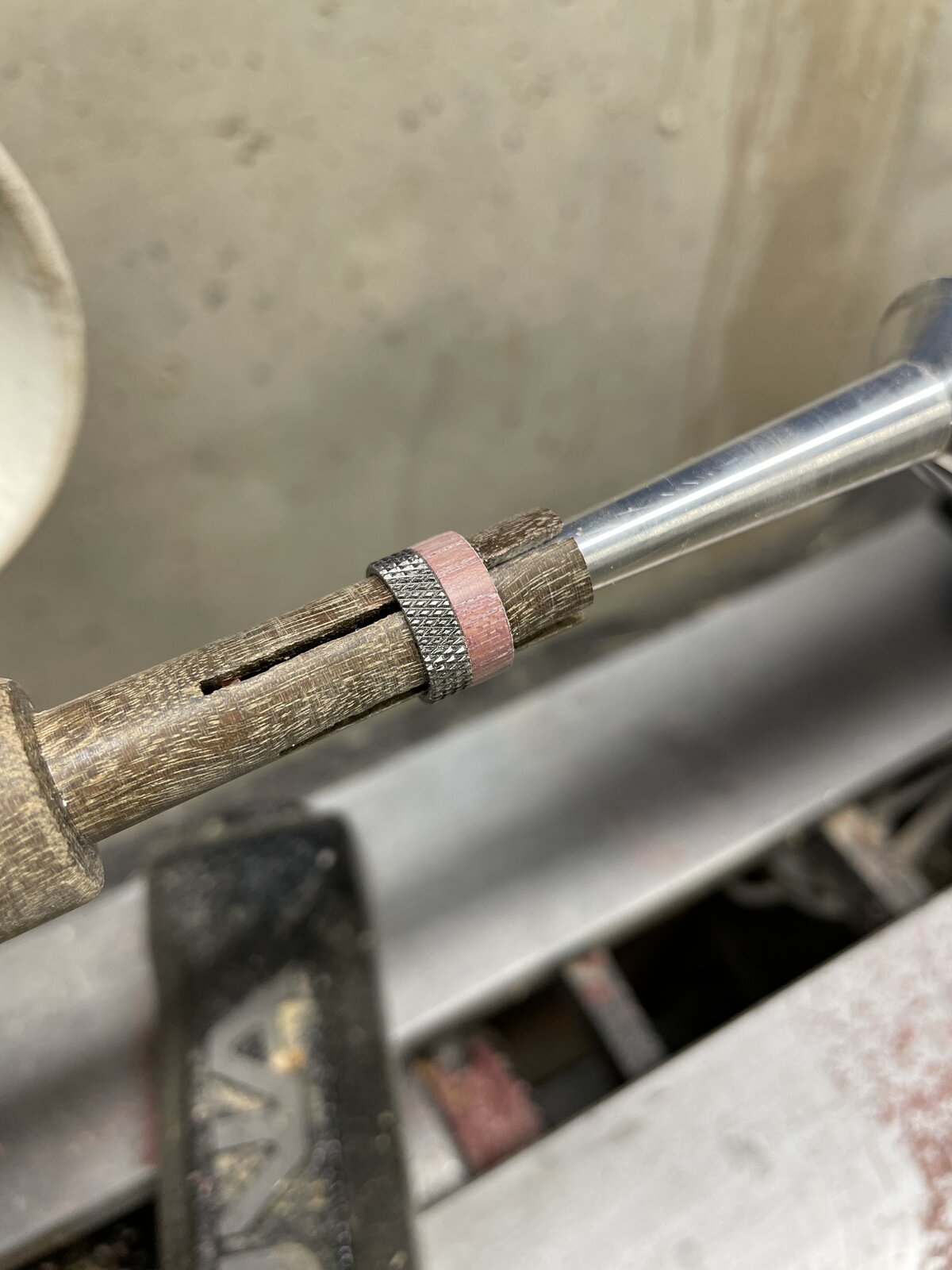

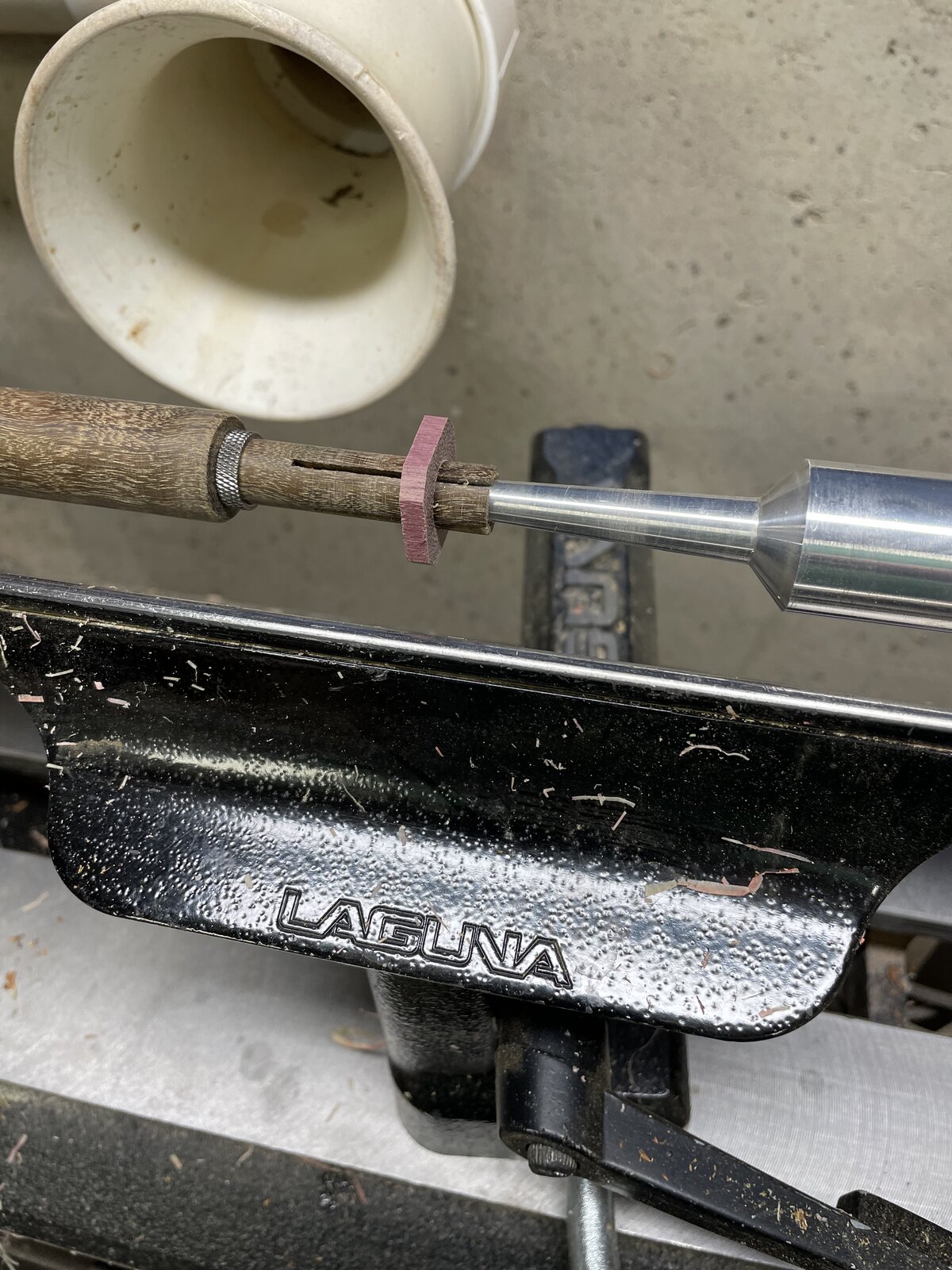

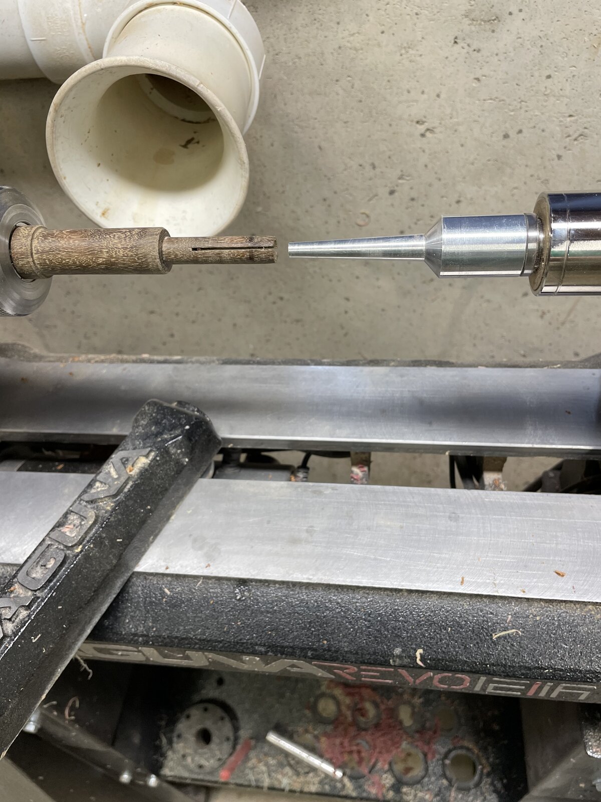

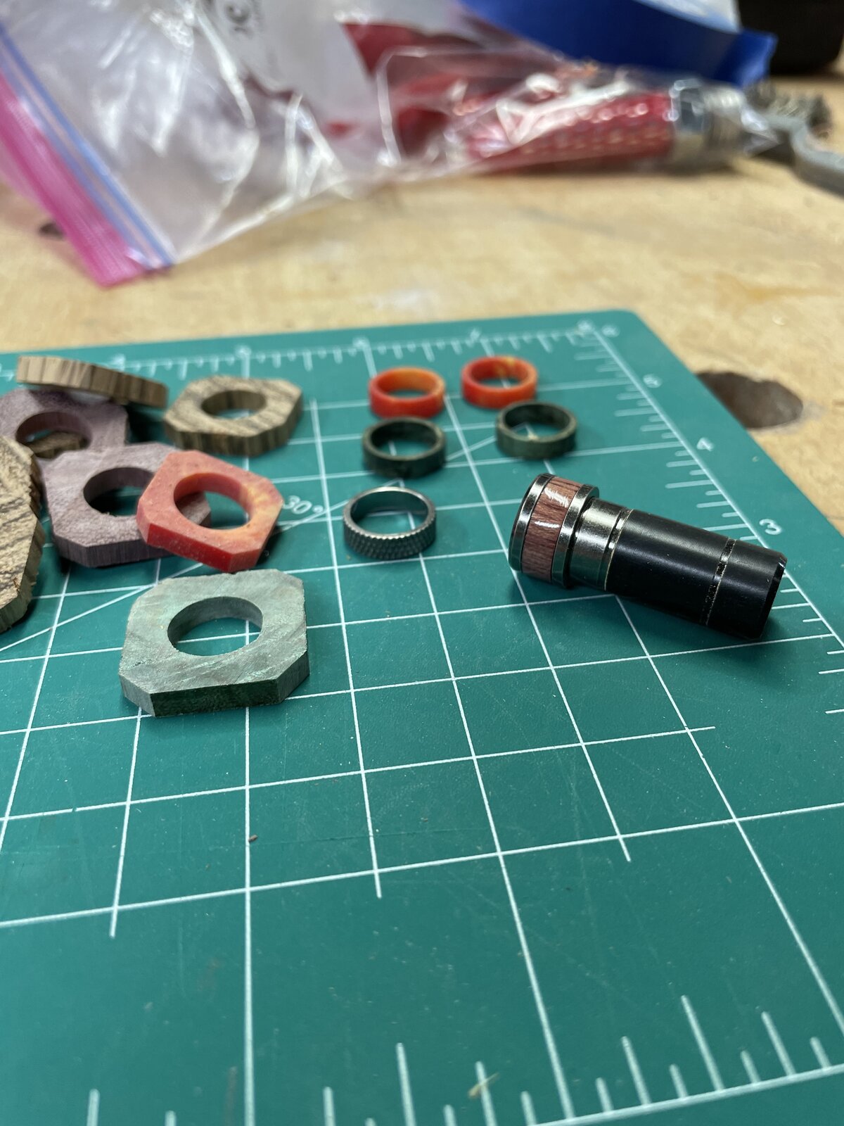

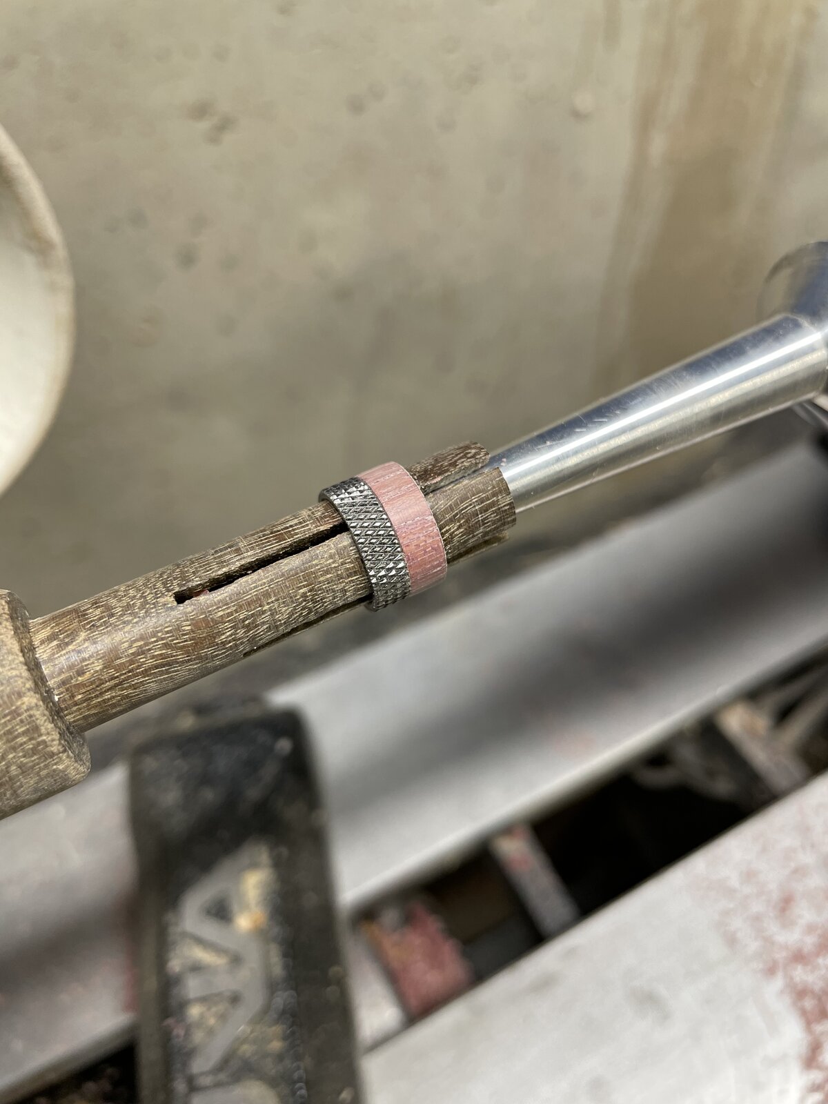

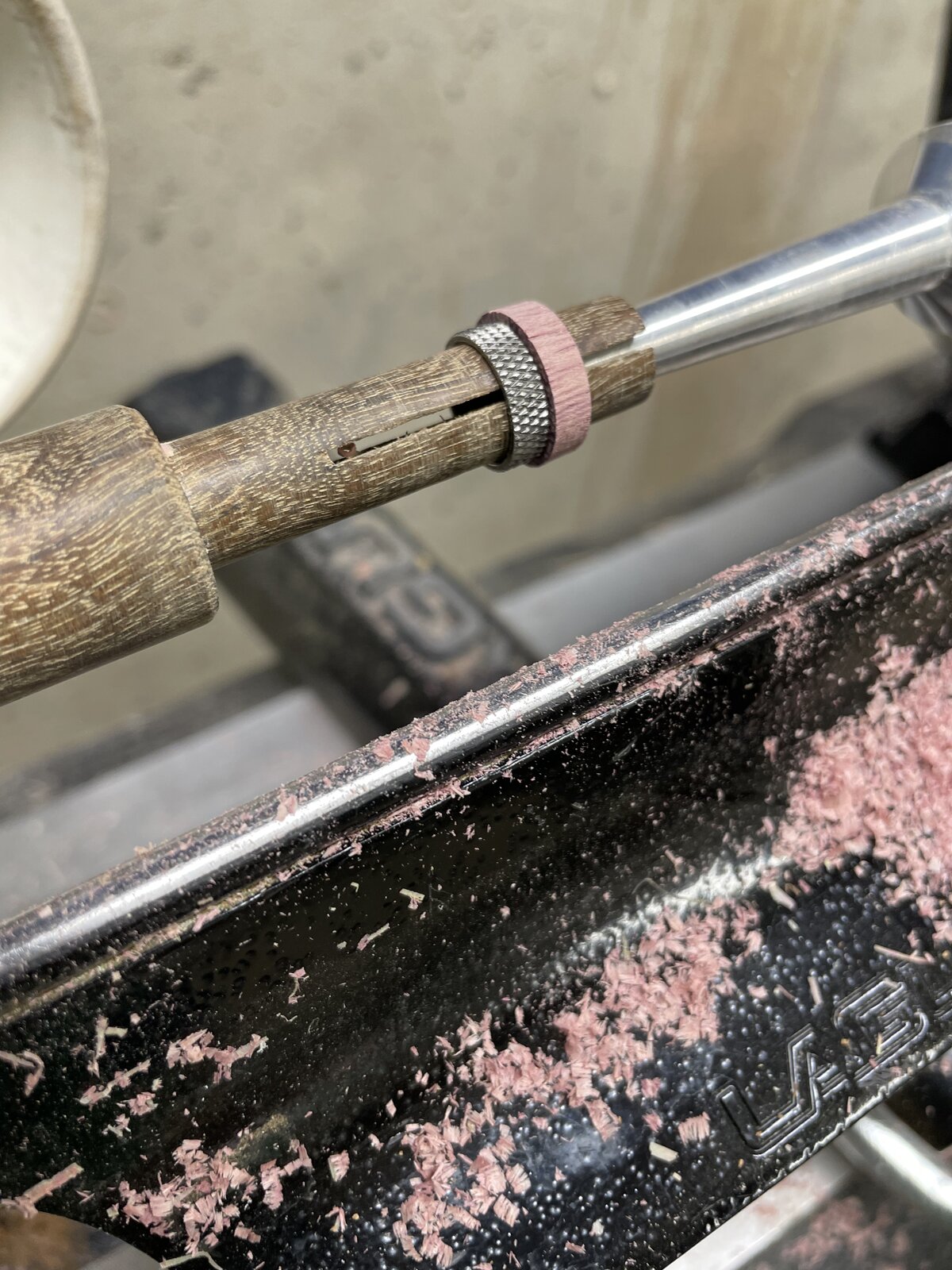

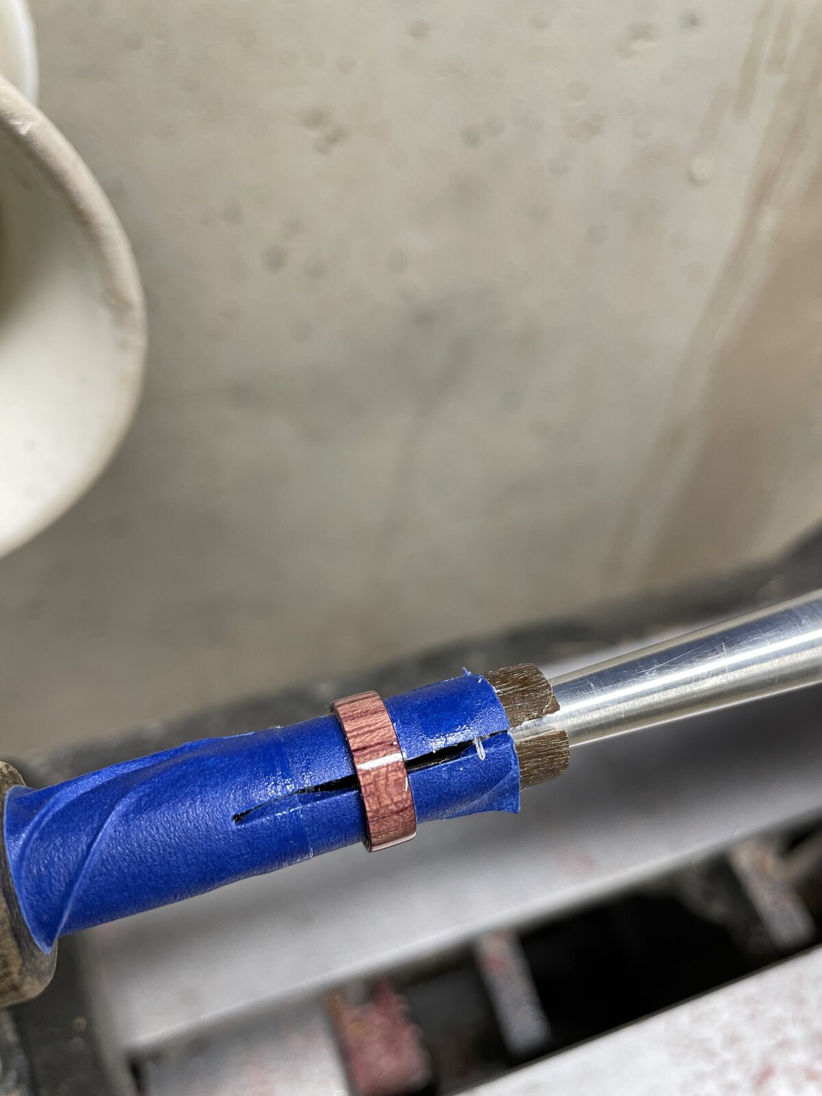

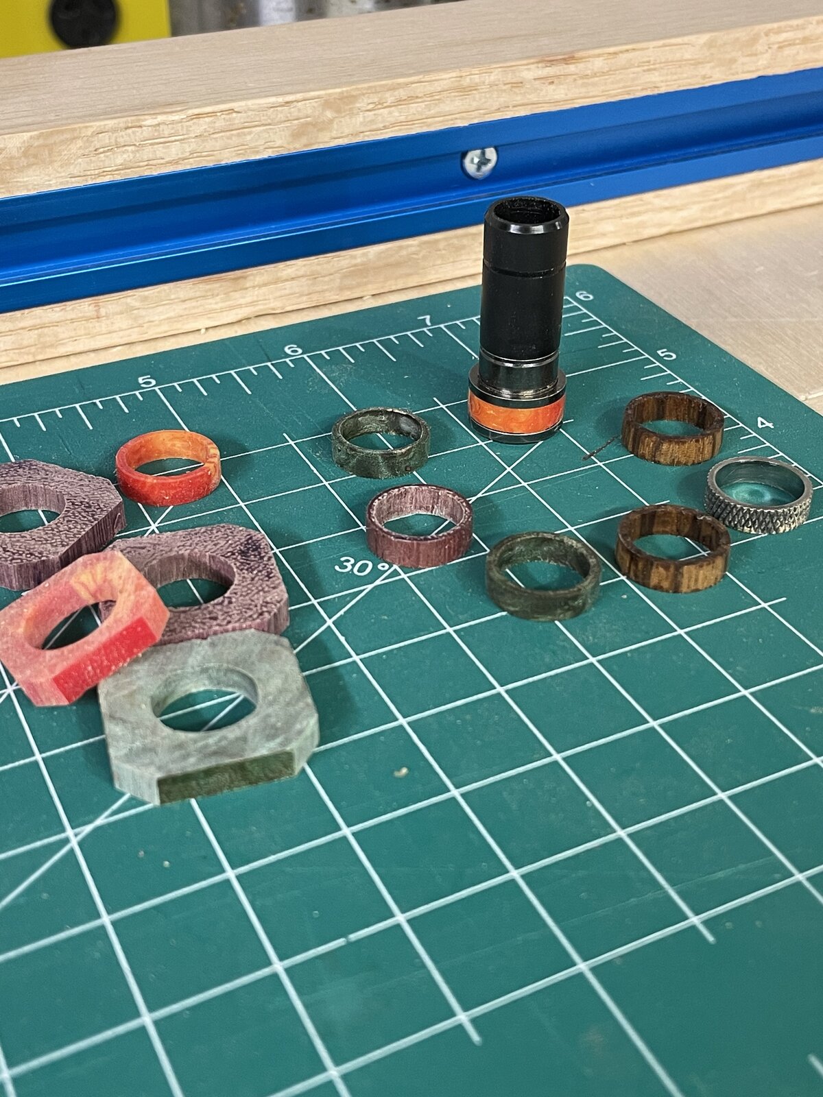

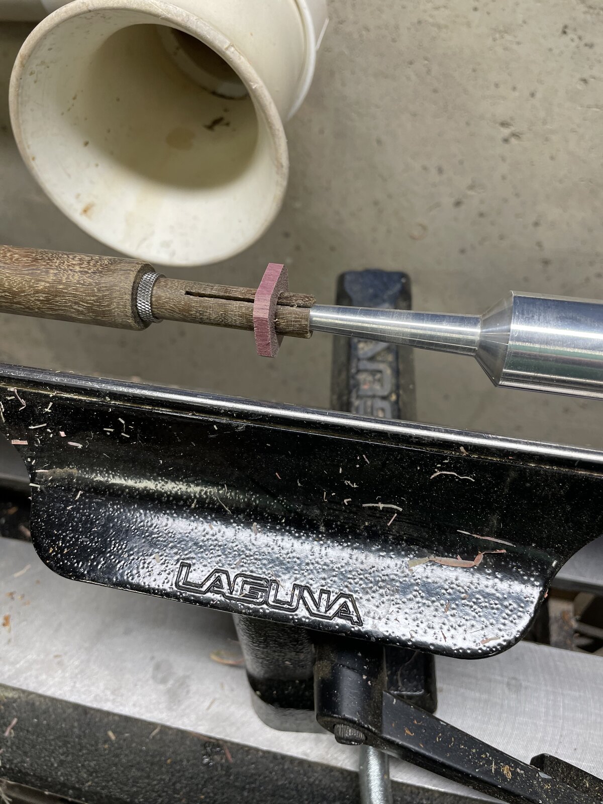

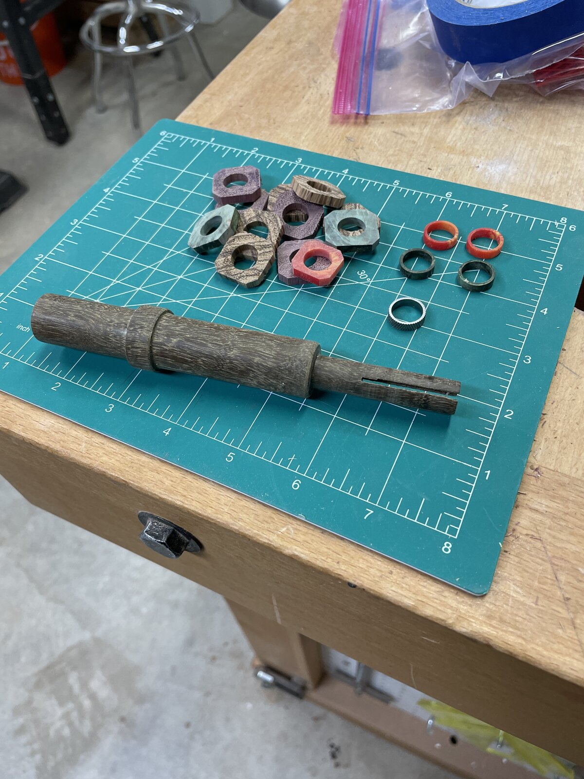

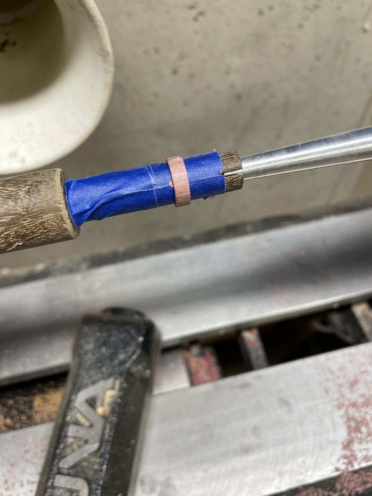

Haven't made a pen yet but I think I have an easy and repeatable method to make the center rings. I just drill a hole in whatever material I want to use and slice them to the width I need. Put them on the jig/ mandrel, turn and sand to size put on a finish and done. I made center rings from acrylic, stabilized wood, Purple Heart and zebra wood. The zebra wood I had to sand to size, it's not stout enough to handle lathe tools at the thinness you need. Even full sanding only took a few minutes. As the pictures show, I just put the original knurled center ring on the mandrel and use it as a sizing guide. I think the pictures will be self explanatory.
I bet the best part of the whole operation was thinking and planning the method. I get the most enjoyment out of things when they work out after some planning stages. I also think another look would be to crown them slightly like a real ring. Nice idea. Have to file that one away.

You are correct, that's what I enjoy the most. Crowning them would be very easy to do.

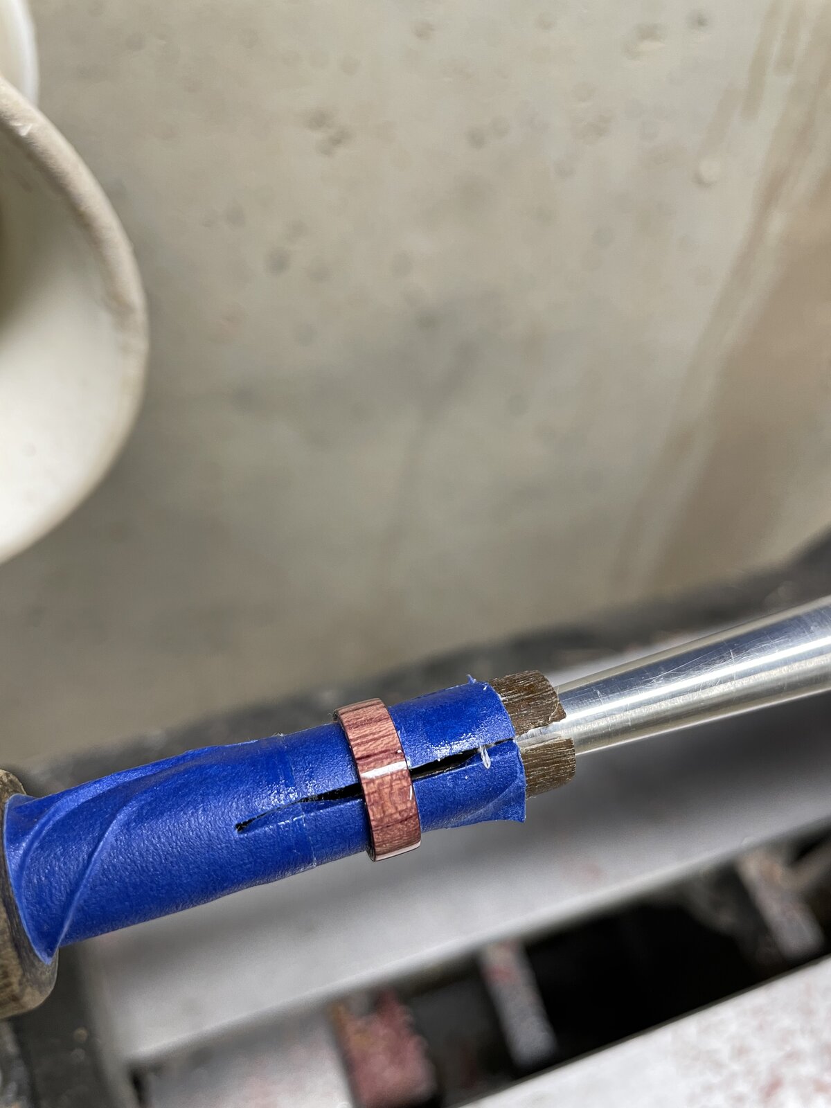

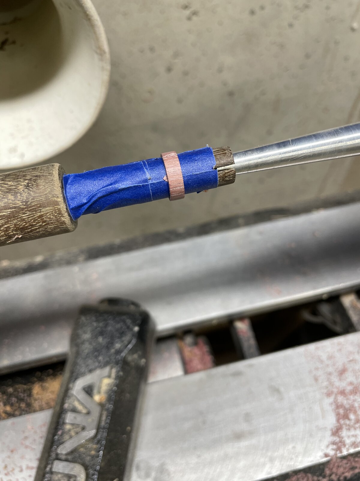

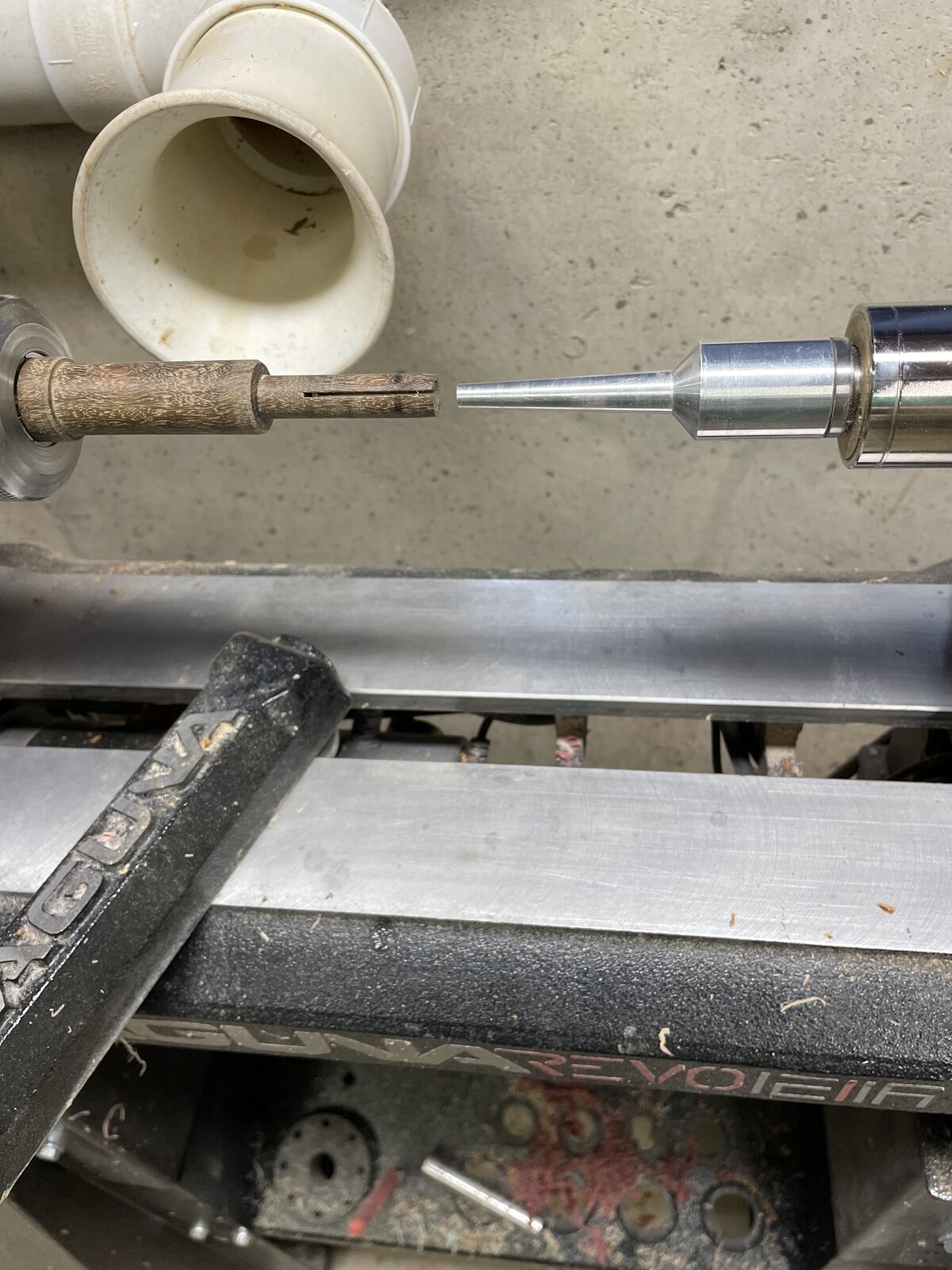

Haven't made a pen yet but I think I have an easy and repeatable method to make the center rings. I just drill a hole in whatever material I want to use and slice them to the width I need. Put them on the jig/ mandrel, turn and sand to size put on a finish and done. I made center rings from acrylic, stabilized wood, Purple Heart and zebra wood. The zebra wood I had to sand to size, it's not stout enough to handle lathe tools at the thinness you need. Even full sanding only took a few minutes. As the pictures show, I just put the original knurled center ring on the mandrel and use it as a sizing guide. I think the pictures will be self explanatory. View attachment 345898View attachment 345899View attachment 345900View attachment 345901View attachment 345902View attachment 345903View attachment 345904View attachment 345905View attachment 345906
can I copy that idea for a tapered aluminium (?) in on the revolving tailstock ! Brilliant for expanding a mandrel

I'm planning on making an actual pen today with a custom center ring. I thank you for the inspiration. I made mine out of the hardest wood I had, a piece of Ipe, I thought it might grip better than plastic. I guess we proved though, either material works well. Next step, segmenting that little ring 😜
