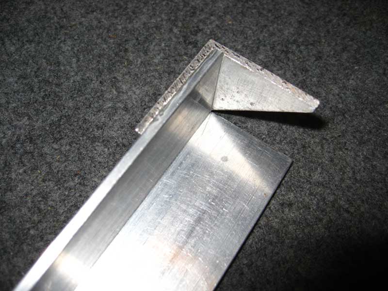

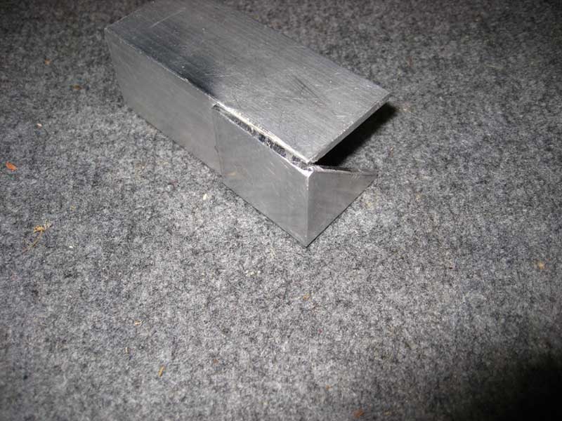

I made my own with some scrap aluminum angle and a little epoxy. I cut it on a Slide compund saw backing up the cut with wood. :smile:

Lenny thanks for posting, I was thinking along those lines but I was going to epoxy a flat plate to the top but yours make more sense and would be easier to line up and faster to assemble. Thanks!

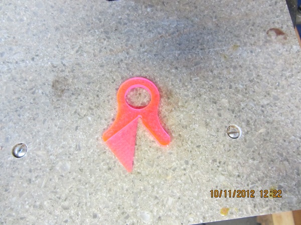

Here is the one Mr. cnccutter makes. They work very nicely. Can't be too expensive because I have 5 of them now. Well I lose things!:mad:

You are welcome.
Very easy to make and what I like about it is it stands up to using a utilty knife to score diagonal lines. Even out of square blanks aren't a problem ... just score a line turn it score another and repeat. If the lines don't meet in the center you will at least be able to easily determine where the center is. :smile:
