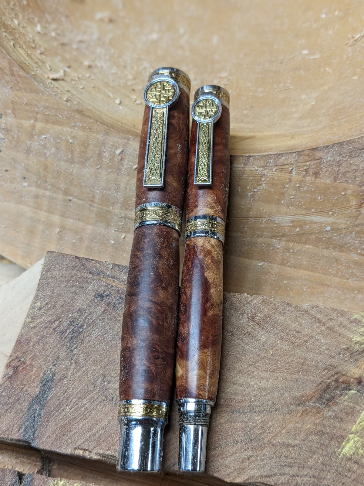

I just received my first stash of these kits and had a couple questions.

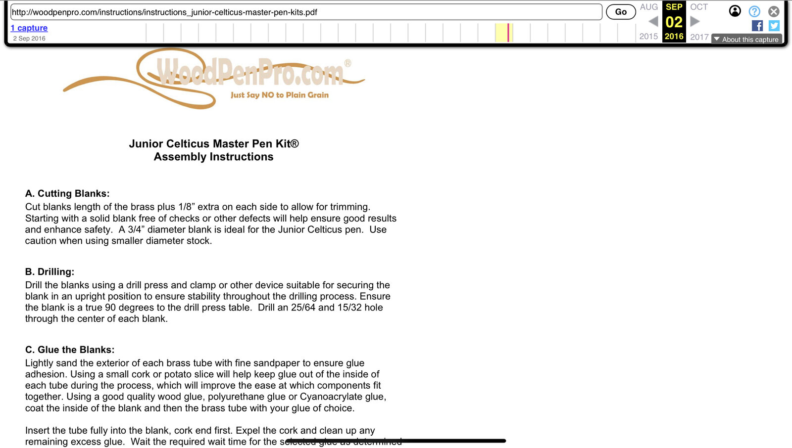

First off - before I press this first one together does anyone have the pdf instructions for the kit they might post or send? I'm 99.99 % certain I have the parts lined up correct -- but on the off chance that I have anything backwards --- it would save me time taking it apart.
Next - for those who have turned the Juniors -- has anyone come across an easy fix for the ones that don't post (other than wasting the extra kit that gets sent) -- I'd be really happy to be able to use both of the kits that got sent -- even if one doesn't quite post correctly --

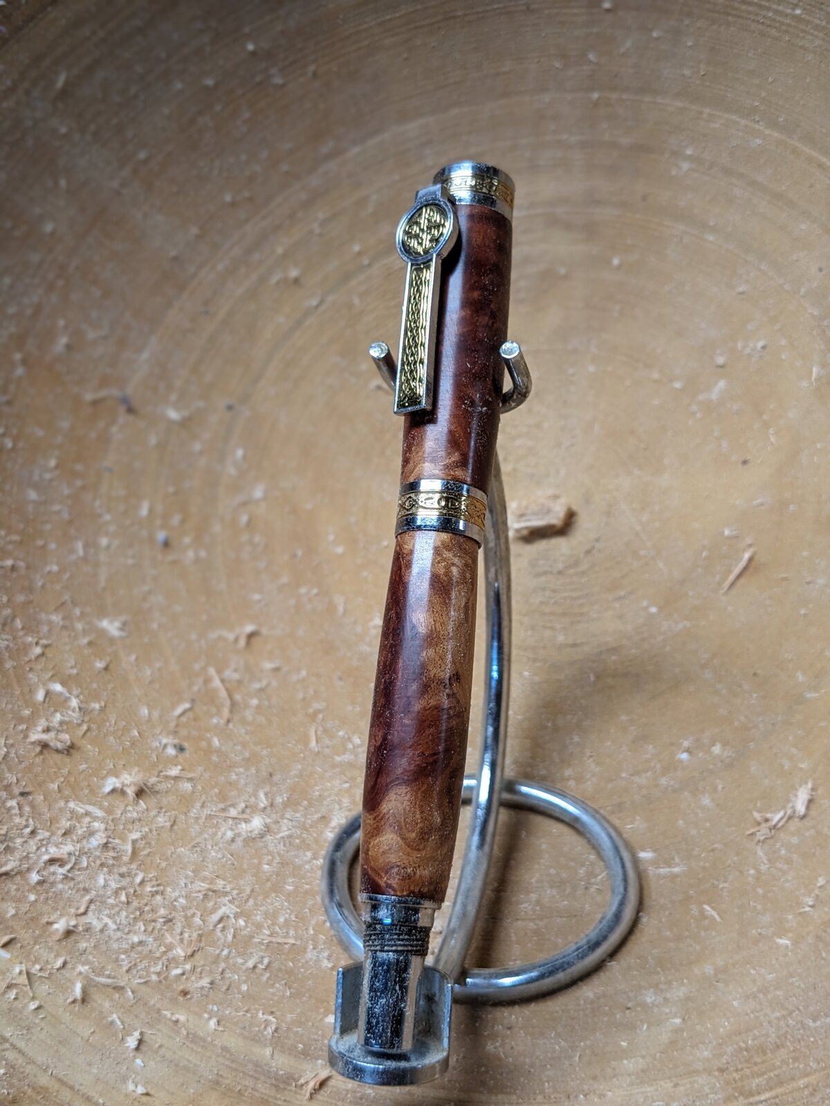

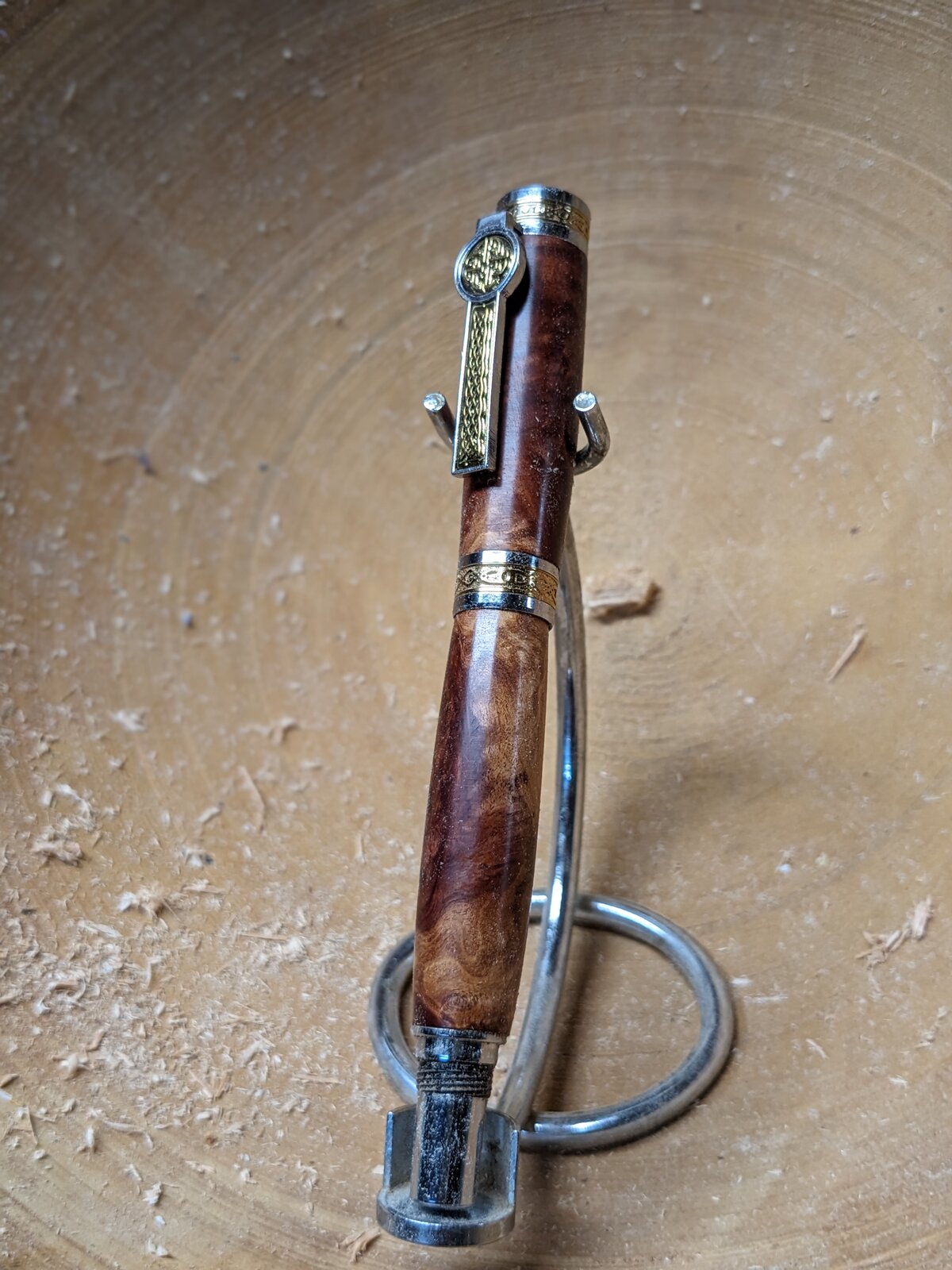

also - I'm asking this before I even turn one and look at it! I turned one of the Celticus (large) out of red mallee burl -- its going to be awesome once I press it!

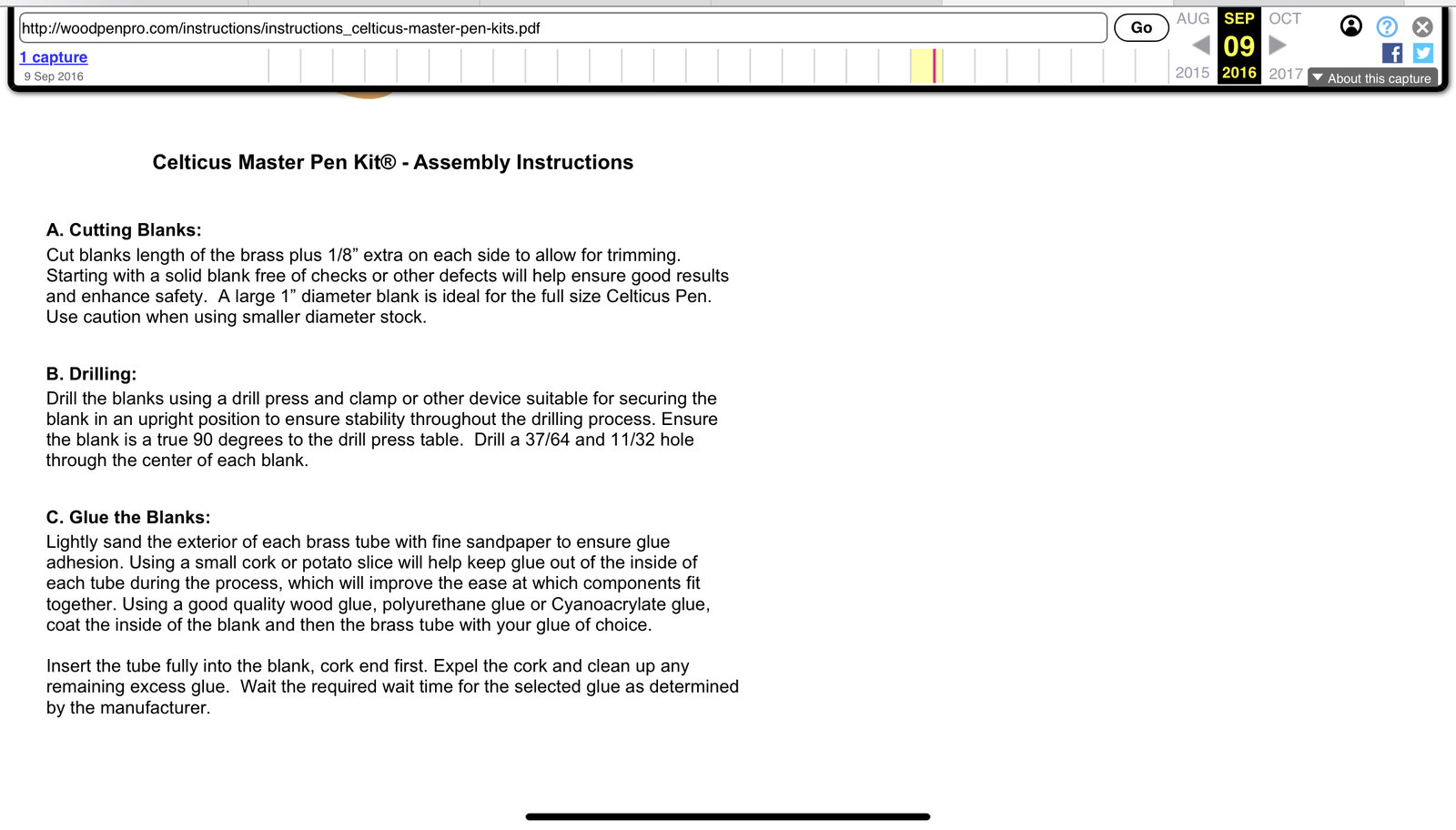

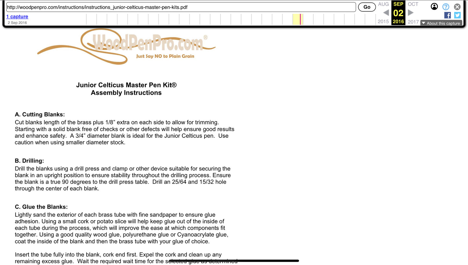

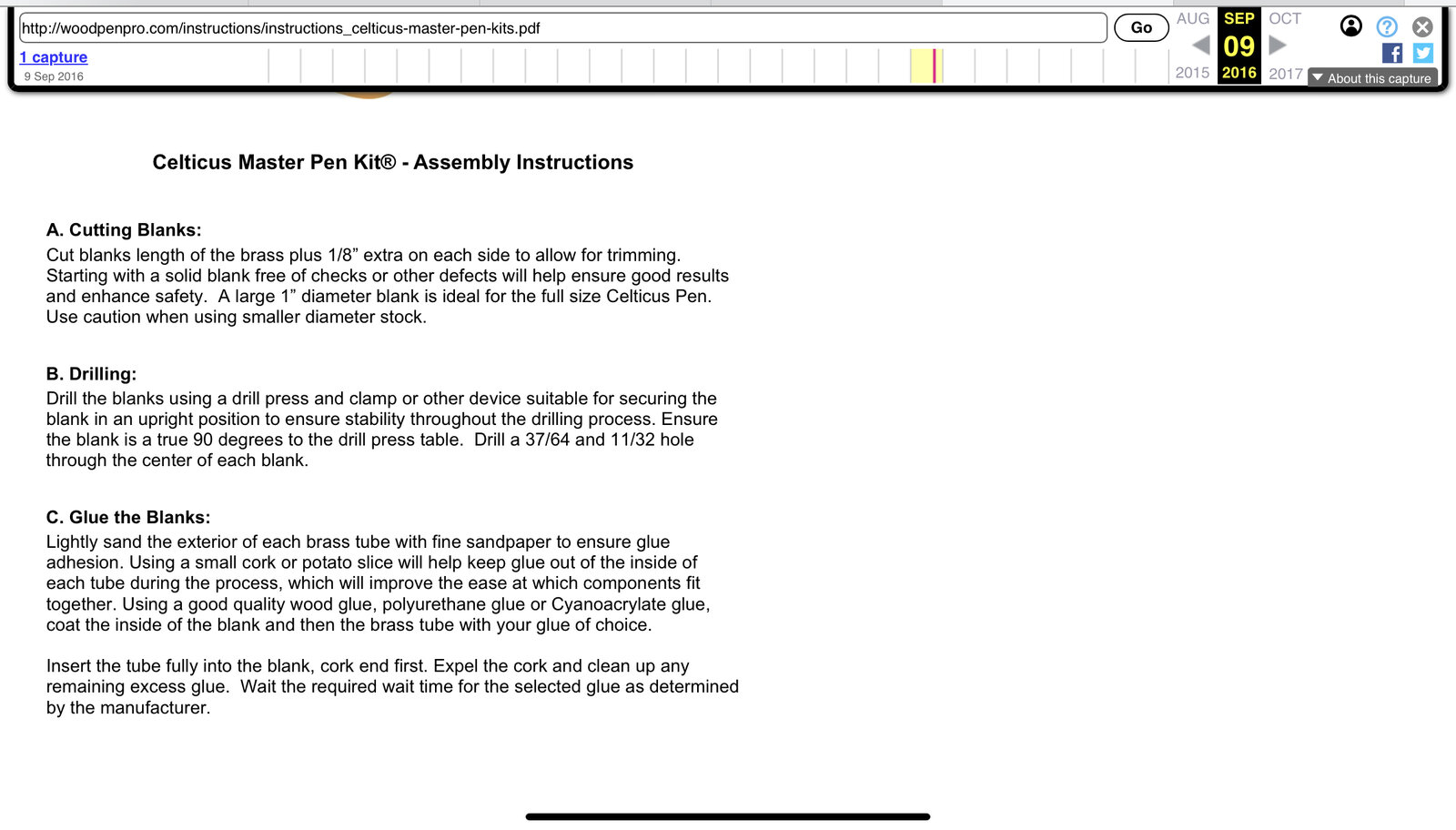

From the website
Instructions for pen kits should go here but Go Daddy doesn't seem to be PDF friendly so I will email instructions along with tracking info until this can be resolved. If you need any instructions please send me an email to jimmy@woodpenpro.com and I will get them out to you asap. Sorry for any inconvenience this has caused.
Best Regards.
Jimmy
Wayback machine doesn't help much either. This is from 2016.
From the website
Best Regards.
Jimmy
DON! It's Kelly .... I did see that on the website - and emailed him .. But I was Hyper so I posted here! Hawaii is several hours behind us but when he got to his shop he did send them.... (I had them lined up right anyway)

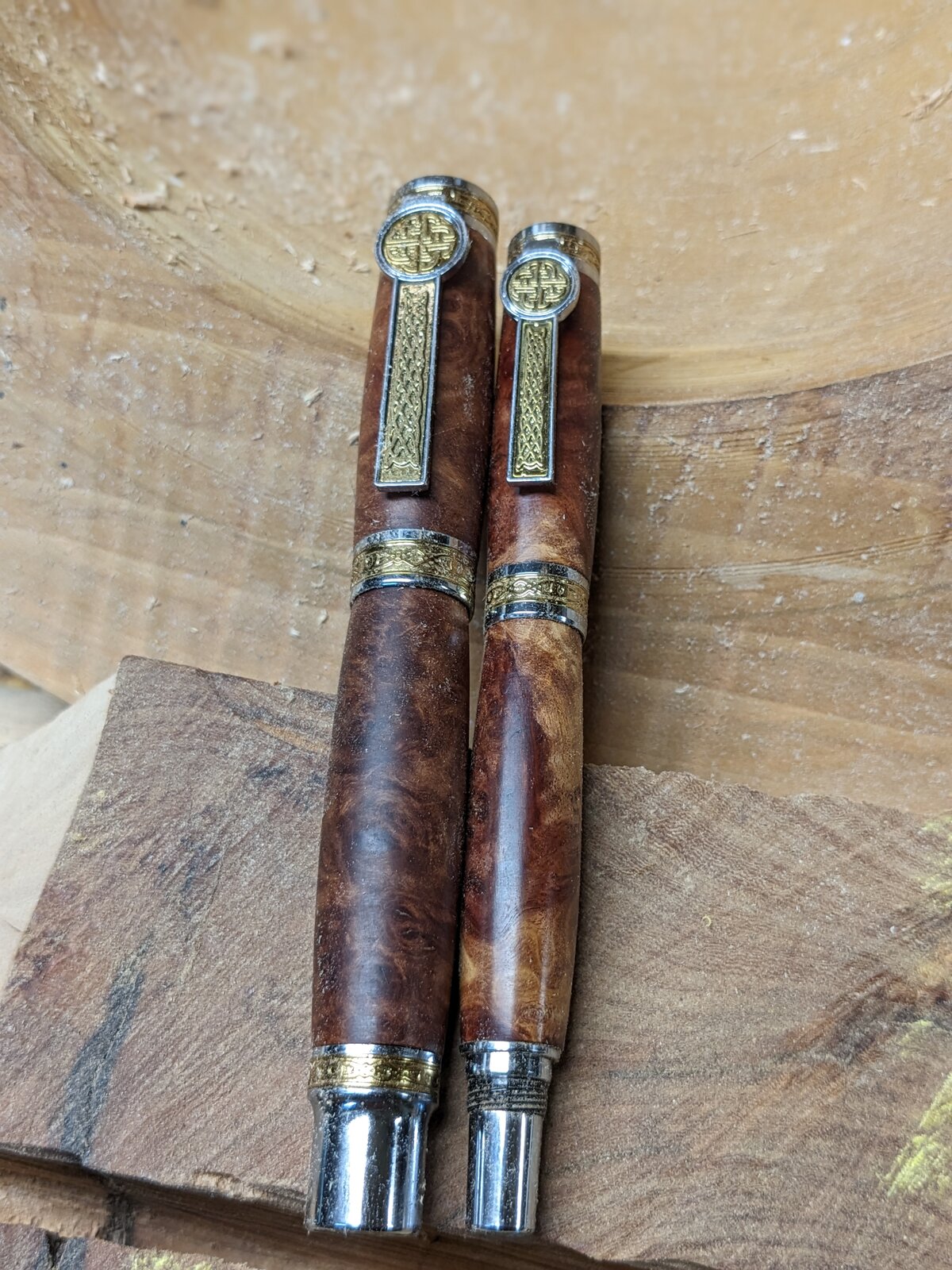

More than that though I would really like to know if anyone has a "quick" fix for the non posting Juniors... Id almost rather figure out a way to hide the threads on the back of the pen than use the second (free) kit that he sent... I'm not even sure how to use the part out of the second pen to make the first one post...
