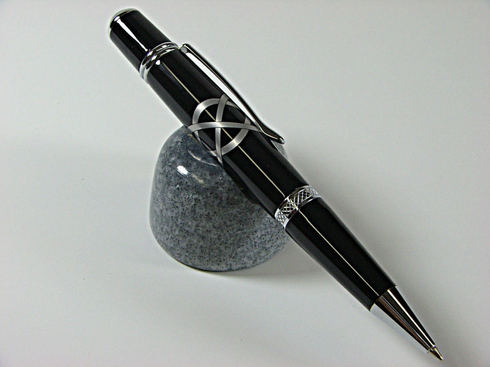

Wow CA I am surprised. I too have done the aluminum single celtic knot. This adds intrigue. Thanks it is on my to do list when I get back into some pens.
I did sand the aluminium and copper very well and degreased it with denatured alcohol.
