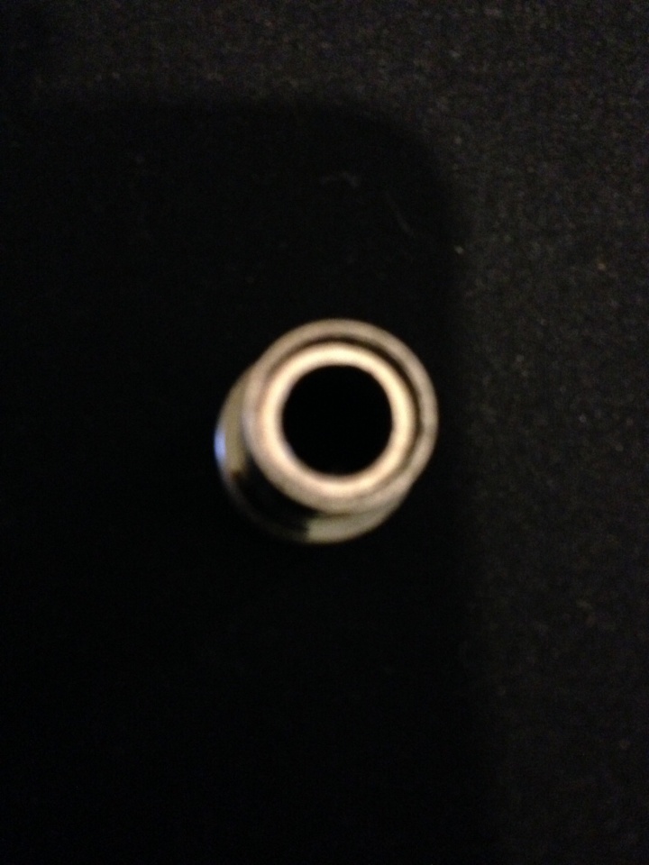

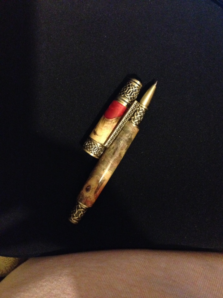

I have purchased two kits of the Celtic Rollerball Pen Kit from PSI last October and I finally got the chance to turn and use this kit today. I was happy with my work and I got the kit together and completed. I noticed that the pen is magnetic which should not be a problem except that the magnetic is too weak to hold the pen!!!:eek:
I emailed PSI but since it's thanksgiving weekend, I don' think they will answer until next Monday. I bought the kit a month ago and I am afraid they will not refund or replace. I do not want to replace with the same not unless they have a better magnet?
So, I am imploring all the experts in IAP, is this kit salvageable? This kit alone costs a steep $31.95 and lucky me I bought two. Can anybody help me resolved this magnet failure? I have attached a pic.

I was given a Vertex fountain pen and the magnet will not hold the cap in place. Put it in a shirt pocket and it separates. Clip it on a note pad and be prepared to hunt on the ground/floor for the body.
Good luck, but you may have a desk pen. Check the other one before assembly.
My experience is keeping me away from the PSI magnetic pens.

Marla, this is a stab in the dark, but if you find you are stuck with the kits, you would have nothing to lose to try this: attempting to increase the magnetism. After looking at the pen kit instructions, it appears that the finial end of the postable cap probably contains the magnet, because it posts to both ends. Try wrapping thin bare copper wire around the entire finial end (metal section). Touch the two bare ends of the wire to a 9-volt transistor battery momentarily. I would suggest no more than a second or two to arc across the poles. Hopefully, this will build the magnetic field stronger. I have magnetized many screwdrivers and other metallic shafts this way. I hope it may help.
Marla, the nice thing about the idea of re-magnetizing the metal section is that it will not harm the pieces at all in the process. Hoping it helps. I am sure the mfg. is using a small button magnet mounted inside the cap. It's too bad that this magnet cannot be accessed. Many sources carry stronger button magnets in the rare earth variety. Good luck to you.

Mu husband finally figured out what's wrong with the pen kit. It's a design flaw.
He said rare earth magnets is very powerful so it's not the magnet.
The magnet is located in the center band. When we compared the two kits I bought, we noticed that the magnet in the kit I just used is not inserted far enough to make contact with the pen tip. All my husband did was punch the magnet down a tad down and Voila! Contact! Now it's holding the pen as it should:biggrin: I tested it different ways (holding the pen cap then shake up and down, jiggle, etc) that sucker is not falling apart. :biggrin:
