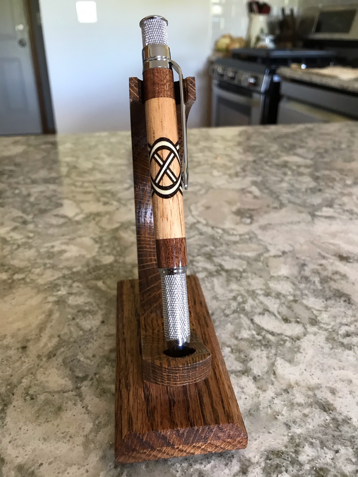

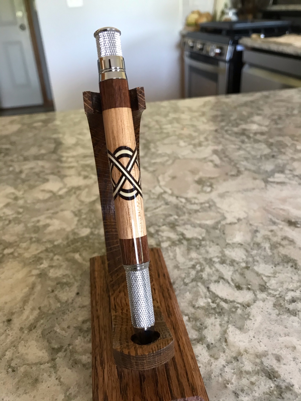

After the other days long discussion about all things Celtic knot, I had a hankering to turn one. I glued this blank up quite awhile ago. Woods are hickory, and chechen. The knot is holly and wenge . For the Celtic knot geeks, cuts were were done 1,3,2,4 and they were cut at 55 degrees. Cuts were all made as partial cuts, not all the way through. Infill thickness was .100, saw kerf is .102. Pen is a GT Knurl, my favorite pen to make and to use. Lots of meat for segmenting.
Very nice. Did you clamp the ends to tighten the knot?? Just curious if you do that part. I agree that a knot between 52 and 55 degree is the perfect size especially if it takes the whole blank. What is your glue of choice??

Good question! Ken, how snug are your "exact kerf" infills? Does your glue-up jig include parallel support along the sides of the block so you can apply a little pressure on the ends? I know jt said he didn't clamp and his lines were perfect like yours are.

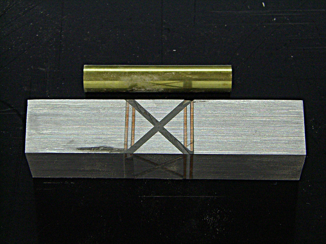

One of these days I am going to get enough nerve to spin this one. Brass and aluminum and the glue will show because that was what I used to glue metal to metal. I want to add some other detail for the ends but not sure what kit I want to put on. This is an oldie for sure. Probably 10 years ago if not longer.

No, I never clamp the ends. If your cuts are precise, you don't need clamps on these. The glue i used was titebond translucent.

My infill are snug, but not tight. I know they are correct when the infill slides in easily but won't just fall out when turned upside down. I never clamp them unless I'm doing one that is cut through all the way.
