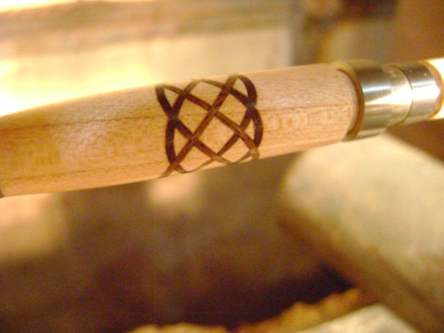

im new here, certainly not new to turning though
just wanted to share this pen in maple/walnut
I have pictures of my process making blank too
Nice job Steve I'm impressed with your Knot. I think John might have your knot confused with a Celtic Cross. Either way, very nice work and I'd like to know how you did it.
its just the angle of the pic!!

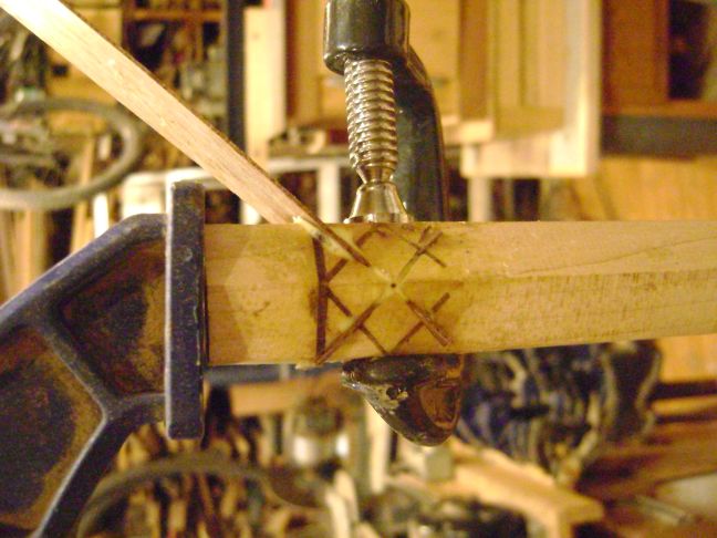

pretty simple really, a fairly precise square piece of wood(7/8 sq) and some shop cut veneer, thickness depends on the bandsaw kerf

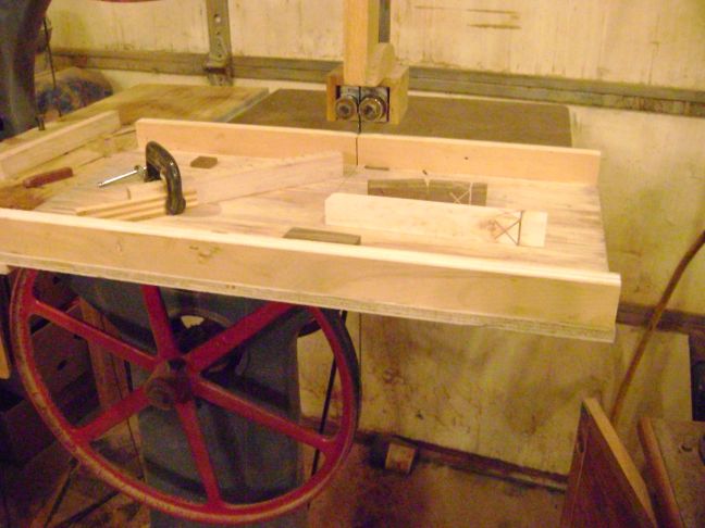

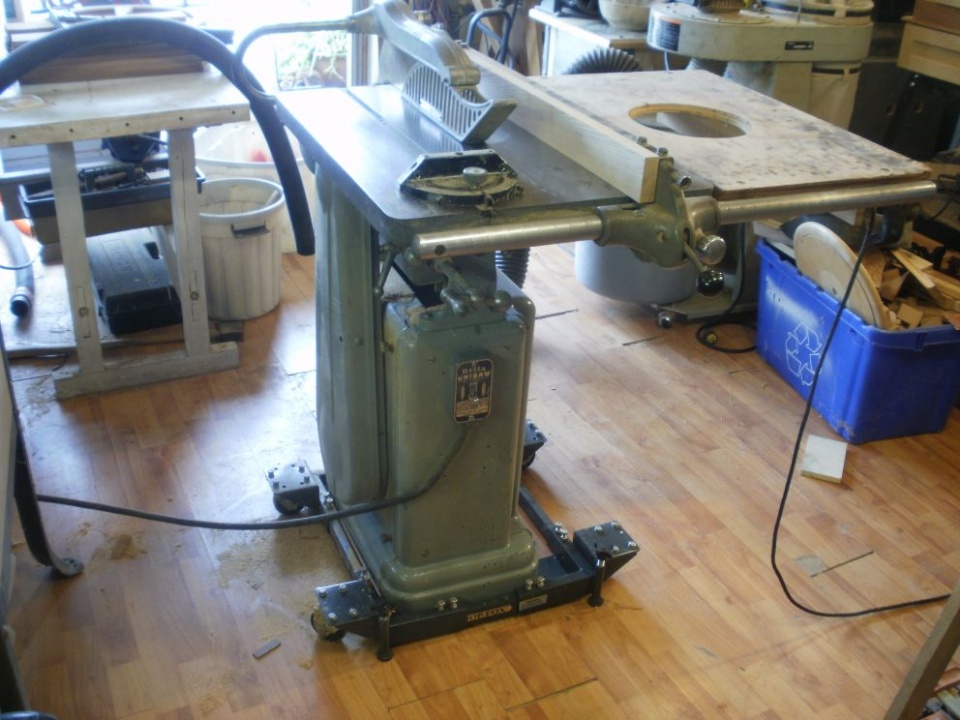

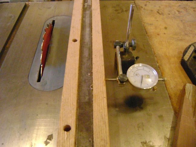

here's my bandsaw sliding table and a dial guage for the tablesaw to cut the veneer
the sled for the bandsaw cuts stopped kerfs with a stop to ensure they are all the same
my bandsaw kerf is a hair under 1/32, my tablesaw blade is 3/32, so I move the fence each time 0.120 inches for a piece that almost slides right in the kerf. a little sanding makes it fit

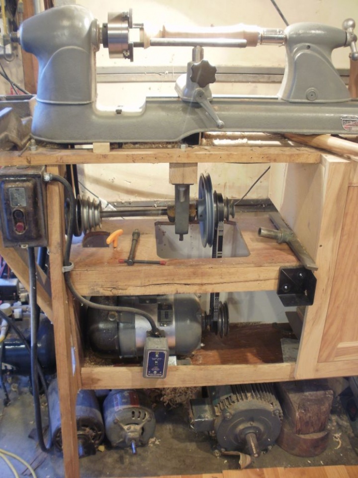

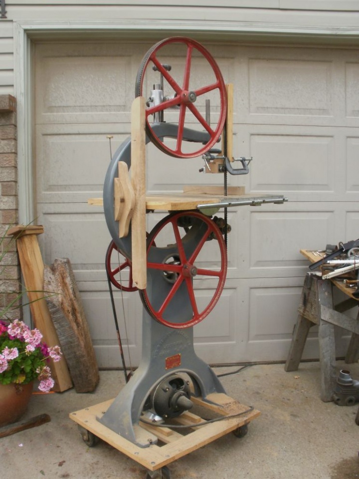

yeah, both my tablesaw and bandsaw are older than most of us here, so is my lathe.

Nice Work Steve,
It is great to see some old solid equipment.
Nice job on matching the Kerf.
Excellent Celtic Knot, Turning, Fit and Finish.

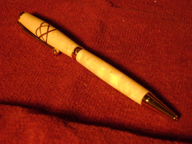

more to come! ive made up a dozen blanks of the maple with walnut banding and tried one reversed, ie walnut with maple banding. not so good, walnut sanding dust is embedded in the softer maple changing it from white to a light brown, suggestions are welcome. the "muddy" colour is most obvious where the maple grain is at 45 degrees, so almost endgrain.
ive also started another blank as a test, this time a six sided "knot". for this, I started with a carefully cut hexagonal blank, it will get 6 inserts instead of the four as before. we'll see what happens
yes, Brian, my shop is full of old iron. the bandsaw is a 1915 Crescent 20, the tablesaw is 1930's(approx.) delta 1160 tilt top, and my lathe is a 1940's Henry Power Tools(London Ont, Canada).
I have a complete woodworking shop(in old iron), but these three are most related to turning!!

and here is the hexagonal blank with 6 inserts. the only complicated thing about this is cutting an accurate hexagon. it MUST be a true hexagon for the kerf cutting to be accurate

I love your tools ... Does the dial guage on your tablesaw move the fence or just to measure with ?
Dave
the dial indicator is just a cheapie from Princess Auto, the Canadian equivalent to horror freight
so it just measures the amount I move the fence
here's the completed pen top, the knot is pretty awesome if I may say so myself!!
have to remember for the next bunch that hexagonal pieces don't fit in a 4 jaw chuck properly!! I had to align the semi-turned piece with a dial indicator to drill the 7mm hole
as a side, just picture all those tiny pieces of maple between the walnut "slices"!!
