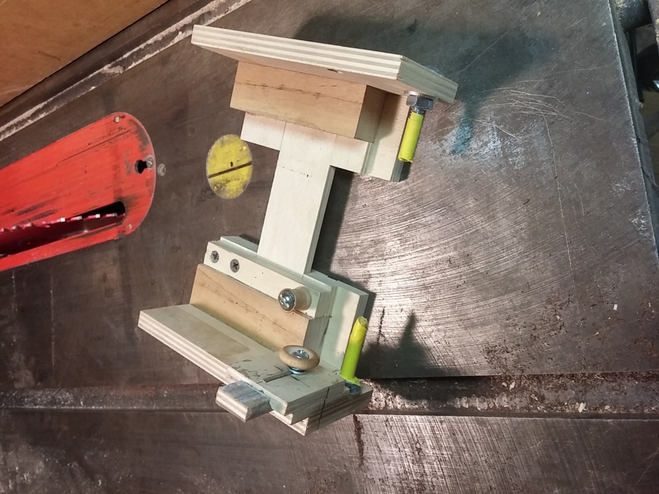

OK I'm trying to up my game with more complicated Celtic Knots.
I kind of realize that if the hole is not perfectly square and in the middle of the segmented blank that the knot will be off so I've been working out a way to re-square the blank in relation to the hole after its been drilled. I don't have a great setup to drill blanks but it works fine for pens where being off a 1/16 to an 1/8th at the other end doesn't make a difference.

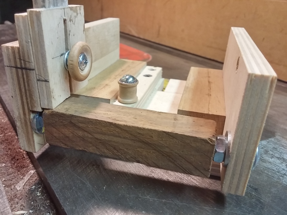

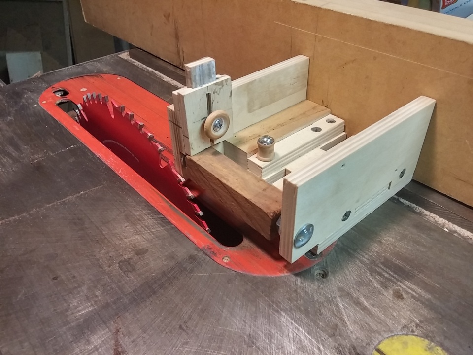

To Fix this I came up with this.

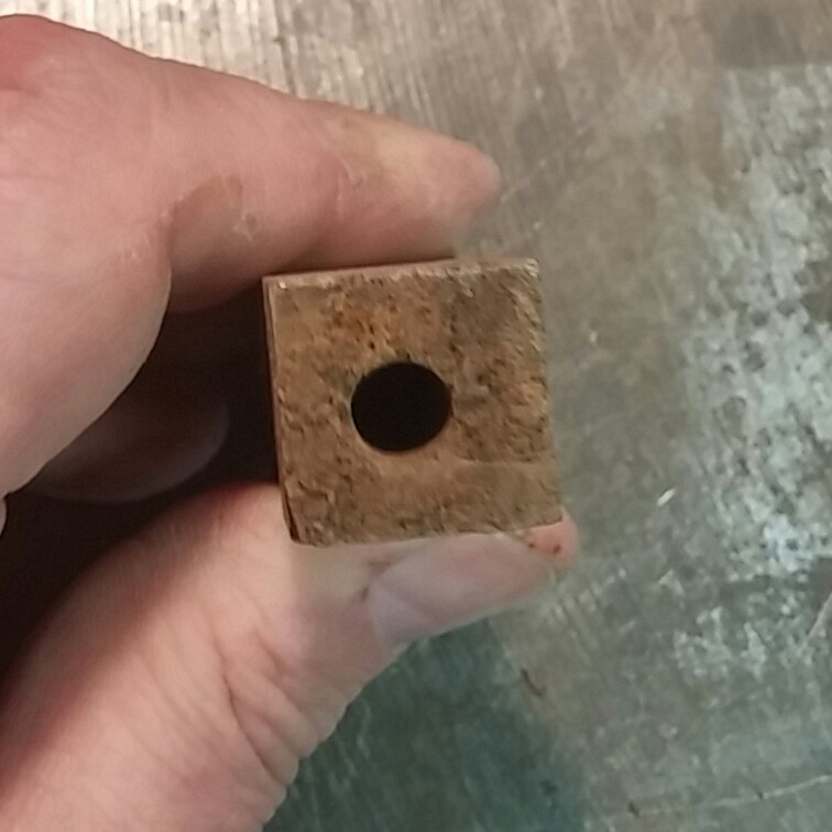

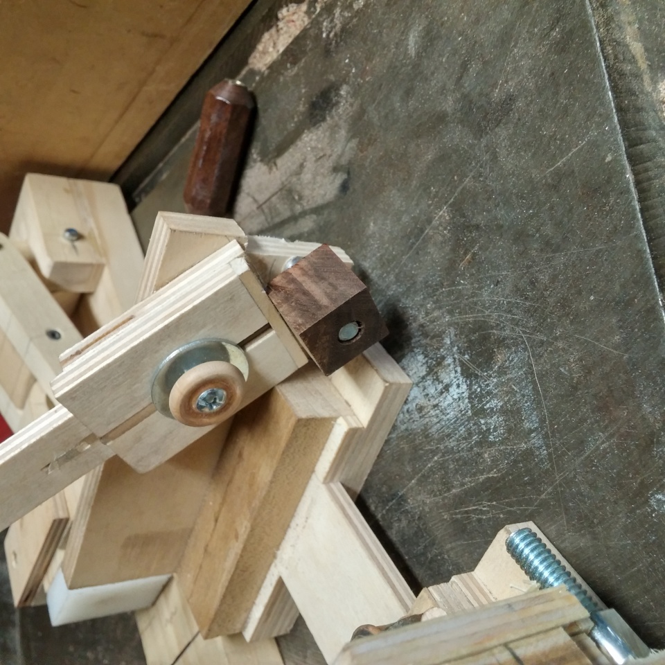

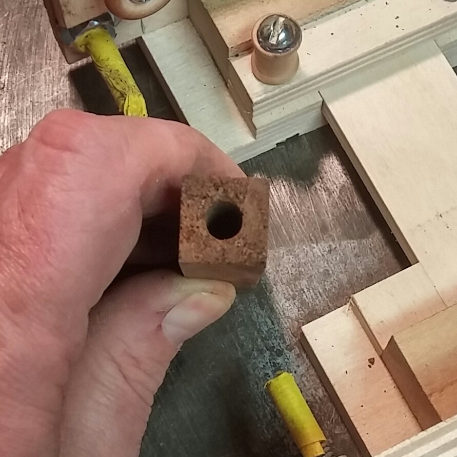

It reindexes the blank to the hole so it came be re run through the table saw. The first pic of the blank shows it being off and the second after I ran it through the jig. Not this is done before you glue in the tube.
To mount the blank you need to use short sections of your tube and your bushing that fit on the 1/4" bolts at each end. For this demo I didn't have my tubing cutter handy so I just wrapped a bit of tape around them to snug it up. If I do this a lot I would probably just turn some custom bushing for each hole size.
You index it with the upper "slide" and as you cut you rotate the blank a quarter turn indexing off the fresh cut.
It took off a 1/16th to nothing on all sides. The blank is from home milled lumber scraps from my Fathers stash and its a light 3/4" of an inch.
I'll try to do a video tonight if I can set it up. I finished late last night and the pics where the best I could do. With a perfectly square and centered blank I can see doing inlays with multiple strips of wood not laminated but side by side.
So I'm I just over engineering this (I started College as an Engineer and got one son through the program) or I'm I just crazy that I need this kind of precision. :befuddled:
Also if I modify the indexer you could use this to knock the corners off blanks. If I could come up with a way to add an indexing wheel to this you could make blanks of any number of sides.

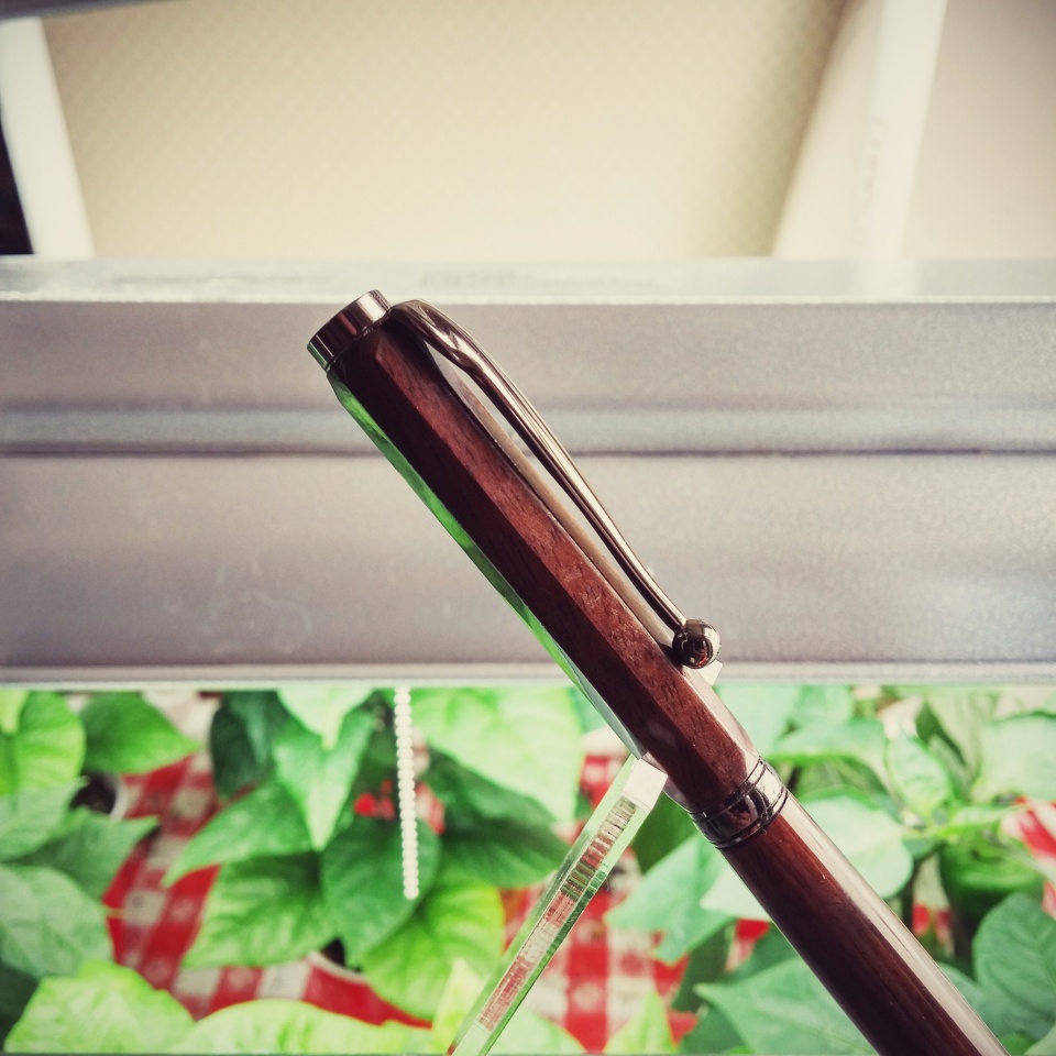

I also added a 45 degree angle stop so I can use it to knock off the corners or better yet make perfect 8 sided blanks for 8 sided celtic knots or just an octagonal pen. :good:

After re sawing I used a digital caliper to measure the distance between the hole and the sides and it was off only about .002.

I've already removed the indexing stops due to a design oversight on my part and added a strip to the back to make it longer.
Changes were required after I almost sawed through some bushings and took out a tooth on my saw blade, wasn't pretty.

Yes I found this out last night when after making some safety improvements it grabbed the blank and flung it across the room. :eek:
I still have all my fingers. It was the same piece of Bloodwood I had an issue with last time. I think its to hard and it had swirling grain. When I first used it I cut some walnut and was super surprised how well it worked.
This time I tried to make a larger blank with a larger hole so I used my bushings to hold the piece. Maybe that was the mistake.
I could modify it to use my band saw but its a cheap 3 wheel Craftsman with only a 1/4" blade and wouldn't give me a straight cut.
But as for now DON'T MAKE THIS.

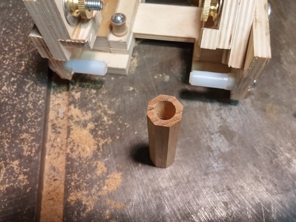

Ok I think I'm back on track. I made some sleeves that go over the bolts and go into the hole on the blank.

I tried making an 8 sided celtic knot last night and its just not worth it. I made the inlay a tenth of an inch to match my saw blade and there was just too much inlay. It may work if I made a thinner inlay or a steeper angle. Also the more segments the more the knot can start to kind of "Unravel" because every cut and reglue up can add errors keeping things from lining up.
I'm going back to a 4 sided knot but have other tricks up my sleeve. I hope to have something tonight.

Before I made those sleeves I used the bushings for a sierra/manhattan/etc pen with some blood wood to hold the pen just like it was on the mandrel but just that the mandrel didn't go all the way through.
The first time the blank did something odd and it started to cut into the bushings. I beefed up the indexing stops to hold the blank more securely thinking it was spinning and it grabbed the blank and tore it from the holder. I haven't found any of the pieces or the one bushing and I still have all my fingers :eek: .
I just don't think the bushings kept the blank totally square to the blade and flat to the table and not sure tapered plugs would either. Just easier to make custom bushings/sleeves for each size pen hole.
I used some extra UHMW plastic I bought to make non stick CA bushings.
I just think the cones will only hold it at the ends and it could "flex" down into the blade.
Let me put it this way. I want this held as securely as possible I like having 10 fingers. :smile:
