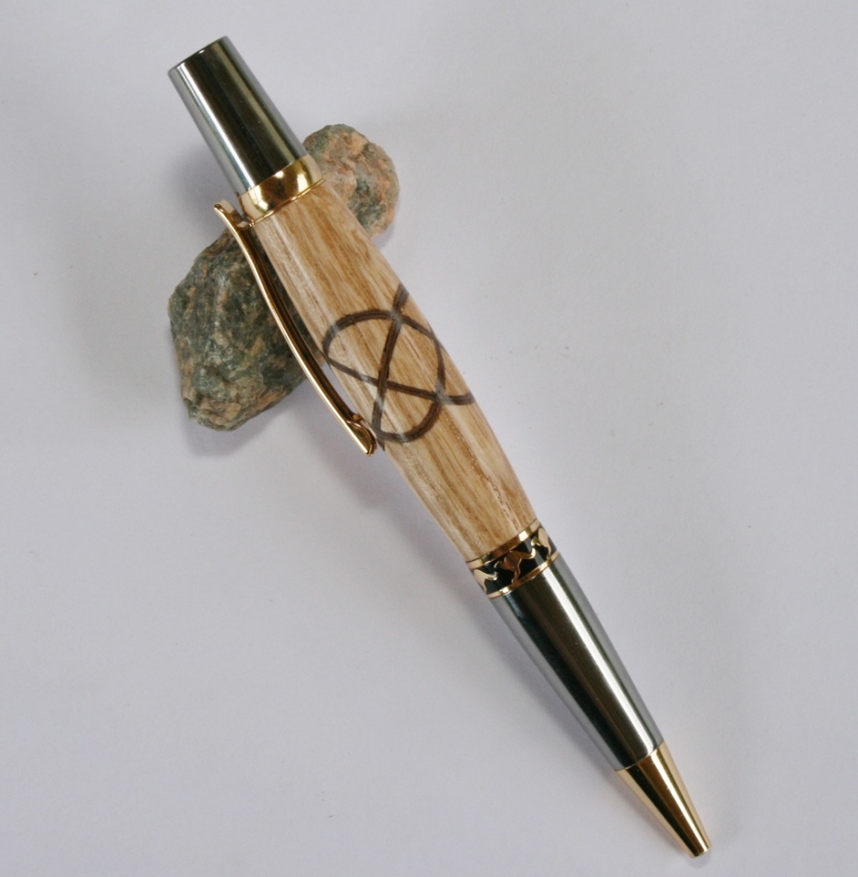

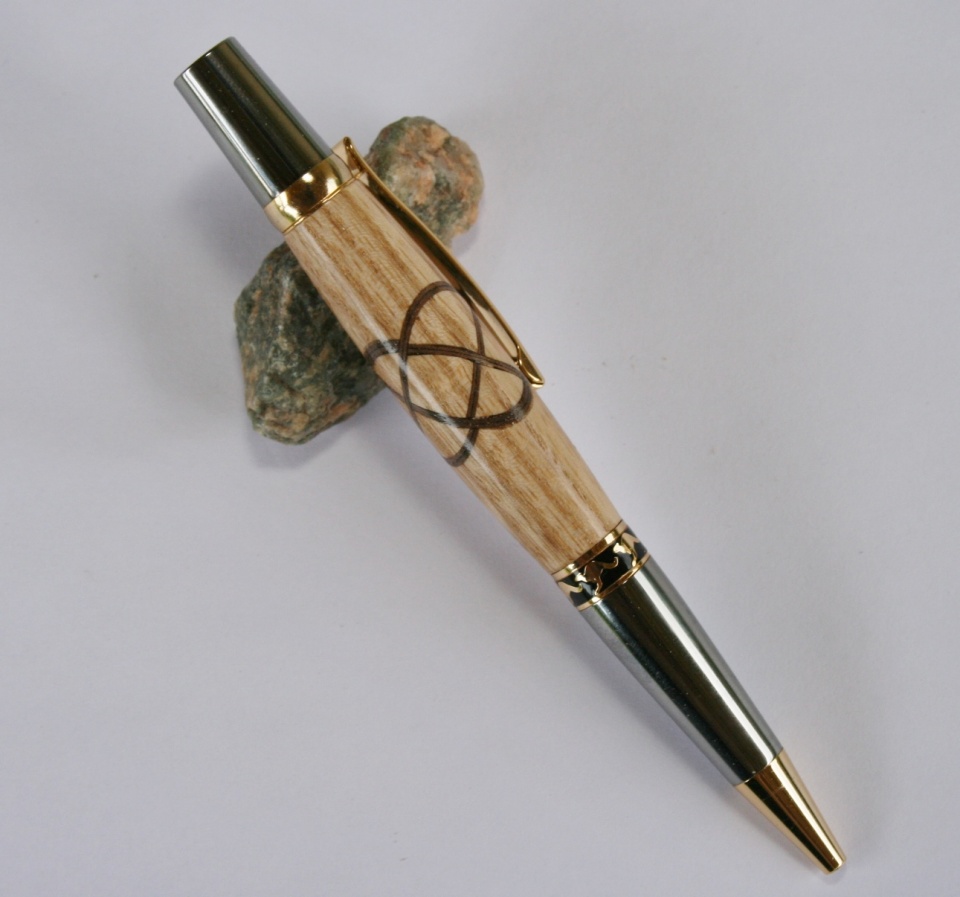

I've been wanting to make a Celtic knot blank, not having a jib for my table saw I was wondering if it could be done with my scroll saw and here it is. I paired it up with a executive sierra kit. All C&C welcome. Thanks for looking.

Thanks Glen and Gary for your comments. I took a 3/4" square blank and drew a 3/4" x 3/4" square on one side, next I marked a diagonal line across the square and cut the blank on that line. I knocked of the rough edge on the right side of the blank (if you try this you'll see what I mean) now with a double thickness of veneer as a filler I glued the blank back together using CA. After the glue sets I sand the excess veneer off. Next I mark another diagonal line on the opposite corner and cut on that like and glue in another double thickness of veneer being sure keep the first layer of veneer aliened. Once the glue has set and the excess veneer has been sanded off repeat the sets on the opposite side of the blank. I hope that gives you somewhat of an idea on how I did it. I'm sure you could do the same think with a band saw.
Sounds good. I use a bandsaw or tablesaw to make knots using the technique of almost cutting through and using inserts that match the kerf. Never tried cutting all the way through to make the knot. Figured I have enough problems as is.

Do you "true" sand after your Scroll Saw Cut?
The second photo upper right insert looks a little wavy, (it might just be the photograph).
Celtic Knots, are filled with difficulties, and can require considerable practice to obtain consistant results.
Because of the contrasting timbers used, they highlight every slight deviation, and misalignment that may occur.
You are well down the path, keep at it.

Thanks Brian for your comment. I did not do any truing sanding I cut made the cuts and glued things up. I just wanted to see how it would work using a scroll saw more of less just playing around.

Dan, considering how you made the knot, I think you did remarkably well.
I'm not sure if you know this but the big cheat with creating perfect knots is to only cut a slot in the blank instead of cutting all the way through.
If you cut, say about 90% way through the blank for each cut, then insert each veneer, then sand down flush with the blank sides again and then do the same for the next three cuts, you will find that you have a perfectly intersecting set of rings.
It makes it even more accurate if the blank is nice and square to start with as it is easier to drill down the middle afterwards. :wink:

Thank you Steven for that great comment. You are right on the money about having a square blank but you should also be sure your blade is at 90 deg. I going to make a jig for my table saw one day.
