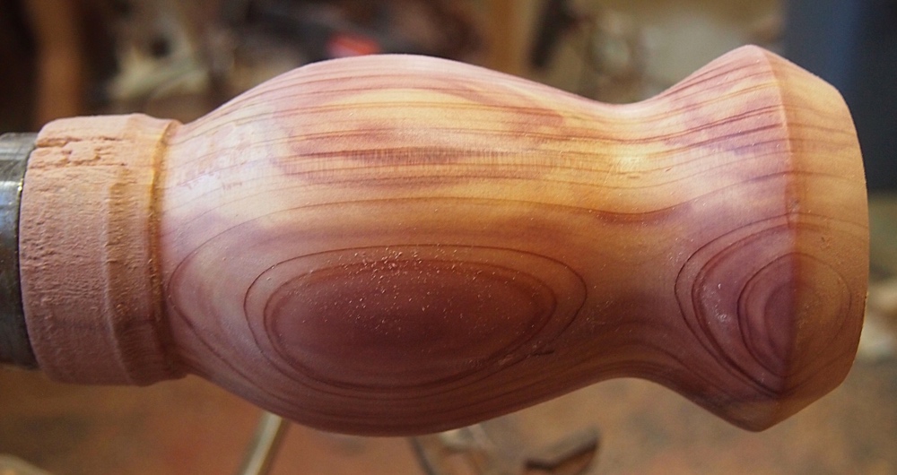

First I turned the outside shape leaving extra material about 5/8" below the rim and hollowed the piece.

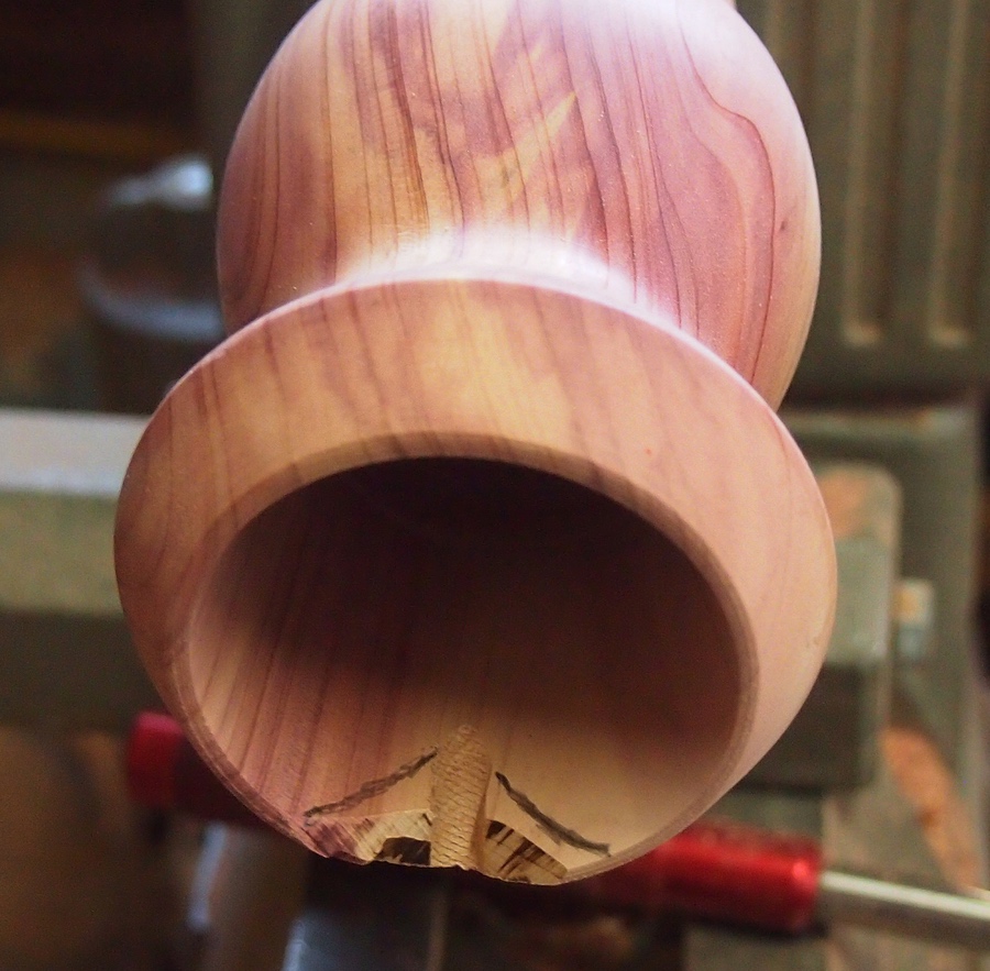

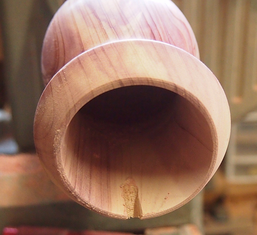

I then used a round rasp to make he center line for the spout. Then I carved the notch.
View in Gallery
View in Gallery

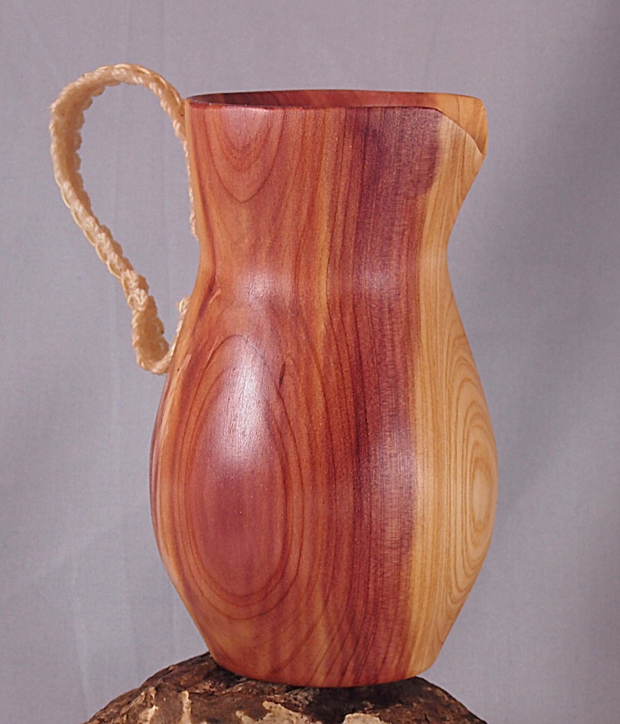

After carving the notch I used my drill and a sanding disk to remove the thicker wood up to the rim leaving the wider area around the spout. Sanded and finished. I then raided my wife's sewing box and stole a piece of trim that I glued to my pitcher. I then stiffened and shaped the trim with CA glue. This was a real learning experience. My next one will be bigger and better, I hope.
