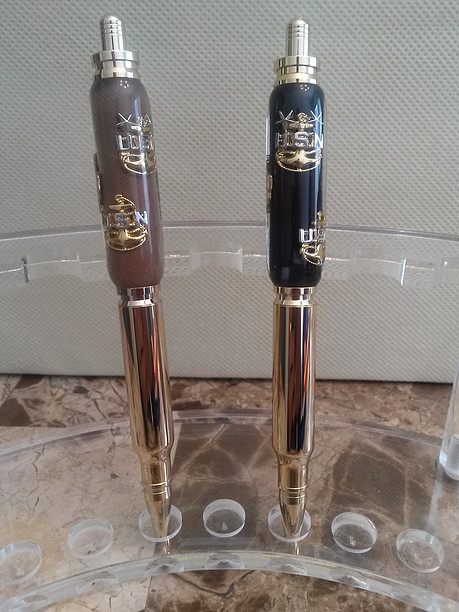

Here's a thought. I have wrapped tubes with actual material. These pens are from Navy Uniforms. I'm sure you could get a "Real Tree" t-shirt and wrap the tube with that. I hade to make these on the fat side because of the anchors underneath, but if you're just wrapping with material, it might look pretty cool!

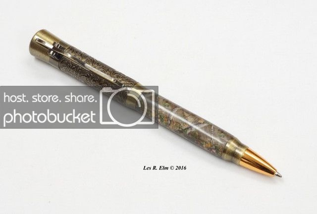

I've used fabric and actual pictures of camo clothing I cut out of catalogs. The only problem with the pictures was they weren't big enough for anything over 8mm tubes. I've also used cupcake papers. I found them at hobby lobby. They make regular and small sizes. I turned them upside down, misted them with water and ironed them flat to glue to tube. I didn't cast over them but instead built a CA finish over them. Casting would prob work as long as you sealed them or CA them first so they don't fall apart in the resin. Here's the bolt action I did with a cupcake wrapper. Good luck!

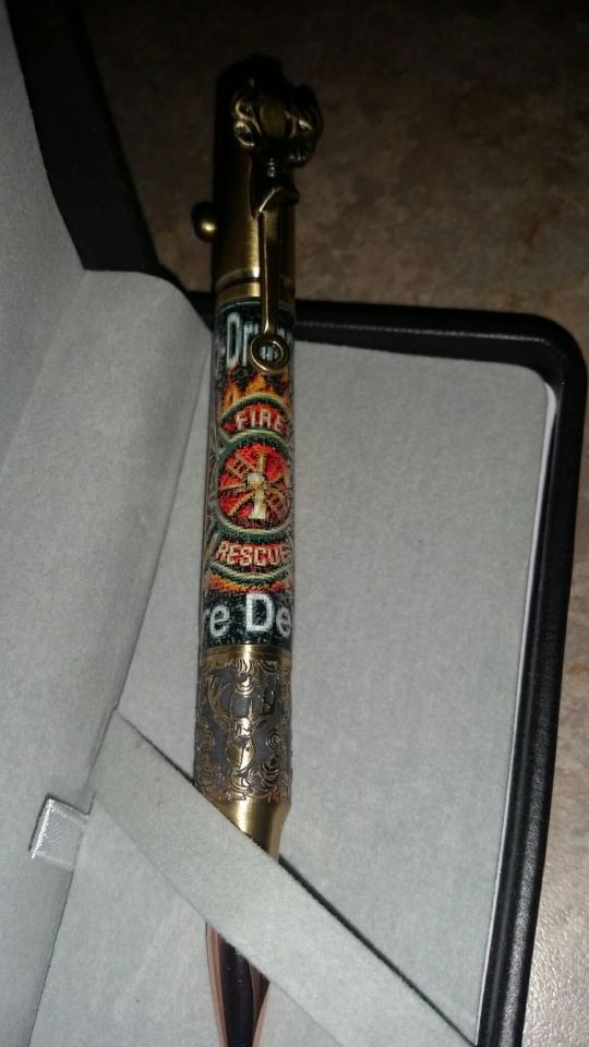

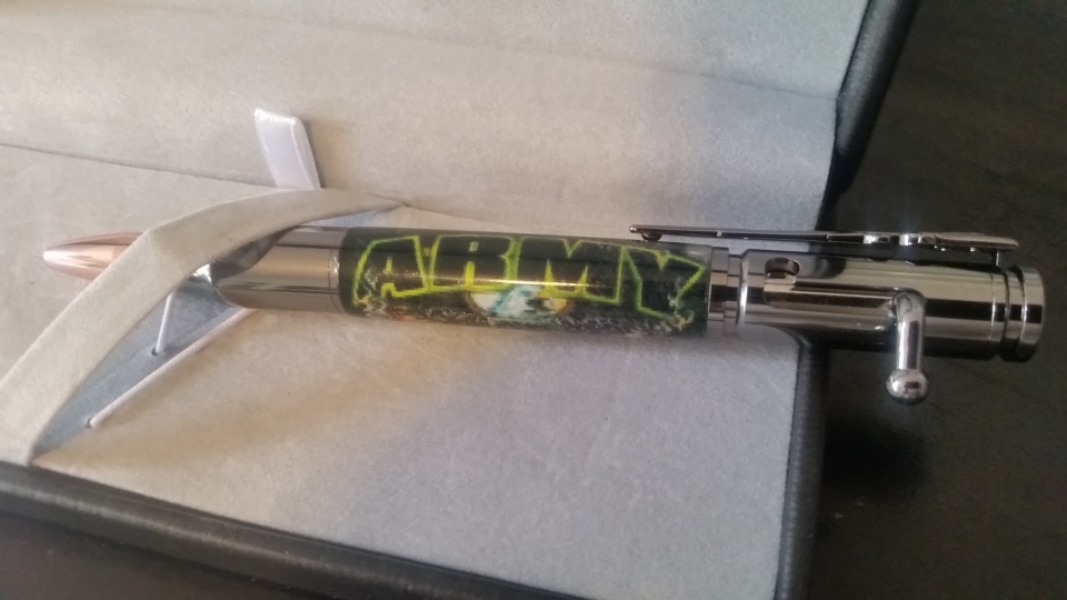

Customizing Decals
I have printed many pics off the internet for my pen decals. I am using inkjet water slide and sometimes they some of the details in the pics come out blurry. I see some of the pics are coming looking good so I am wondering what I am doing wrong. I changed how the decal is printed and it does help sometimes but I think the pics have to much detail to them and this is what is causing this blurry issue on them. Does anyone have an idea on what I doing wrong?
Flush1974
Jan 10, 2013
79
St Petersburg, Florida USA
Pappi,
I do a lot of model aircraft decals from scratch. I've found the laser printer does a phenomenal job of printing decals. I do find issues when printing on white decal paper if you are trying to put a decal on something else. There are some ways around it. As for the question "what if I don't have a laser printer?" Kinkos or Office Depot will hook you up for a nominal fee, just bring your decal paper with you and ensure you buy the laser printer paper.
As a retired Marine I love this. However, I was thinking patches would be slimmer. I have people asking me to make rank/chevron pens from all the services. Been trying to think of how to get it done.
robertkulp
Mar 26, 2014
286
Murfreesboro, TN
For rank and service medal pens, just do a label cast. They're very popular and great sellers.
