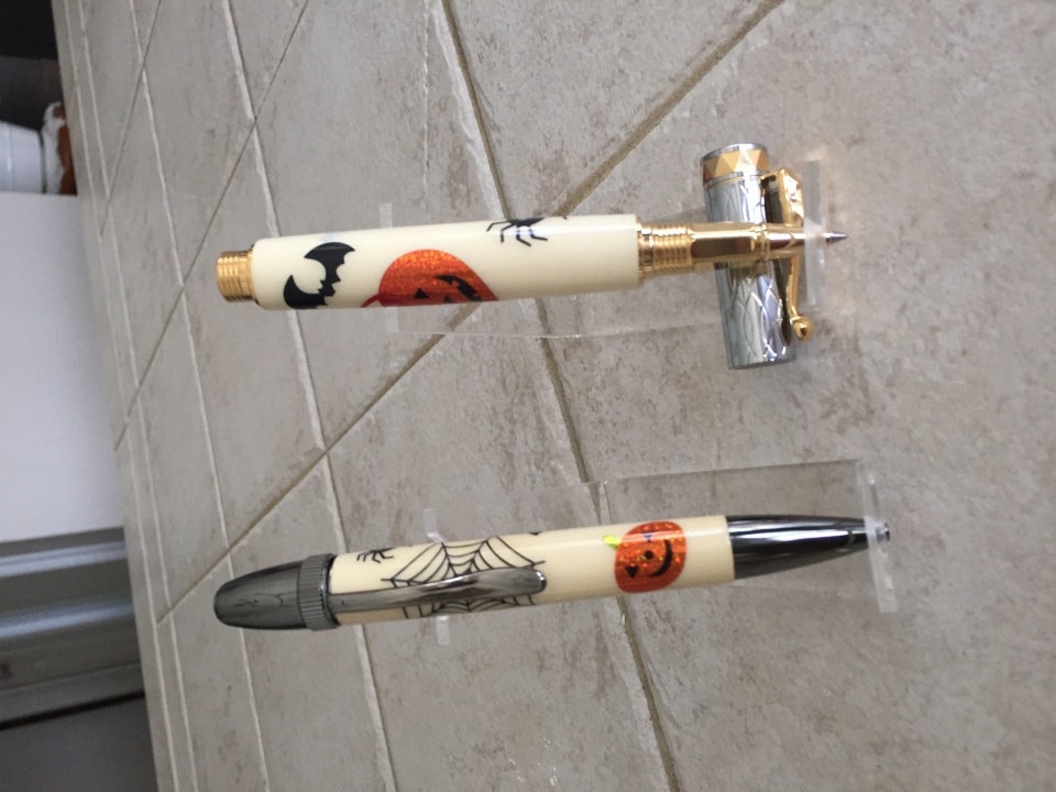

I'm looking at trying some metallic stickers. Has anyone tried casting stickers from Zazzle in Silmar41 resin? I want to experiment with some new designs, but don't want to waste money on a project that someone has already tried and failed.
These were a couple I did at Halloween with metallic zazzle stickers. I didn't cast these, they were applied to a sanded blank and then CA'd to death until I couldn't feel any ridge. I've done several other ones the same way and they turned out fine. Hope this helps...
I agree with Rich. If u use CA, you don't have the worries of a blow out or any reactions or bonding issues between the decal and resin. Just over turn them a little to leave room for the CA buildup. Also, if there are any transparent places on or around the decals, I would recommend a light CA finish all smooth and micro meshed before the decal. If not, your dull finish will be trapped behind the decal and will show in comparison to the rest of the pen when finished. Good luck !
