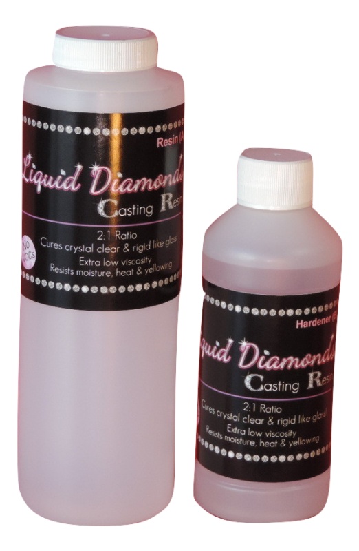

Liquid Diamonds works great without using a pressure pot.

ok, so here's an update.....
I tried Liquid Diamonds and did a couple of Label casts. I haven't had a chance to turn them yet because it's been too cold, but when I held them over a light, I noticed really small bubbles around the tube. I'm hoping they won't be noticeable after turning, or maybe I can fill them in with some CA
