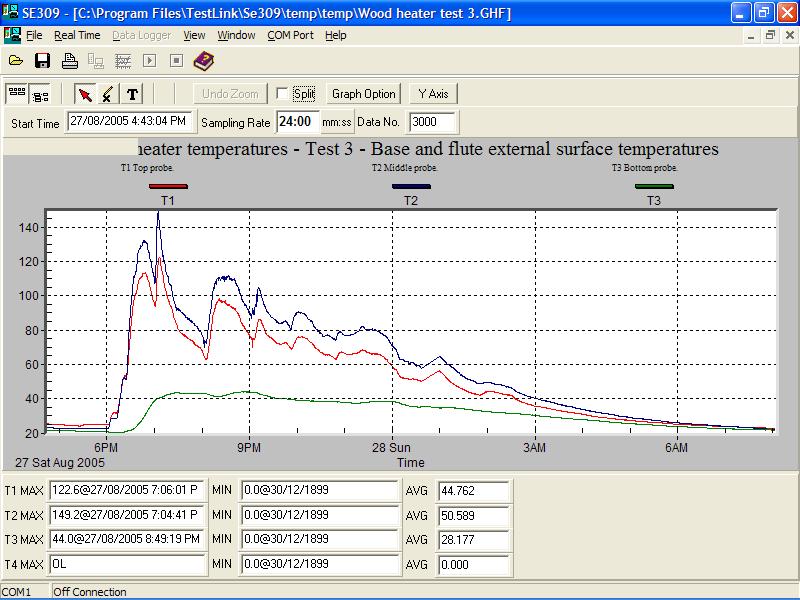

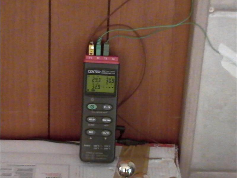

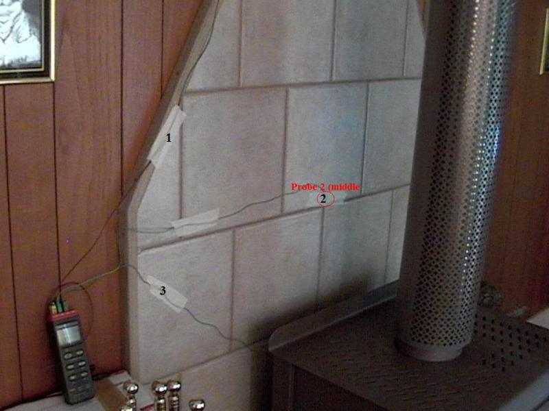

Well, we can all get "fancy" and get the temp gauge that has a stainless steal fine probe that you can insert into the resin and watch every degree going up, most of these instruments have a set alarm that will activate (ring/buzzz) when that set temp is reached, just in case you are not watching...!
Cheers
George
