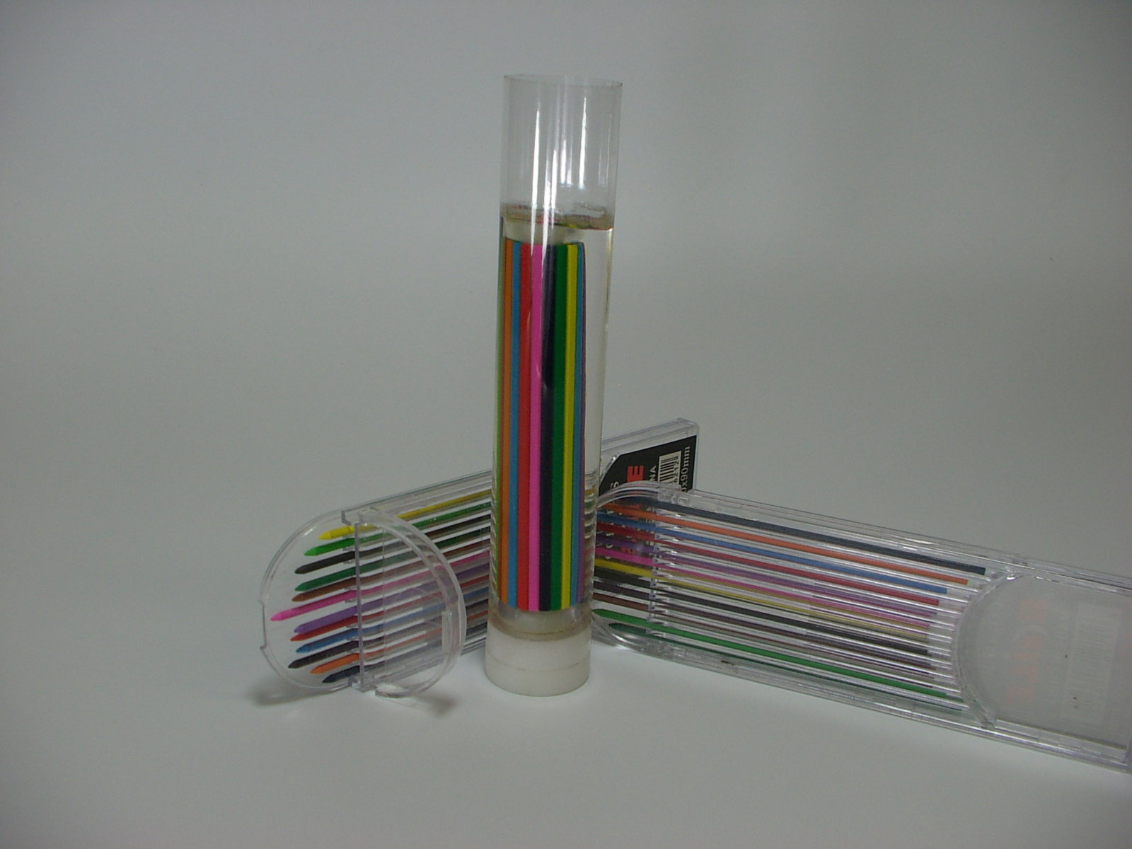

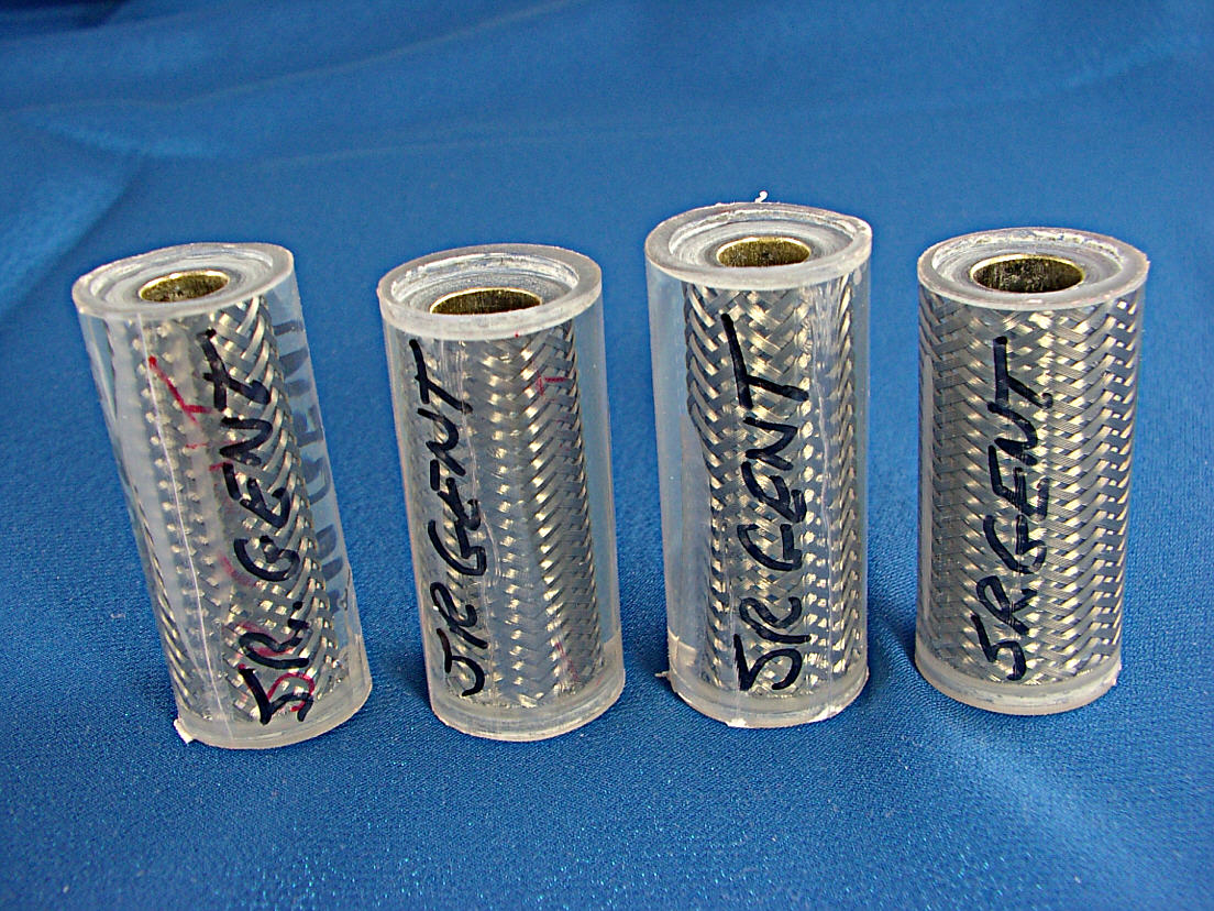

Again I will lay out my procedure. I warm the resin in a toaster oven after it is preheated to 200 to 250. Hard to tell with those things but that is what it is set on. I heat for about 15 minutes. I have my blank set up in the plastic tube with the stoppers in and ready for pouring as soon as I mix the resin. I have done anywhere from one blank to about 12 at one time. Now when I go to a larger amount of blanks I have to increase the time in the heat box because of the extra resin and this is important because when all said and done no bubbles are in the resin at all because of how thin it gets. I then mix about 5 drops of catalyst per ounce and add a few extra. Not critical with Silmar. I mix for 4 minutes. 5 if alot of resin. I then pour the mixed resin in the tubes making sure to pour against the side of the tube. This ellliminates any bubbles developing. If there are any they rise to the top right away. I then place in pressure pot. Here is where I said it is important to not (NOT) add pressure real fast. You want to slowly build up pressure because for one you run the risk of adding water dropplets if you do not have a water filter on the pot. Water in resin is not good. I build to 50lbs and leave 24 hours. I usually have some resin left over and leave it in the cup and I can tell the next day if it has cured. My pot seals well and does not lose pressure.
Now with my method the plastic tube stays on the blank and is turned off when turned down. There is no need for release which can cause havoc with poly resins. Now cracks can come from the resin being too old or the catalyst. There is a shelf life and it is extended if kept in a cool dark place though. I have used 2 year old resin with no problems. Another reason for cracking is air escaping from under the object that is adhered to the pen tube. Things such as carbon fiber or other sleeves. Even labels will emit air from under. The objects being cast need to be cleaned from oils or other contaminates that will interact with the resin. I learned this with my casting of the different braided materials I use. That is why I have mentioned before why I adhere my braiding with the same resin and put a light coat on it before I cast them. This seals any byproducts. Other than that that is all I can say. I have included a photo or two.
